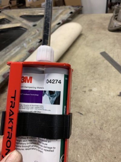

Before I join these two pieces and weld them to the deck lid, I want to pour some rust converter into the deck lid, let it dry, and then use a wand to spray Rustoleum rust reformer into the deck. I decided NOT to use any undercoating or stuff that might trap moisture. I will also add a couple of dabs of 3M NVH Dampening Material 04274 where I can reach. Once the back panel is welded back onto the deck lid, I lose the little access I have to the inner lid.
