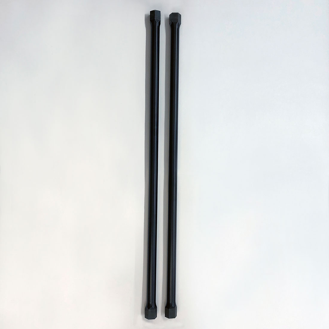

Torsion Bars back in stock for B/E bodies. Modern 1.14" diameter, USA made. High quality black powder coat. Comes with Mopar style rubber boots and clips.
