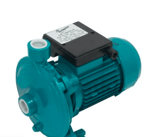

I ran the pressure pump (that pumps irrigation water from an underground cistern to the plants in the yard) dry for the second time the other day. The first time, no ill effect. This time, a small little spray of water coming off the shaft. Must be the seal. Is this something a do-it-yourself guy can repair at home? It must be either 1/2 or 1/3 horsepower. Thank you.

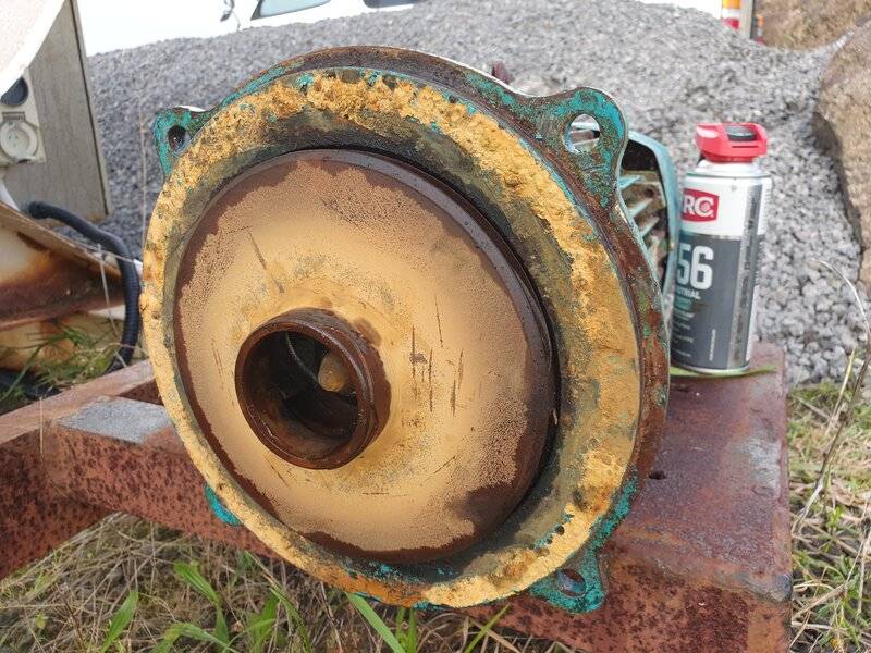

Depends on the skills of the DIYer.. Unbolt the housing, it'll probably have calcium deposits so it'll take a little "persuasion" Then remove the impeller & key... Then the back plate which should give you access to the seal..

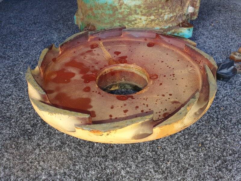

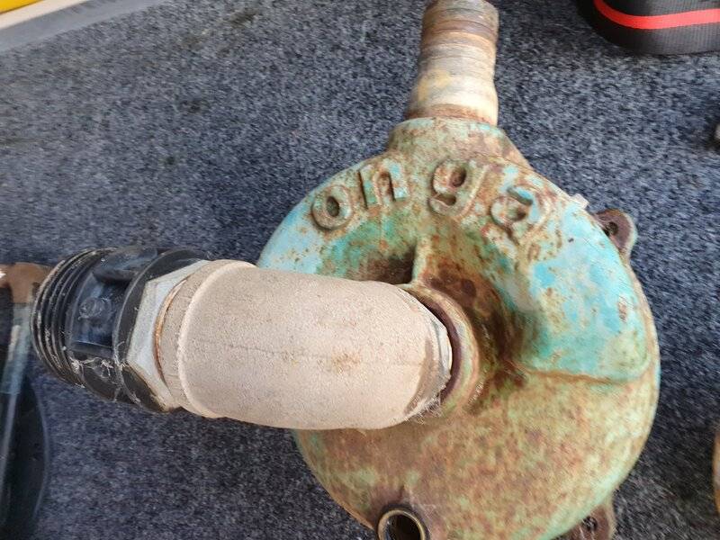

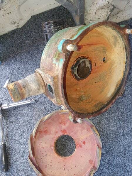

Funny this should come up....I just replaced a pump set 2 days ago at work. The poor old pump housing was corroded bad from the salt air environment....seal leaking, seepage into motor, impeller had broken....way easier to unbolt the old and install new. Changed a hose clamp as well as the guys had been pulling on the hose too hard.
All the pipe fittings had corroded beyond easy removal.
