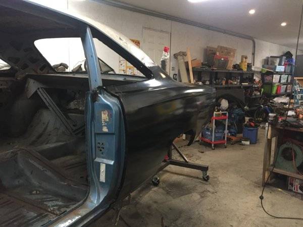

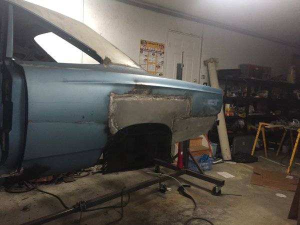

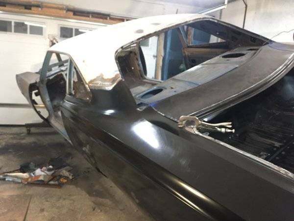

So I’m attacking 1/4 replacement. First fit up. Do you guys still lead things? I’ve been told by more then one body guy to stitch weld grind and stitch again to build thickness and strength. Grind clean flat and the filler it.
Before & fit up pics.
I’m interested in opinions.

replacing a quarter on a rotisserie is not a good idea. The car should be supported at the 4 torque box areas and have the doors on, to align to
Ok. I was thinking that it probably wasn’t the best situation. I’m hanging the door for sure. I’m thinking I’ll lower it on 4 jack stands and support it closer to the center of the car.
Thanks.
it being a post car, and the door jamb not being disturbed keeps it much stiffer than a hardtop
I also left the trunk gutter in place but, I’m still going to drop it on something more level and evenly supported. I’m still early in the replacement phase(fit up & clean up).
Thanks.
