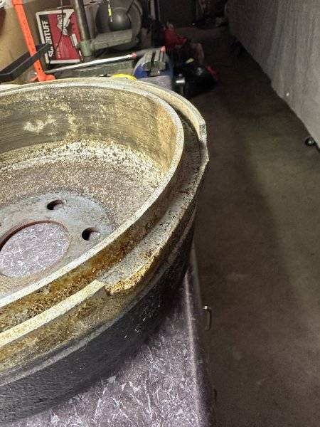

11” Drum Damaged- Useable?
dspur
2:50 AM
Mar 28, 2021
646
524
Albertville, AL
This evidently has been on car and used with no issues for quite some time, but a bit of the outer ring is missing, probably hit at one time. Assuming all else is good, any issues in continuing to use this? Does not seem to affect anything I can think of.
On another note, I had forgotten just how huge these 11x3’s are….
.......... Assuming all else is good, any issues in continuing to use this?...........
I believe that outer ring helps keep out the elements. A chunk that size surely will cause imbalance.
FWIW, many recent replacement drums for the 10" X 1-3/4" A body 8-3/4" don't have the outer ring at all.....
