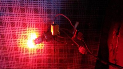

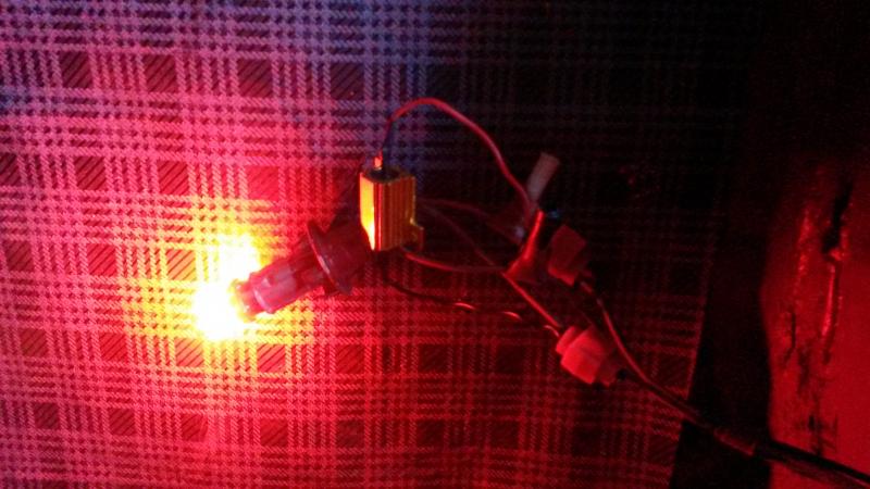

Scratch the flasher don't need it. Load resistor for each light. Not to bad to install
Installed LED in tail lights and also installed a no load flasher with ground. Nothing worked, no lights, no directionals.
What did I do wrong. 63 Dodge if that matters
