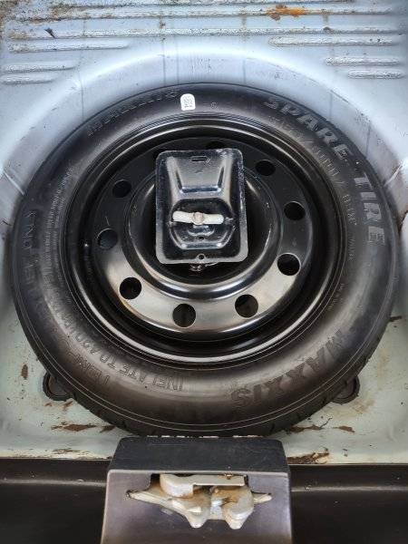

I run 17 inch aluminum wheels on my car with overall tire diameter of 27 inches. I found a temporary spare from a Ford Edge that fits the spare tire well nicely, and allows a flat floor. It is on a 17 inch rim and measures 27 inches tall. I just had to enlarge the center register slightly to fit over the Chrysler axle diameter.
