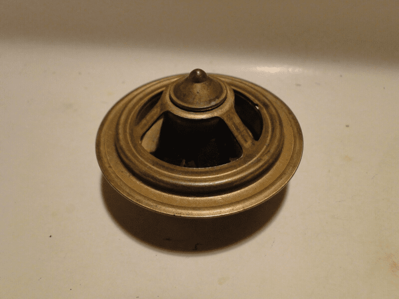

My never-disassembled 69 383 4bbl ran hot years ago, mostly due to the radiator and block being somewhat fouled with Barr's Leak by the first owner. In my quest for running AC on a 100* day, I found a factory thermostat from 1967, part# 2128994. It's in the brass on the side. It looks like the Stewart/EMP/Robetshaw thermostat. I measured the diameter of the opening - 1 7/16", vs the diameter on the opening on a Stant "Superstat" - 1 1/8". Guess which one fixed my cooling issues? Flow is everything. The other thing I usually tell folks is your temp gauge does not show the coolant temp leaving the radiator, only exiting the head. It is difficult to gauge how well the radiator is working year 'round without another thermometer sometimes. Rule of thumb - the radiator is dirtier than you think. This can be true after a "weak" flushing on a heavily fouled radiator.
