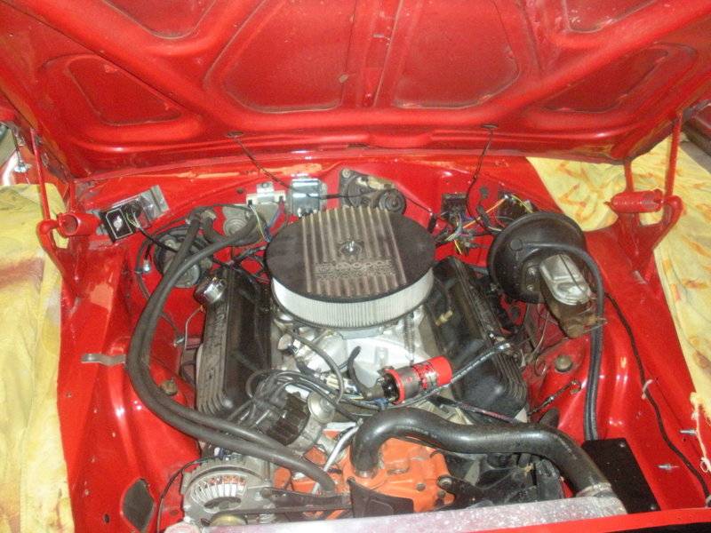

18 years ago today I got the Charger. Today it left me stranded!

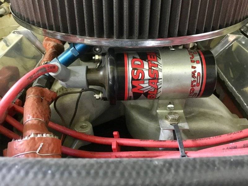

I blame MSD...sort of.
Their instructions do list that the coil is to be mounted vertically and I had it horizontal...for several years before it failed.

Something I read way back about oil-filled/epoxy about orientation??? Sorry about problem tho. Even if no one’s around, it’s embarrasing; hate that crap!
I'd have to modify a bracket to mount one vertically. I think they look better horizontally anyway.
I got the black one, supposed to withstand vibration better.
Weren't the stock ones oil filled when they came from the factory? Beside leakage, I don't see why it would matter which way the coils mounted. Maybe I'm missing something?
They claim the oil settles due to gravity...I thought it was gel filled. Maybe if they sealed them better it wouldn't be a problem.
The MSD lives an unsheltered life. Coil always has been mounted this way.
That coil looks nice and dry. Mine was seeping "oil" or whatever is inside the Blaster 2 units.
This is way too much info, but here it is. Looking at the Holley site, the Accel Super Stock canister style is epoxy-filled and is the only one Accel states can be mounted in any position. Likewise, MSD states their High Vibration Blaster (epoxy) can be mounted in any position. The Mallory Promaster and Accel Super Coil are oil-filled and have mounting brackets that place them upright. I assume that mounting some, maybe not all, oil-filled coils sideways or upside down allows the inner windings to not be covered in oil, thus allowing them to get hotter and possibly fail sooner. Dunno, just a thought. I'd say if possible, follow the manufacturers recommendations.
