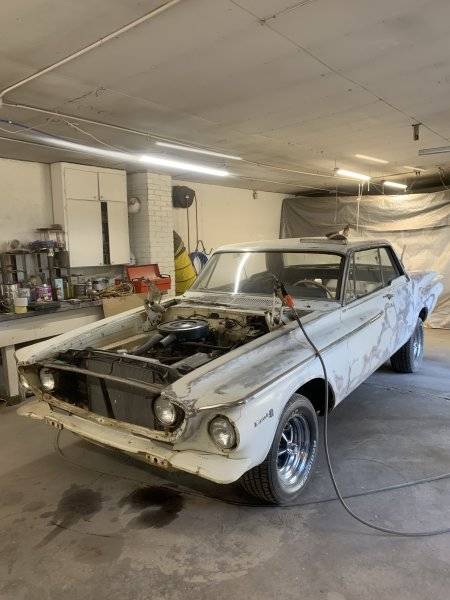

Sorry for the dumb question, searched but could not locate the needed information…how does this molding on the 62 Dart front fender a door come of?
On each end there should be a nut on the inside of the fender and door. The rest of the clips in-between should be the push in clips.
Hope it doesn't have 2" of undercoat above the headlights like mine does.
Thank you..it has a ton of factory under coating. Very helpful!
