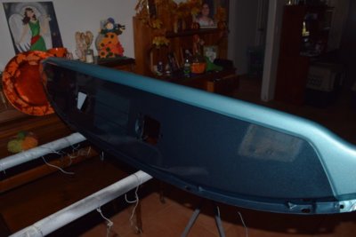

Also here is the dash I restored with what I believe is medium and dark turquoise. I had the original matched at the local auto paint store.
... View attachment 933888

I have not tried a PPG jobber but your gonna find that virtually no one has the color code for the turquoises anymore. They will have to try to match it from the paint chips that most places have so it won't matter what you call it you will have to point to it in a book and see how good the guy behind the counter is at matching. I had the original colors on the dash so he scanned them with mixed results. If you want either of these two colors I can tell you who to call to get Automotive Arts Motobase (excellent paint). They actually got the factory (AA) to dig through the archives and found the dark formula but the medium Chad sent a number of samples and we got it very very close.
