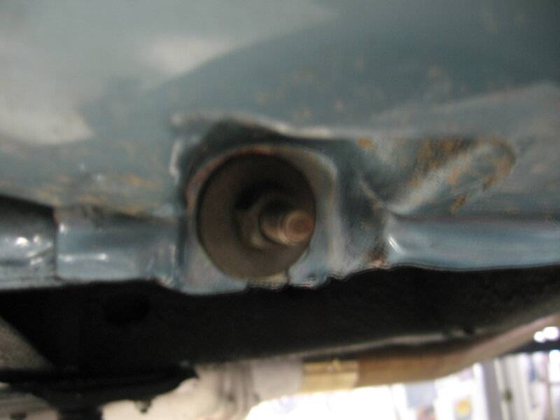

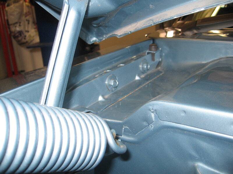

Hi fellas,
It's been almost 11 years since disassembly and I've lost many brain cells in that time so, are there 2 studs used during each fender installation? I bagged up 2 per fender with 2 large washers (captive) on 5/16" nuts. I know one installs bottom rear into a large U-nut. Where should the other one install?
Also having some trouble with 2-5/16 X 1 1/2" cap screws with large captive washers?
I would appreciate any help! Thanks!
Mike
Mike, won't get to it till tomorrow but I will look on mine as it is in storage.
Ok, Looks like the bolts with the large washers are top of the fender near the cowl.
The studs are the bottom of the fenders and inside corner near rad support.
Small washer bolts along top of the fender.
