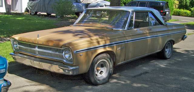

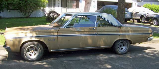

Today was a good day. We got the Belvedere to fire up after changing out the plugs, wires, points, condensor, cap and rotor. It runs pretty rough, but after sitting for 24 years I'm pretty happy it runs at all. Also got a ralley wheel from my neighbor on that actually holds air. 1 down 3 to go.
Got tires and wheels.
I found some tires and wheels for the car so I can at least roll it around. E/T IV mags with brand new 245/60/14's from CL (still had stickers on the tires). I figured for $300 I can always sell them later. Also got the worst of the crap out of the trunk and inside. Also titled and new collector plates so once I have brakes, I'm rollin' :headbang:

I'm not really sure yet. I want to put a 440 in it and I plan to keep the gold/white color combo. I'm not sure about the interior. It has the most expensive combo to replace so I might go to black or go to a two tone. I want to go with 8.5 rear cop wheels and put the biggest tires I can without changing it. Other than that, we'll see.

Yeah, the blue Nova is my sons original SS project. It's in about the same shape as my Belvedere. You can also see his (my money) 63 Nova drag car and my 56 Chevy 2 dr. post project under the covers. I hope to sell the 56 soon to help pay for part for the Belvedere.
