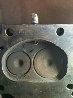

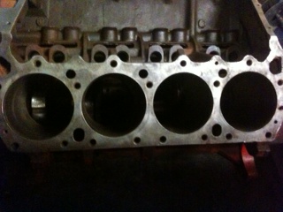

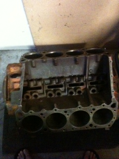

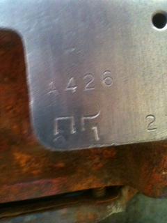

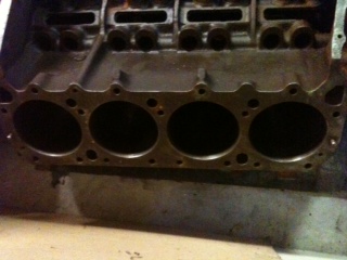

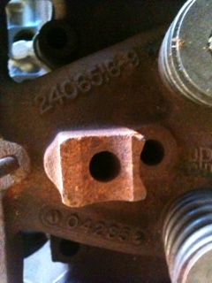

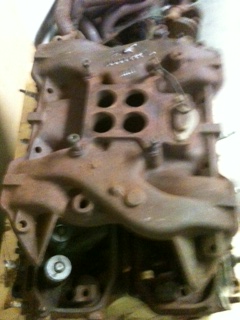

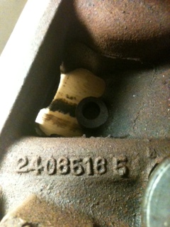

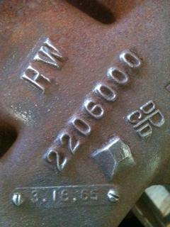

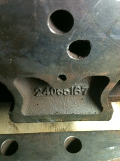

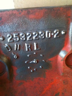

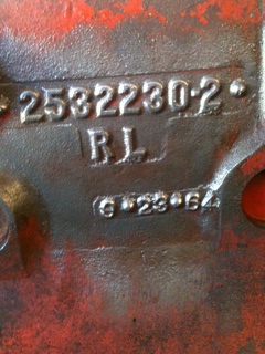

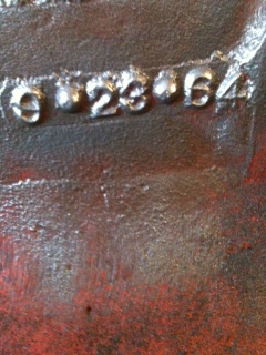

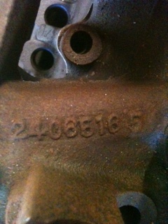

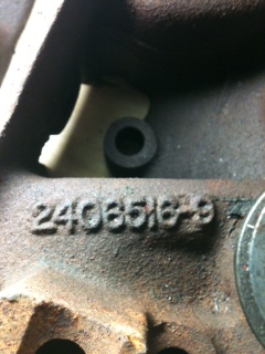

Seems like you have the same 426 block casting as mine and dated 2 days after mine. Mine is dated 9-23-64 and my head casting numbers end in 516, if it ends in 518 then they are max wedge heads, thus the 2/ 4bbl crossram intake. Please post pics of your block, head and your intake casting #'s if you don't mind. Here are mine.
Here this might help some too Mopar Max Wedge Cylinder Heads Guide.
