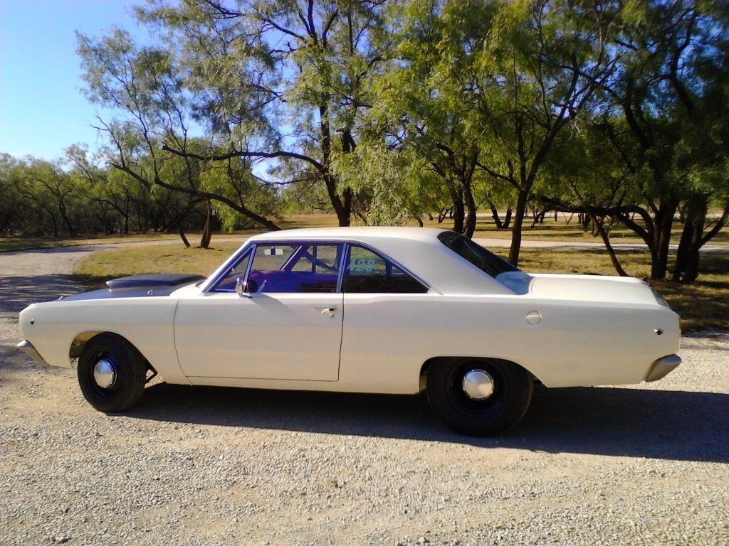

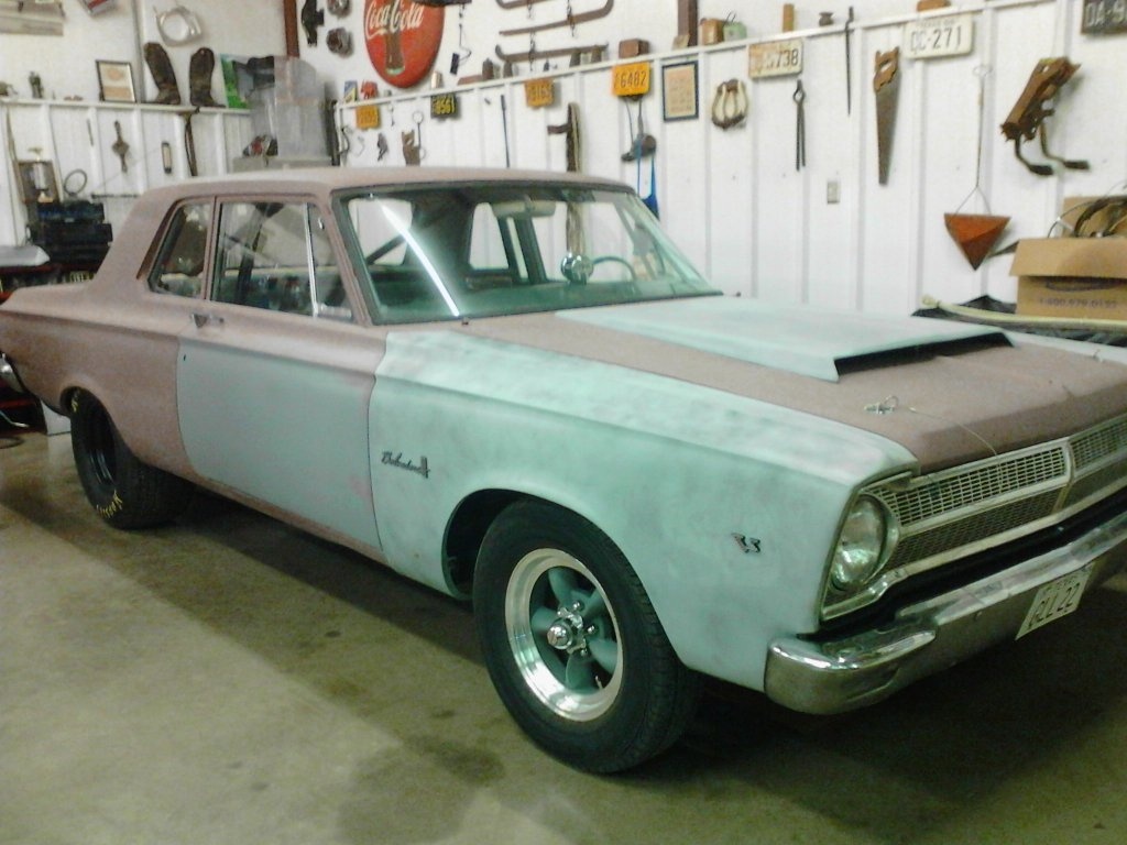

I'm running a 325-50 x 15 on my 65'. Used the Specialty steel wheels. 15x10 with 5½" BS. Mini tub and spring relocation.
I told you a lie! The 325/50-15's are on my 68' Dart. My 65' has Hoosier 295/60-15's. I needed a little taller tire than the MT 325's for the Belvedere. Both wheels are 5½" BS. The wheel/tire combo is tight on the Dart. I could use a 2"-3" wider tire on the Bel without rubbing.
Not very good pictures but it's all I have on this tablet right now.
