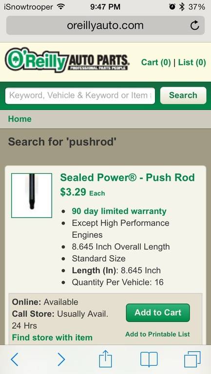

Looking for length of stock 1966 361 pushrod. May have bent mine and need to confirm length of ordered replacement from local parts store...
Lay the suspect pushups on a flat surface and roll it. If its bent it will be obvious. Should be the same length as any b engine. 383 400 361.
One thing that may mess with you on that 361 is you will notice the end of the push rod has a stepped down diameter. This is the old style push rod design, so as long as you get that style with the same length you will be OK. From the pic above it seems they are available.
