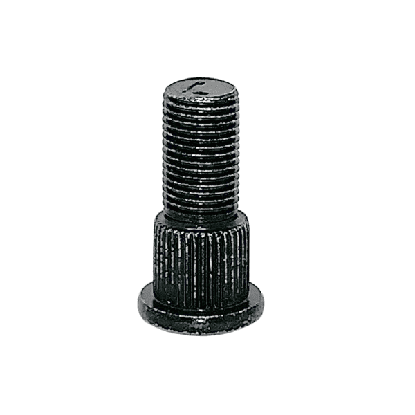

Yep- should have LH nuts on the driver's side.
The studs should have an "L" stamped in the center.
Some 4x4 stores stock LH nuts.
There is a high probability, however that a previous owner could have converted them to RH.
Look for the "L"...and check several studs if there's not one on the first one you check.
I've seen partial conversions and one wheel only conversions.
Those are usually good for at least one broken stud before it gets figured out.
