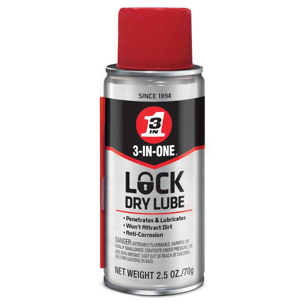

The clock on this 66 Charger is keeping fairly accurate time and rewinds every two minutes -- vs. 30 seconds. I took it to a clock shop for oiling tips and the shop owner said the #1 mistake was to spray WD-40 over the whole mechanism or to over oil the mechanism. He said only oil pivot points and don't allow oil to contact gear teeth surfaces.
Correct. WD-40 never except to loosen bolts or similar, not a true lubricant. It actually attracts dirt etc and can cause more harm than good. I use a 3 in 1 spray and carefully hit the spots (or use a brush) in all my clocks. Whale oil was the best, but good luck finding that.
