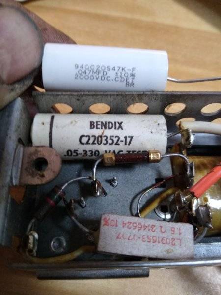

Getting ready to swap out my capacitor since it's original.
This is the one I found people talking about online, seem like the right one?
Pic
The capacity is close enough, but the replacement is a DC capacitor, and possibly electrolytic. If it has a "+" end, connect it to the power side, and the other to ground. The line on the original capacitor just denotes the anode side. You should not have a problem finding the exact original. I replaced all of the capacitors for an old radio from the '40s for a friend and found the correct ones.
It should just be a filter capacitor, so what you have is close, just observe any polarity if noted on the replacement capacitor.
I do not see any marked denoting positive or neg on the new one, how can I tell?
An AC capacitor will have a band at one end, an electrolytic capacitor will have a "+" by one terminal, If the capacitor has neither, then it doesn't matter which way it is hooked up. If you were to post a pic of the cap, it would be a better way to id it.
I assume you are using the one in the first pic. Hook it up any way, and the spec sheet indicated that you should be good with the voltage and current.
Yes, it's the one in the first pic, thanks
