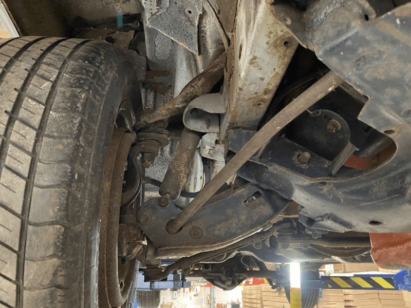

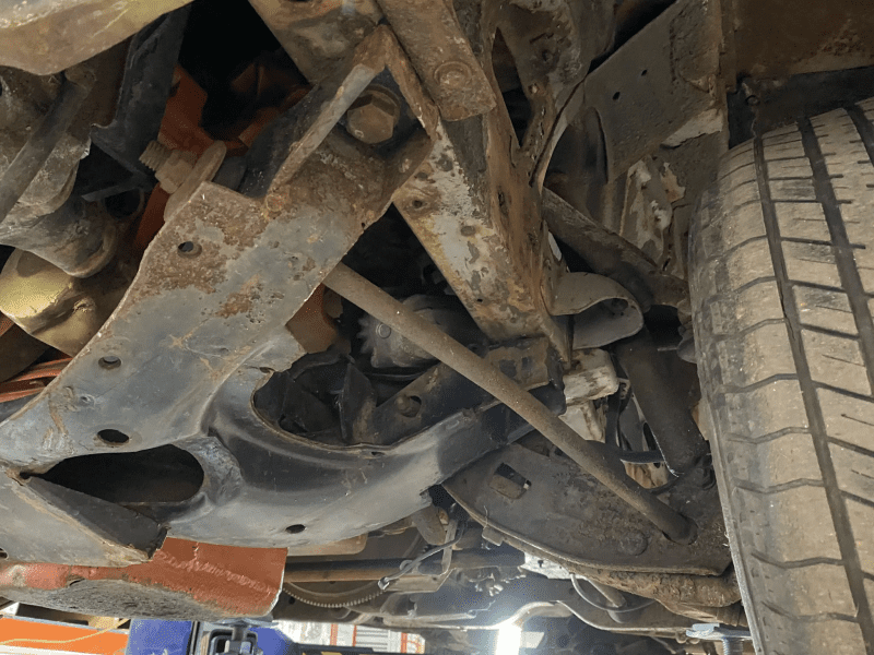

Would be interesting to know if there are mounts for sway bar linkage on lower control arms. If mounts are on LCA's sway bar probably removed.
I would think it might have the earlier strut rod clamp style swaybar. Being an earlier car

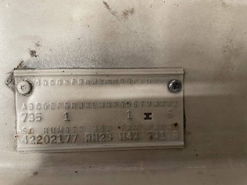

Not home so can't look. Didn't note any sway bar mount holes and no tabs on lca. All HP2's were built b4 Christmas "65
My date was 7/20/66 with sway bar.
Correct, just looked at mine. No brackets on lca the s-bar connects to strut with clamp and the front connection looks like the rod on latter lca

I just found it after I asked, lol. Mine was built March 7, 1966. I'm wondering if mine would have had one like yours or the more std type.

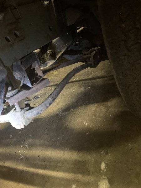

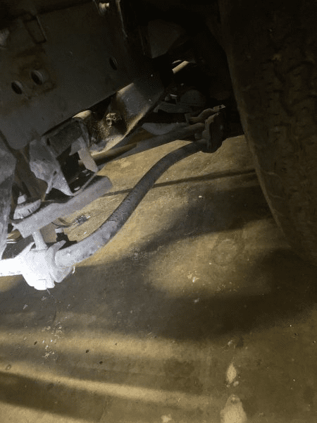

I've seen pictures of the early style sway bar set up & maybe some made their way on the early 66's. That type of sway bar mounts to the K-frame underneath the front mounting bolt. This means that there there would be additional bolt holes in the K-frame, which ARE present in the '66 pictures.
'66
'66
Early sway bar mount ......
