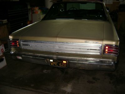

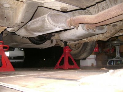

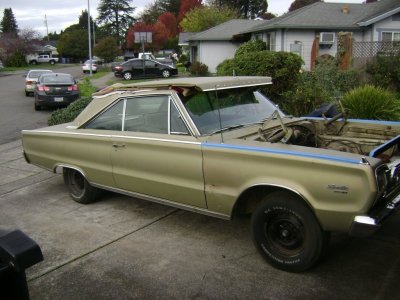

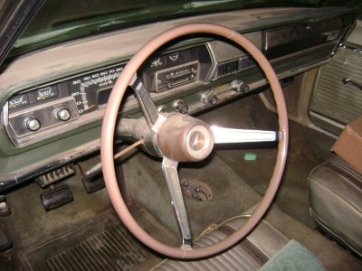

Here is a project my neighbor picked up. The plan is just clean it up and go through the drivetrain first.

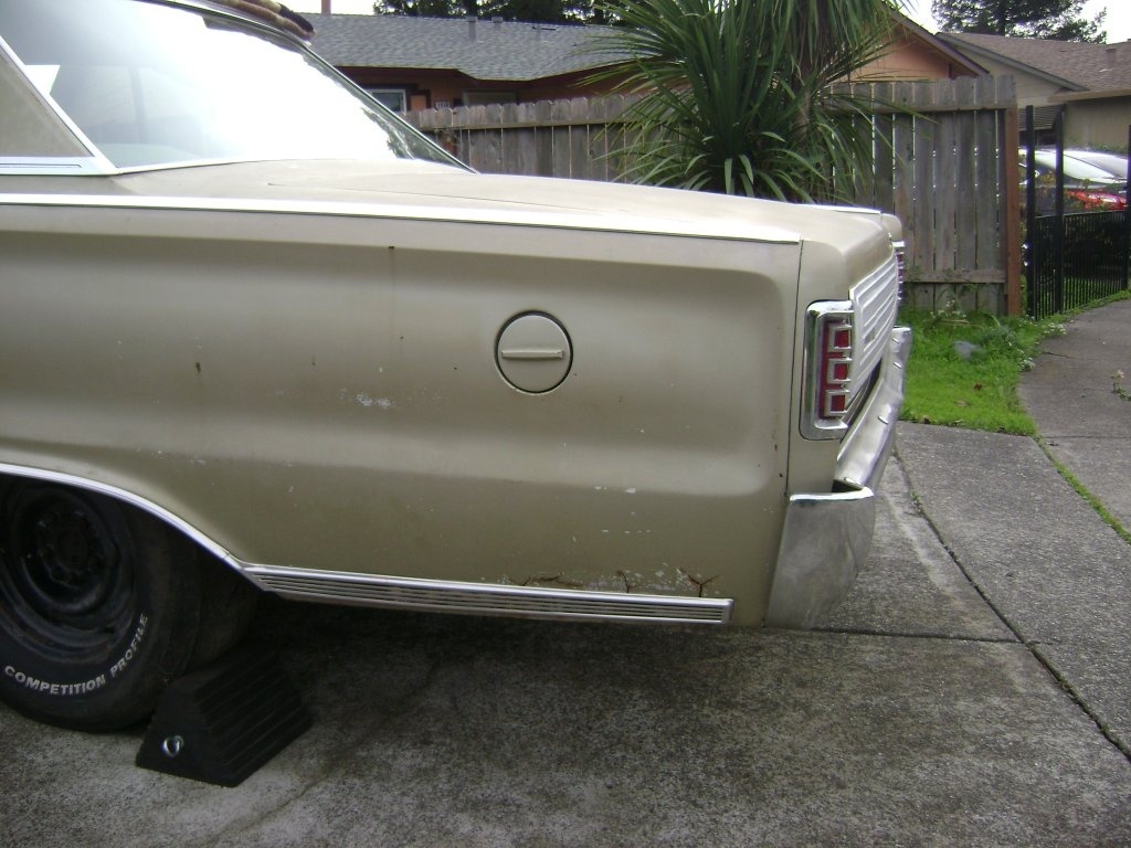

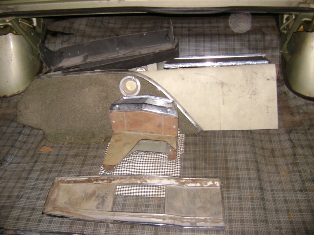

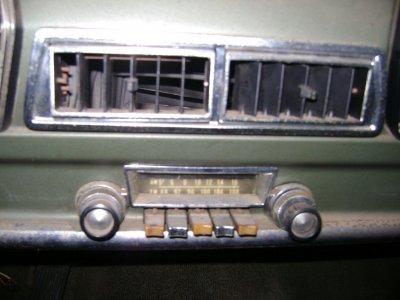

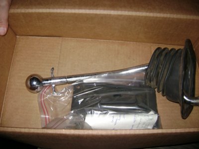

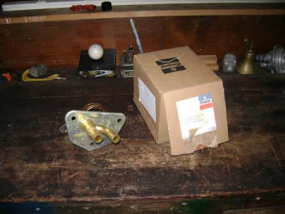

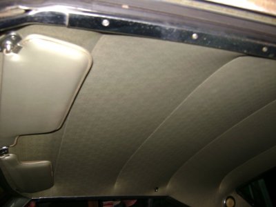

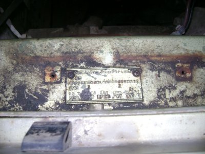

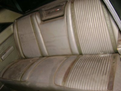

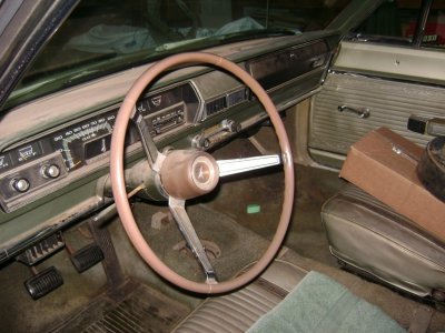

This thing is kinda like a time capsule. Very minimal rust. It was supposedly parked for a bad clutch about 1983. Motor is stuck, but we'll have it out this weekend and see whats up. They say nobody rebuilds 383's anymore but owner says that's what he wants. AM/FM and touch up paint too boot.
DSC03584.JPG DSC03585.JPG DSC03586.JPG DSC03595.JPG DSC03596.JPG DSC03604.JPG
Welcome to the site! And I have no problem rebuilding a 383.....
Very cool. AM / FM radio is pretty rare.
383s are very under rated. If you need a crank, they make great stroker motors with that 4 1/4 inch bore. Easy to get 440+ cubic inches.
383? Hell I would take it. All Ma Mopar engines (of that area) ARE GREAT !!
A '3 pedal' factory A/C car...with wood grain steering wheel? Nice find.

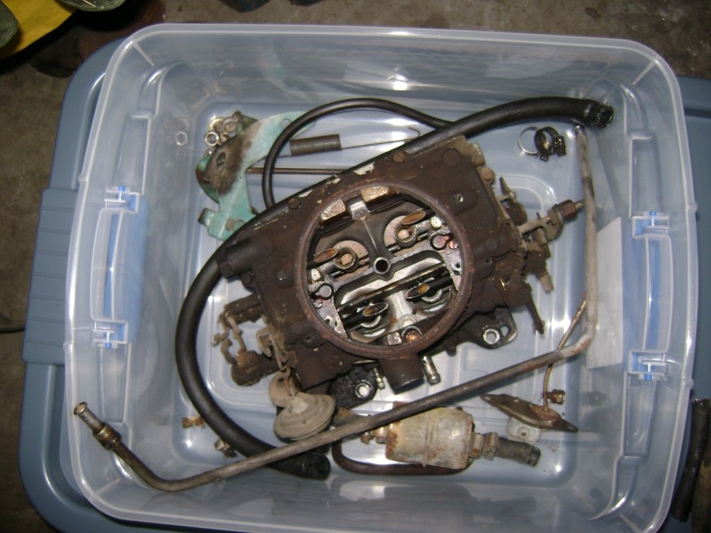

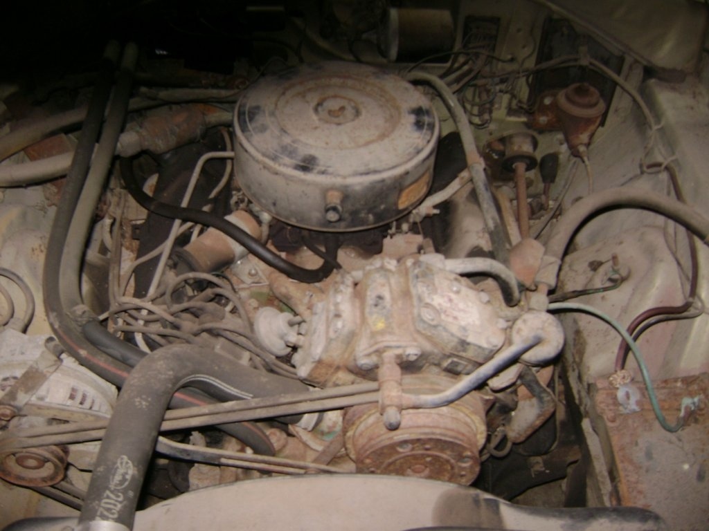

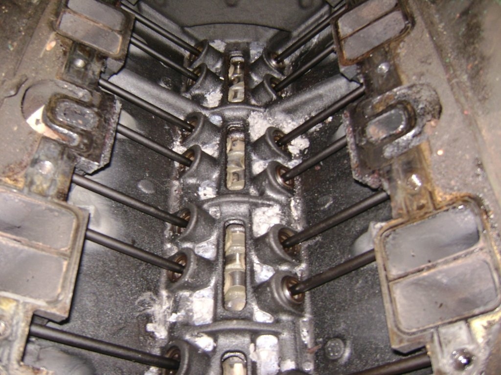

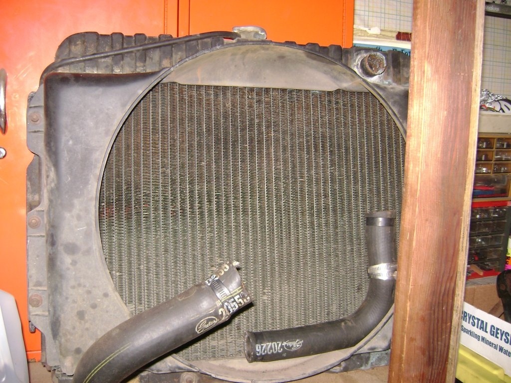

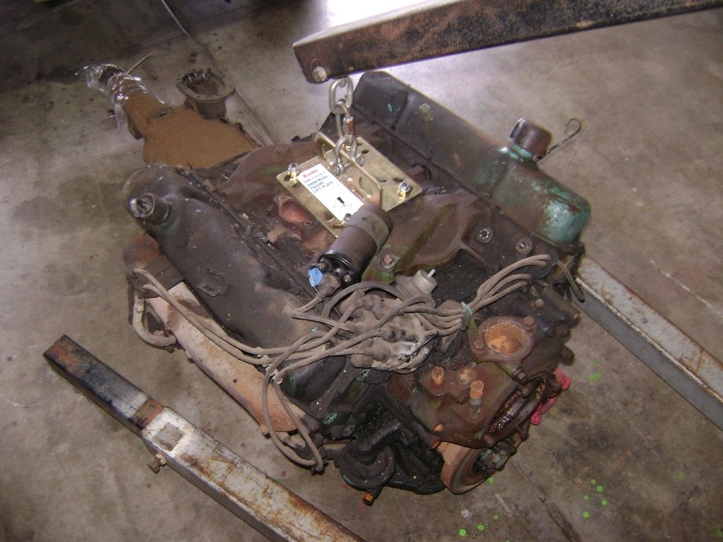

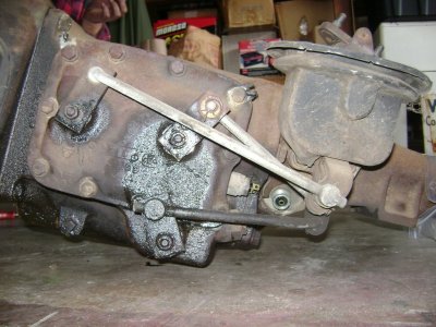

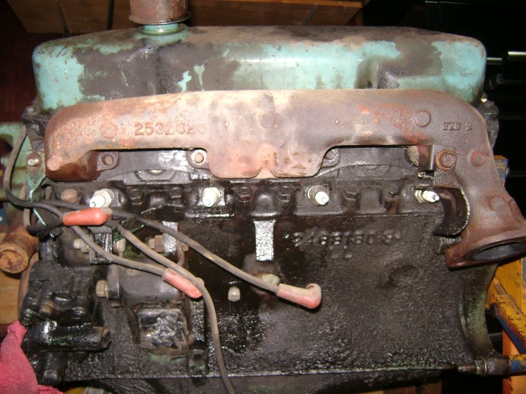

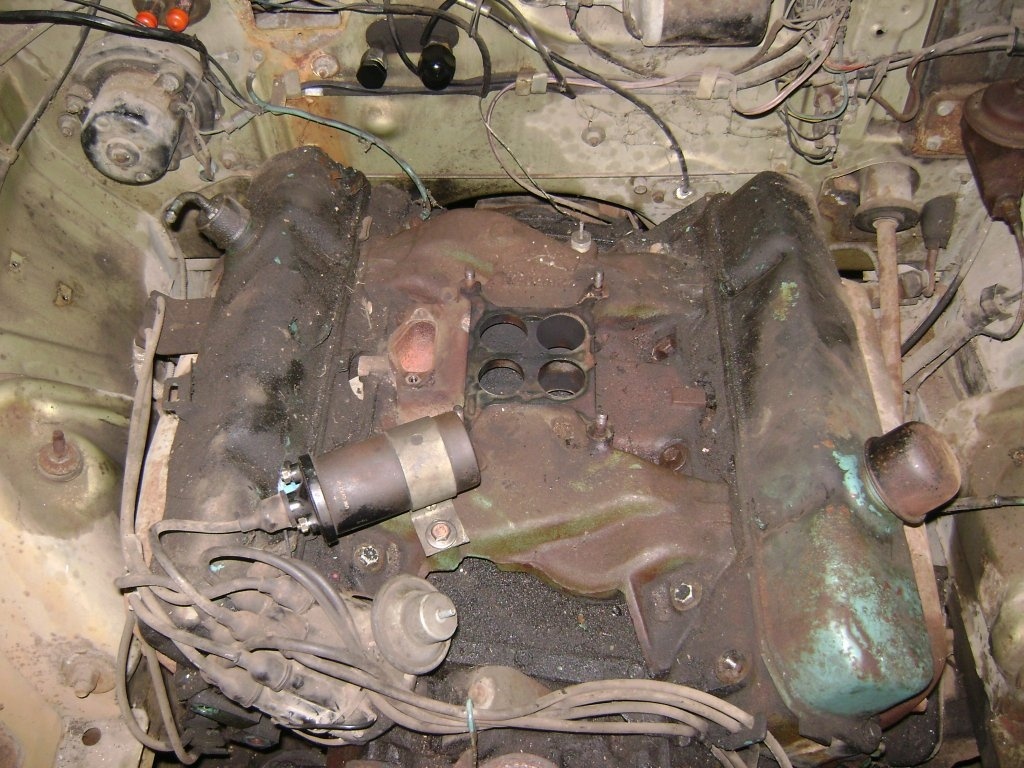

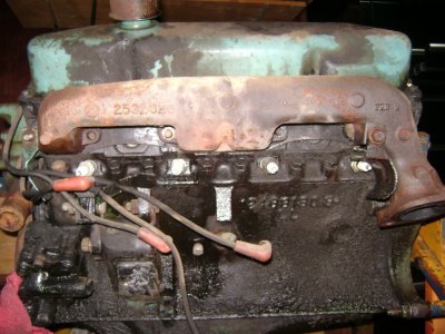

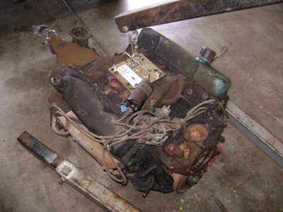

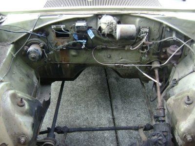

We got the motor out today. Looks like anything that can leak oil did. Everything came apart easy.

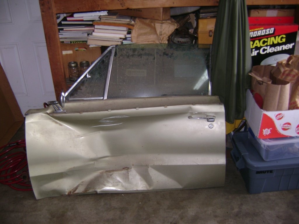

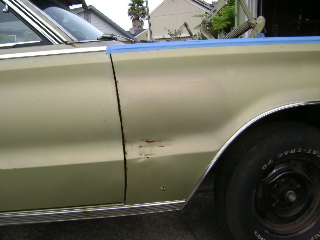

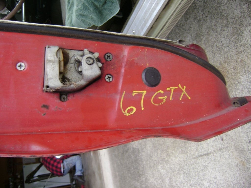

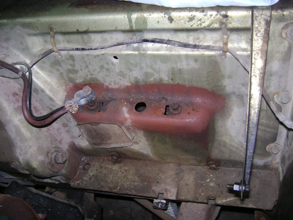

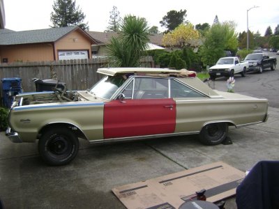

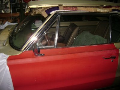

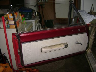

Still not seeing much rust. Needs work in a couple spots but its not too bad. Previous owner brought the original door and a bunch of other parts. All I can say is these are well made cars because the door took all the hit. Hate to drill holes in a GTX door for Satellite trim.
DSC03607.JPG DSC03616.JPG DSC03618.JPG DSC03620.JPG DSC03622.JPG DSC03624.JPG

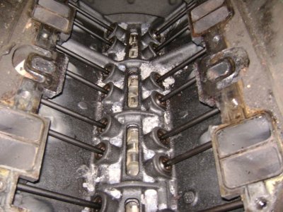

We didn't get far enough in to see why the motor won't turn yet but I'm optimistic. There is end play on the crank so at least it's not welded to the block. No visible rust in the ports or plug holes.

The original 383 is being replaced. It was completely wore out so we didn't bother with trying to unstick it. It's documented 175,*** miles which I'm pretty impressed with.
We picked up a fresh 383 from someone else's failed project for a good price. We tore it down for inspection and everything looks good so far. .030 forged flat tops (.025ish in the hole), 346 heads with new seats and ss valves. Crane 272/284,.454/.480 112 cam. Owner wants to keep stock carb and manifolds so think this should work.
