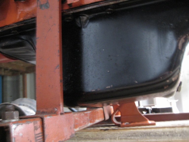

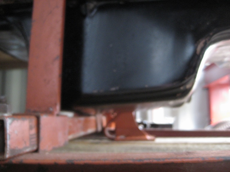

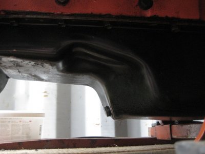

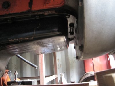

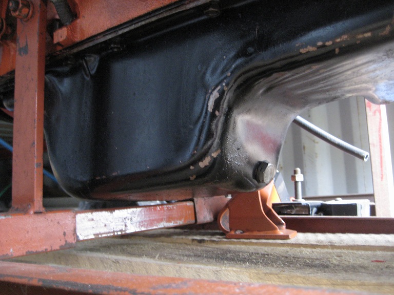

Here we go. Hemi Oil Pan 0011.jpgHemi Oil Pan 0021.jpgHemi Oil Pan 0031.jpgHemi Oil Pan 0041.jpgHemi Oil Pan 0051.jpgHemi Oil Pan 0061.jpg

Gary, that's a C body pan. The 699 and the 187 are duplicates of each other, other than their stamped number. They are both kinda coveted in the A body world, because they have an indention that works with the A body idler arm. I have a 187 pan myself. Nice to know it also holds 6 quarts.

Wow those pictures are cool! Never seen a hemi oil pan, that thing is HUGE!
