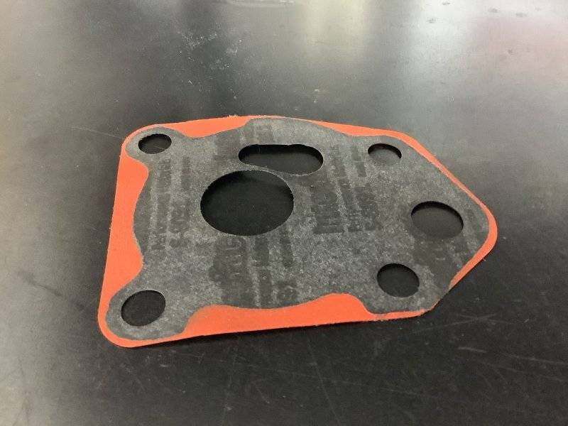

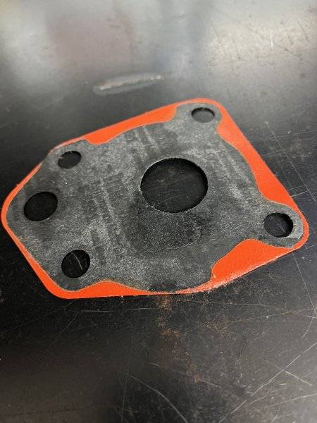

Yup. Brand new one. The large O-ring under the cover was pressed flat with no rebound. Same with this one and the other small one inside. I pulled the oil sending unit this afternoon and it looks like oil has not been up that far. But it has been sitting for two weeks. I expected to see some evidence of oil. Put a flex line down the hole about 4-6 inches and no restriction. The sending unit has been replaced probably by the PO trouble shooting why the gauge does not register. I got nuttin' on why oil would not travel up there to the sending unit if that's the case.
Putting it all back together now and hoping I have a working pump and quiet lifters. The shaft is back in the position it was before and verified with the distributer rotor position.
