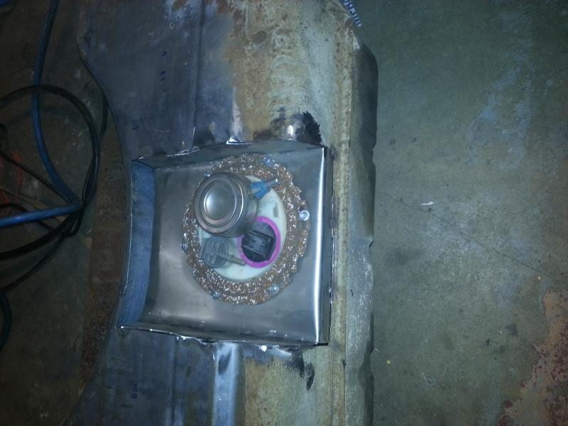

Hey, your car has it's own bulge now, cool! :toothy5:

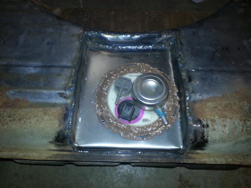

Looks like it should work fine and it's in the front of the tank near the axle so I doubt it will be noticed. Just in case, you could always slap a HEMI badge on the rear face :icon_bounce:
Haha...now there is an idea. I may do that just to see if anybody ever notices the badge. I wish I could have made it a little shallower but thats how it had to be to fit under the floor of the trunk. A positive note, the sump is so big that it will pretty much completely prevent fuel starvation unless the tank is bone dry.
This is the original essence of hot rodding, low buck and high creativity. It doesn't get any better than this.
Well I did a little more work on the tank last night. I have been sick lately (over a week) and today still not doing well so energy is low. So I had planned to do some more today and we'll see but right now its looking like I may just go hang on the couch and rest. Anyway, here is a pic of what I did manage to get done.

Finished up the tank, now just need to clean it inside and seal it. came out pretty good.

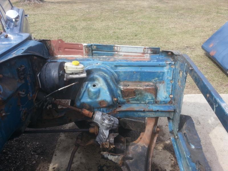

Did a bit more work this weekend but not really for the car. I spent about 4 hours outside on the parts car stripping the gas tank out, both bumpers, the entire front grill and got the engine and trans loose and ready for pullin...well after I knock out the 4 trans cross member bolts that already have no nuts on them. So I would say pretty productive.

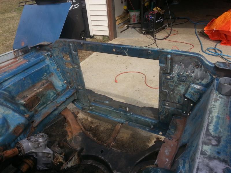

Had some good weather this weekend but not much time with family around to work on the car. I did get out there and power wash the engine bay with no appreciable difference. Looks like it will be time to break out the torch and scraper to get rid of the undercoating that somebody put in there.

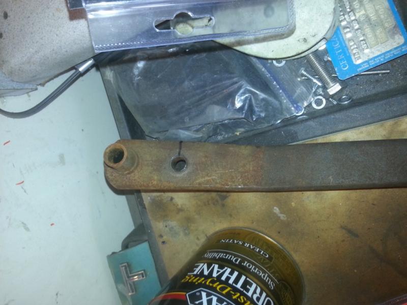

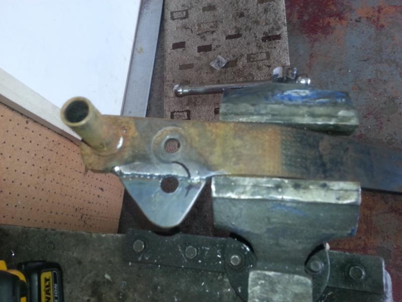

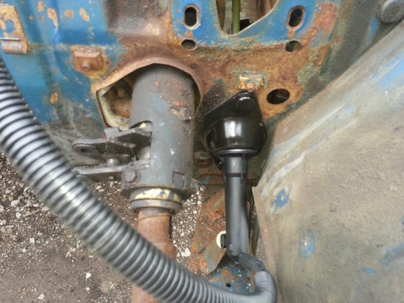

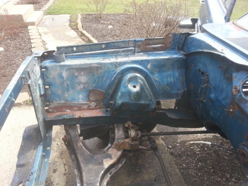

Alright I got out there and got busy today. Spent a while cleaning off lots of undercoating that for some reason they put in the engine compartment. Also cleaned up some grease until I hit a point where things like the brake booster were in the way. So I decided to start getting rid of all of the things on the firewall in preparation for paint. So before I moved the brake booster I decided it would be good to modify the pedal to mate the the brake booster. Then I mounted the clutch master cylinder and cleaned up before starting to mod the clutch pedal. But that will be my next task. Either way I made a huge step toward getting the engine in permanently. I hope in the next week or two to get the engine compartment painted and prepped for the Hemi to go back in.

Looks pretty clean in there. Maybe the undercoating did some good after all.
Nope it looks clean because I replaced metal in about 6 places. if its blue its original, if its paintless or otherwise colored its new or replaced metal. Though there were places the undercoating did a good job.
