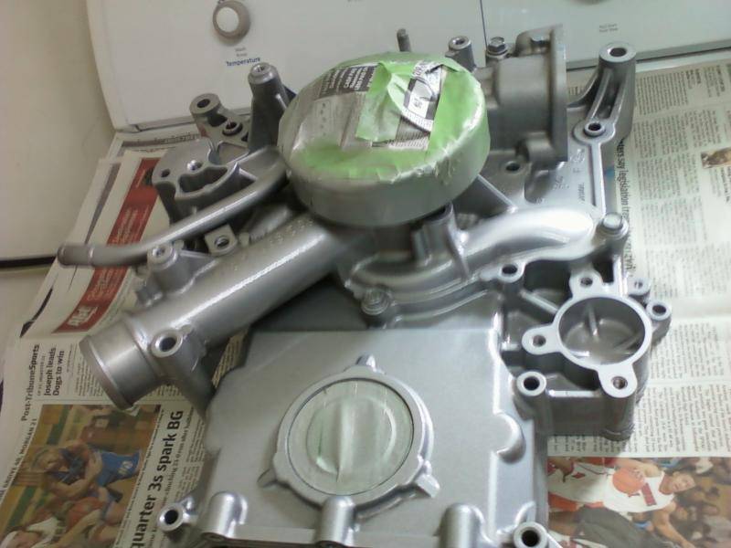

Wow, you weren't kidding about all the nooks and crannies here! Did you give it a round-trip through the DW? I don't think I have the stones to try that (yet) but if it gets any colder here I just might.....
It turned out great, same goes for the body colored bits, it looks dy-no-mite! Pretty cool that you have a workspace right at home and you can keep an eye on this thing's future owner too!

Hah thanks. No dishwasher was full when I wanted to give it a shot. So I put it in the sink, loaded up on Dawn dish soap and went to work with a brush. Found that it still wasn't getting pretty enough even when clean so decided some of my left over bright silver metallic from my ram would make a great aluminumizer (hah made that up).

LOL, I got to remember that one, "Well dear i just "aluminumizered that baby!" A guy in the resto threads taught us that.. Thanks for the laugh bud! lol :)

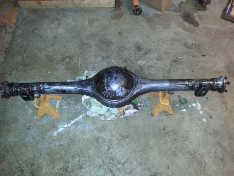

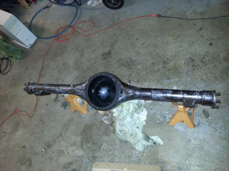

I ordered stock tapered rollers and they get installed on the axle shafts tomorrow by my local shop. I spent some time cleaning up the housing tonight in prep for paint and then re-assembly. Next I will start working on piecing together a rear disk package.

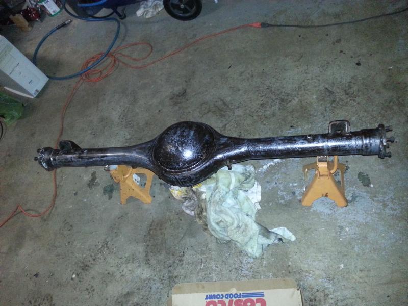

spent some time clogging my nose up with iron oxide dust last night (sanding off the rust) on the rear end then cleaned and sealed it up with rust etcher. Dang that stuff does a good job of cleaning up the metal and sealing in the rust. I'll leave it like this for a bit while I put together my brake package for the rear end. I have to make a couple spacer plates for getting rid of the backing plates and then I can put in the axles shafts and start figuring out a rotor/caliper combo. I am thinking grand cherokee but if I am going to have to make my own weld on bracket the sky is the limit here so I may go even newer and pull something like my new avenger's brakes since parts are pretty cheap.
KB - I've heard that Ford Explorer rear discs are near bolt-on. And you can adapt your e-brake cables to work also.
Your rear end cleaned up nice! Oh wait, :icon_redface: I mean, um, your axle, err, I mean HOUSING looks good, yah, nice work! :grin:

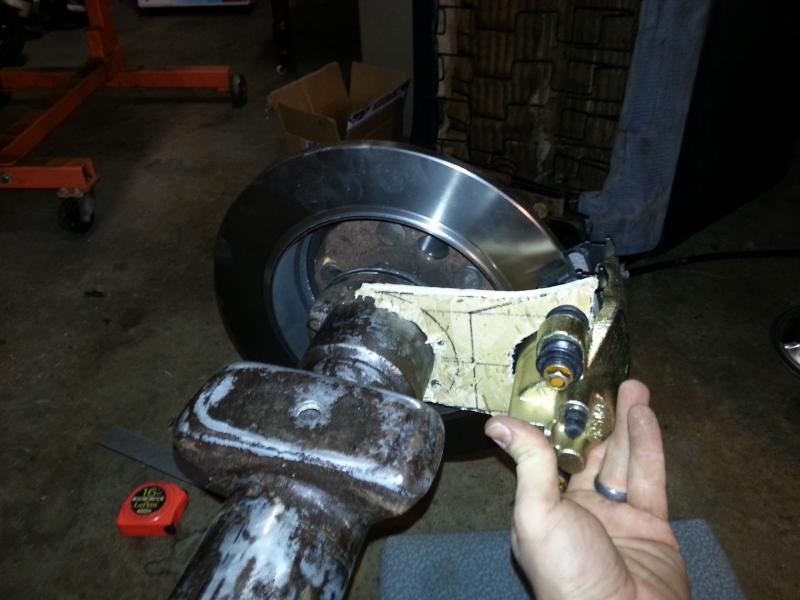

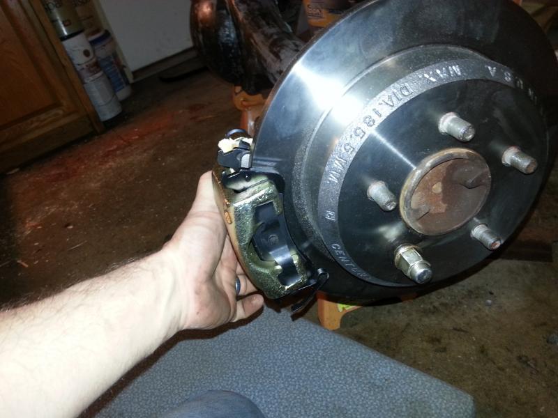

quick update. I made another RockAuto order this weekend for rear disks, calipers and pads for a 98 Jeep Grand Cherokee. So I will get those mocked on here soon and come up with a bracket design to adapt these to the 8 3/4. If I can come up with a good design I may make some and sell them.
So hopefully this upcoming weekend I can get something mocked up but the axles are ready to go in and the housing is cleaned up and ready for paint.

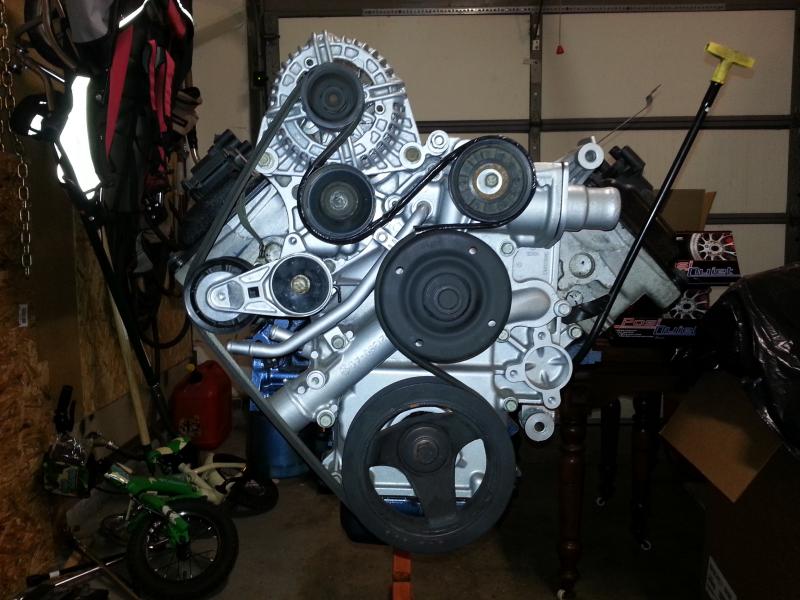

Made some more progress and picked up some more parts. I managed to get the belt routing figured out and cut up an old belt to make one I can take the parts store to find one the right length.

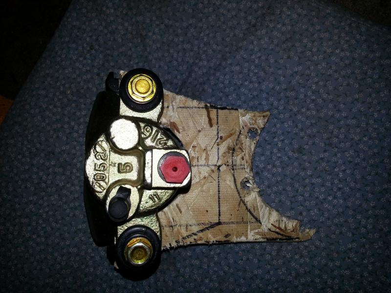

Then I put the brakes partially together for the rear axle and made a wood template for my caliper mount. I have to do some R&D on that one to get it just right but I think I will be able to make this all work together. The idea here is I will remove three of the studs for the axle flange and replace with bolts to hold the caliper bracket. I will also have to get some keystock to make sliders for the pad knotches to ride in since the originals would have had those. Anyway when I get this all done I am considering selling kits if anybody is interested.

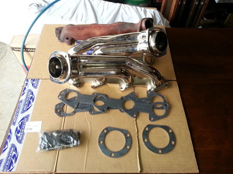

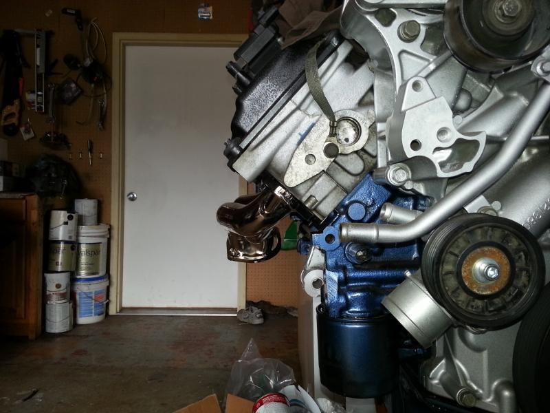

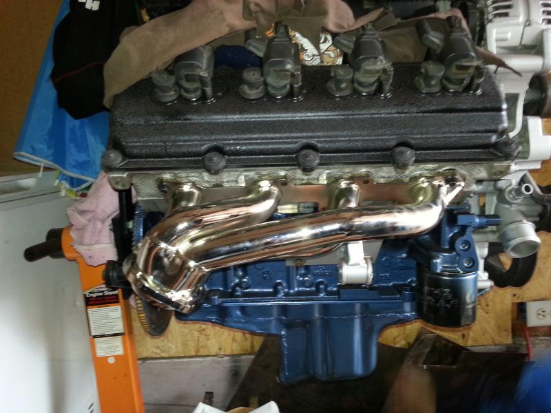

Oh and I picked up some headers too from a local guy.
20130111_220500.jpg20130111_220533.jpg20130111_220522.jpg20130111_220556.jpg20130111_144826.jpg20130111_145038.jpg20130111_145053.jpg
Looking good KB! she'll be up and running before you know it!
X 2 This doesn't even look like the same engine man, real nice!
Thanks. Its taken a little time to detail it but not that much really. Its collecting parts that takes the time and money. As soon as this spring rolls around it won't take long before you will get a video of it running...I am too anxious to hear it rumble to wait too long!
