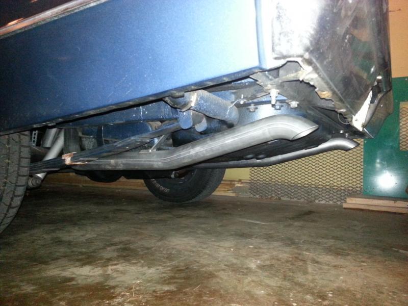

But to go along with that now its on jack stands in the garage awaiting a bit of surgery. I elected to spend a little money on her and ordered a set of 2.5" tail pipes from TTI. So the mufflers are off on the floor and I am ready to begin the install. I also put the trim rings back on the tail lights (since I forgot about those) and modified the battery hold down to fit my large battery. I have a few other projects to take care of too. I need to extend my wiring harness to the back of the car to give me some more room for routing (DOH! :eusa_wall:). I also have a little rattle somewhere under the dash I need to find...but I think I know what that is already too.

So I did get my TTI tails Friday in the mail and promptly set to installing them (after work). I have to say their quality is very good and they fit well....almost too well, they hug really close to everything! I got really really lucky as well. If you were watching you probably remember that I made my own pipes all the way to the mufflers. Well Apparently I must have been working vicariously through TTI because I didn't have to cut or massage anything....it just went together! So within about 2 hours of getting home I was out terrorizing the neighbors. Actually I shouldn't say that as it was quieter than before but does sound great.
I drove the car to work today since the rain/snow missed us last night. I have to say that if you have turn downs and hate the droning this helps a ton. It is not by any means quiet...but it sounds good and has at least stopped the inside from the car from vibrating due to sound.
Once I manage to take these pictures off I will try to post a couple. But being under the car there isn't much to see.

They are 2.5" to match the rest of my system. I think 3" on a stock 345 CI small block is probably overkill.

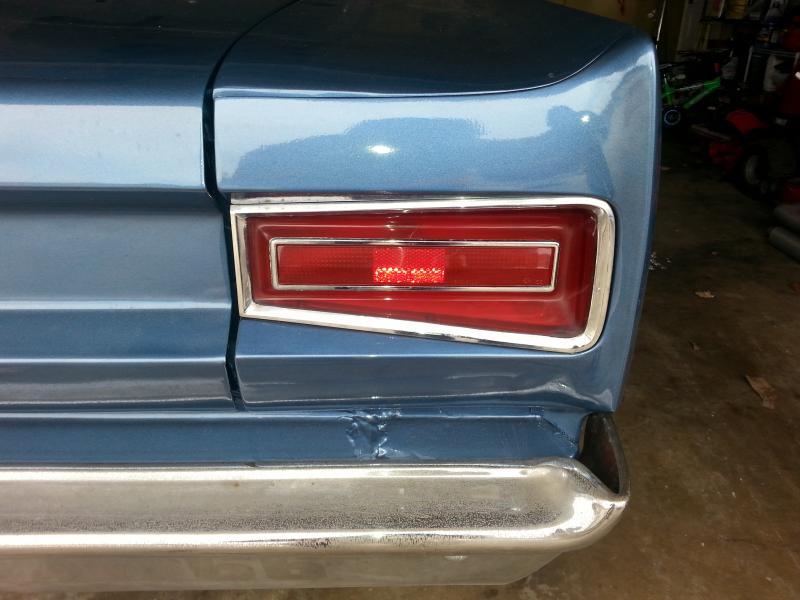

I also put my trim rings back on my tail lights. The little tangs broke off but I used 3M trim tape and cut it down. It worked well.20150315_143648.jpgView attachment 247393

Nice fix on the trim, it's painful to think about replacing a good part just because a tab is broken off so you have nothing to loose by trying and the way that stuff sticks it will likely go to it's grave with it.

Just the tails helped. Moving the exhaust from under the car out to the back gets rid of the sound that bounces off the ground and returns to the car. There is still some bass tones that can get loud around 1500 rpm but that is a function of the mufflers. I would say to reduce that I would need to add a resonator somewhere.
Yeah that 3M trim tape is a hoss. I actually remember about 15 years ago I used some to put the side trim back on my 83 AMC Eagle SX/4. I actually stood on the trim once....it didn't budge and was only held with that tape. (granted I am a little fatter these days :( )

They'd be really really really close! I only have 1/2-3/4" of clearance from the pipes to the gas tank, shock frame and shocks already. I would think with that extra 1/4" of tube on each side it would eat up all of that....but with some massaging I bet would fit. You may have to play with the rear hangers and move them outboard a bit more to gain the clearance. But I would hit the go button if you want a set.

I also put my trim rings back on my tail lights. The little tangs broke off but I used 3M trim tape and cut it down. It worked well.View attachment 247392View attachment 247393

Its the gas tank actually. Its wider and the filler is in the way too. If I had a rusted out trunk I'd put a 68 floor and tank in.
