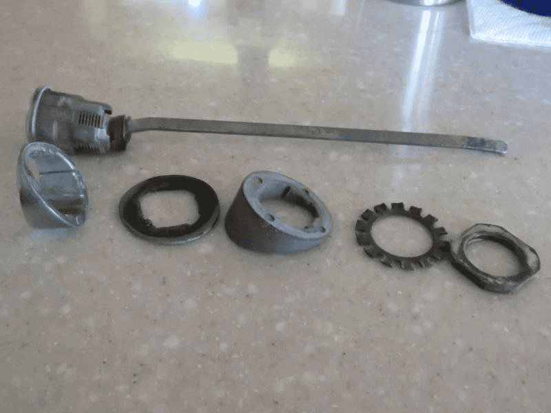

1967 Dodge Charger Trunk Lock Cylinder and Keys. The photo of the cylinder that vendors show for this car does not look like my original. My retainer is offset and the bezel screws on, not installed with a clip. Who sells the correct one?
Unfortunately no one reproduces the trunk lock for the 66 or 67 charger. All others use a clip to hold in place the first gen uses the nut you referenced. The venders do not make exclusion for the charger but they should. Only 2 options. 1. Find a locksmith to make a key if that's the issue or 2. Find a used one as a replacement. These can demand some money so be prepared when you find one.
To make matters worse they are a one year only lock and keys. They are different from 66-67 so they are year specific.

This is a picture posted back in 2018 but good reference for anyone needing info on the trunk locks of our cars.
