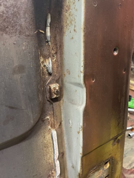

Inspection mark nerd-fest

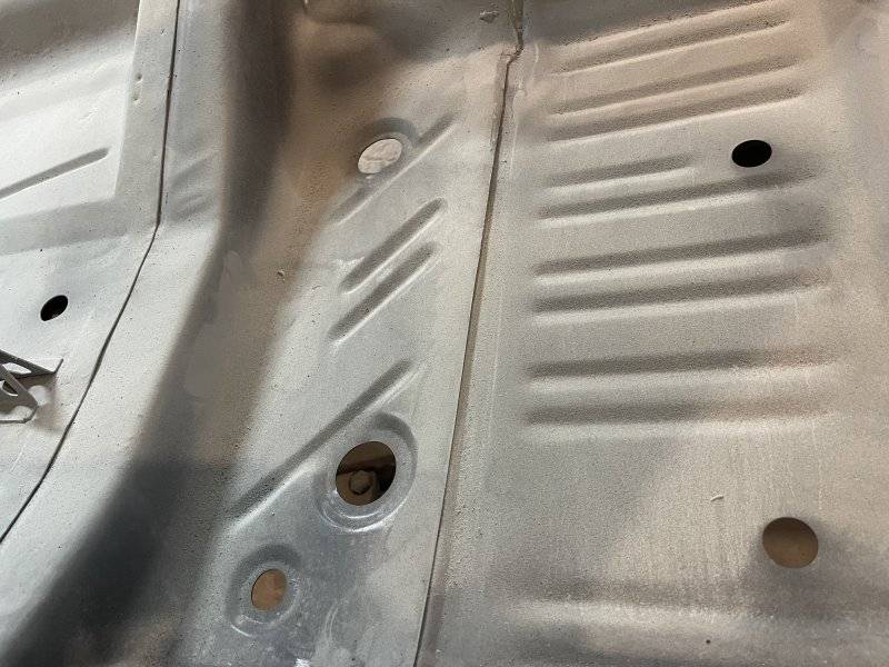

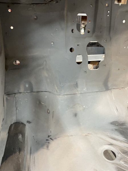

You can see the colour of the dip or primer ?? on this thing- almost a blueish green gray

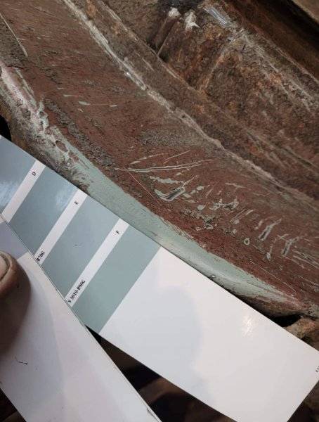

This is the underside of the roof- u see what would have been under the headliner
So how did that end up that high up on the body ? Same colour was on the inner fenders and frame rails
They sprayed full primer as well. Dip line was generally up to the wheel wells. I need to get on my computer to show you the definite dip "line" on my 70. Don't think they did 66/67's any differently.
We saw the dip line - half way up the doors. That colour must be the primer .
I think the 66 cars at least were different. At least some of them.
I have a survivor 66 Hemi Satellite and there is red primer like Hemidar1 shows in front wheel well.

I just show red primer like hemidart1 did.
It may be on top of the dip overspray from exterior primer.
I've seen variations on gray dip color and LA plant used black dip. Just keeping open mind on this and going off what whatever the car you’re working on is showing you.
