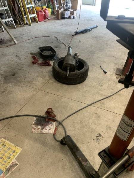

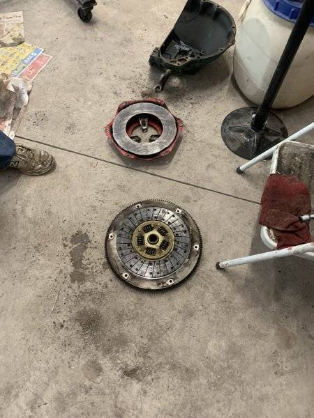

Getting old is tough … pulled trans & clutch assembly with a buddy. Nothing was easy. Sending out flywheel to be Machined ordering a few more parts.
Found pressure plate at a broken spring with early breakdown of pressure plate.
