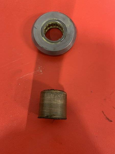

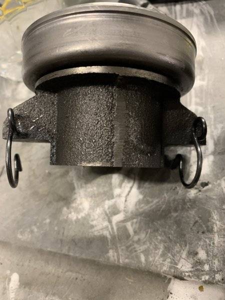

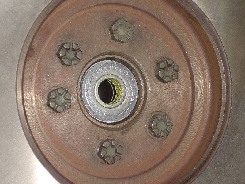

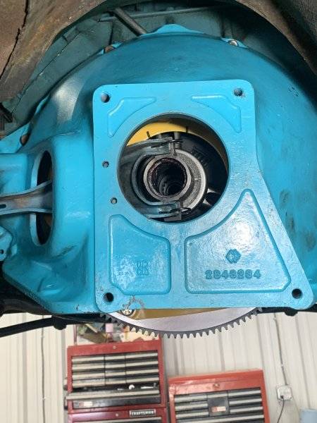

We’re you using a pilot bushing and a pilot bearing? Using both was not recommended according to Brewers.

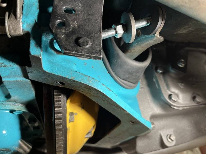

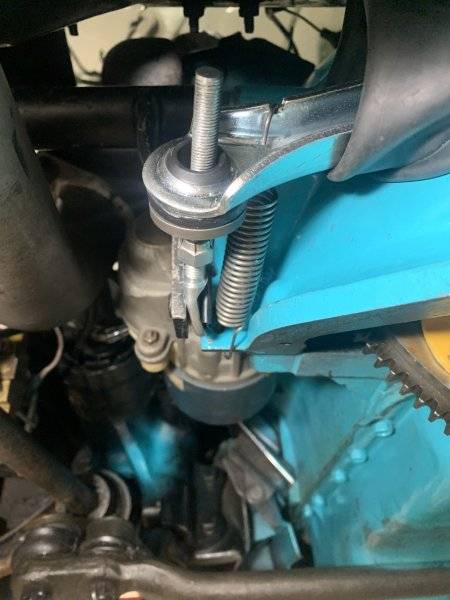

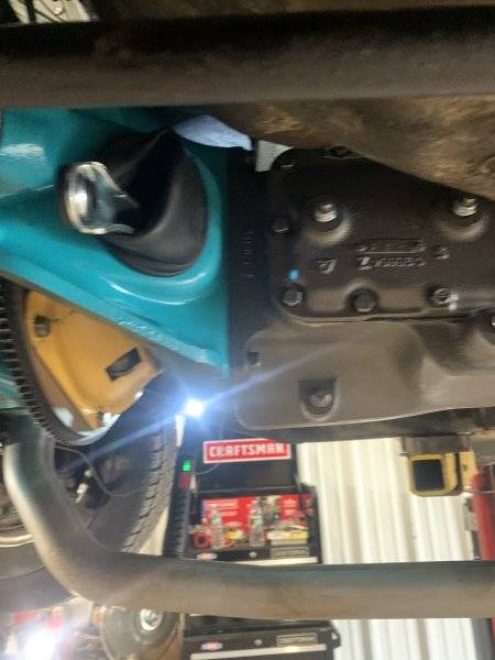

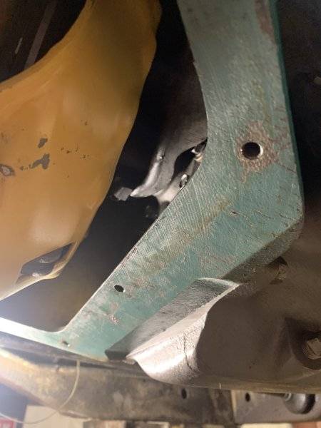

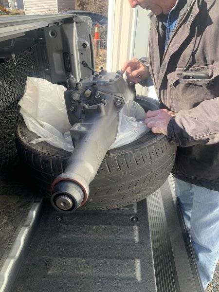

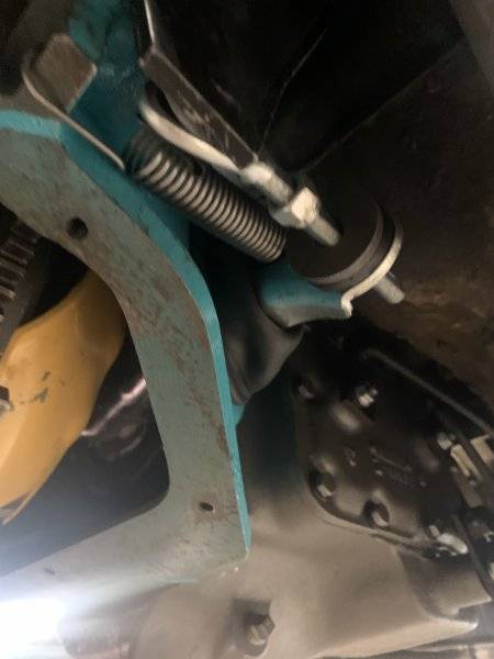

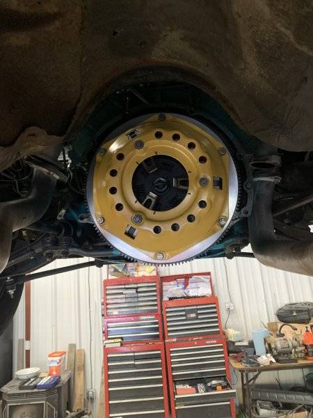

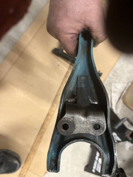

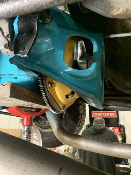

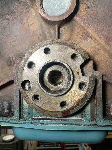

having a hard time, I can get it into the throw out bearing but can't get it to mesh into the spline of the clutch..What's the problem?

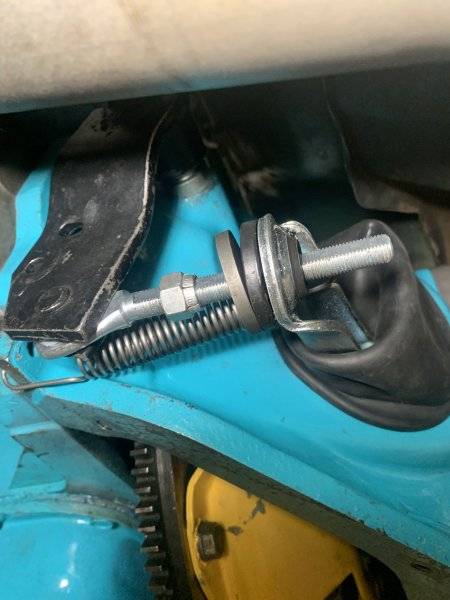

My back started to act up so I stop.....Hook up the clutch linkage and put a couple threaded dowels (4” long) in the bell housing bolt holes to help carry the transmission. Put the yoke in and put it in 4th gear. When sliding the transmission in, if it hangs up, try rotating the yoke a few degrees and that might do it. But most likely you need to get a helper in the drivers seat and while the transmission is slid in as far as it will go, have the helper slowly press the clutch pedal down while your wiggling the transmission forward. This allows the disc to move slightly while the input snout finds the pilot bushing hole and slides in. So far I’ve never had this fail me (hopefully you won’t be the first).
