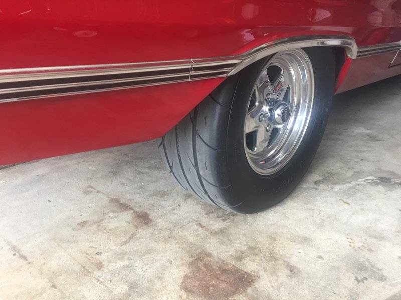

275/60/15 8” wheel with 5” of backspace they don’t rub.. not at the track running in the 11’s...not with 2 people in the back seat going to car shows and cruises.. they just don’t. I would spend the money on ordering wheels or get 5.5 inches of backspace on a factory wheel and run 1/2 inch spacers

The only issue I see with that is purely aesthetic. I don't like that little of an offset on the rear. I like my older cars to show a a little depth in the rear rims. A day 2 big and little wheel aspect if you will. Just a personal preference I guess.
