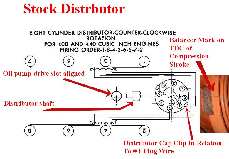

Make absolutely sure your wires are correct. 5 & 7 are easiest to mix.

b. TRIPLE check that each plug wire is going to the correct cylinder & in the correct order. Remember, big block mopars' distributors turn COUNTER-clockwise. The cylinders are numbers 1-3-5-7 front to back on the driver's side & even numbers on passenger side.
