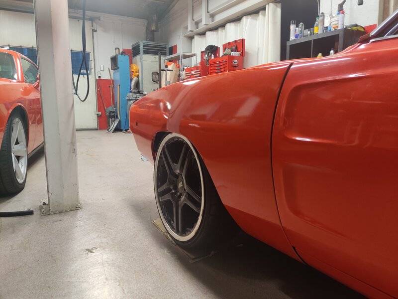

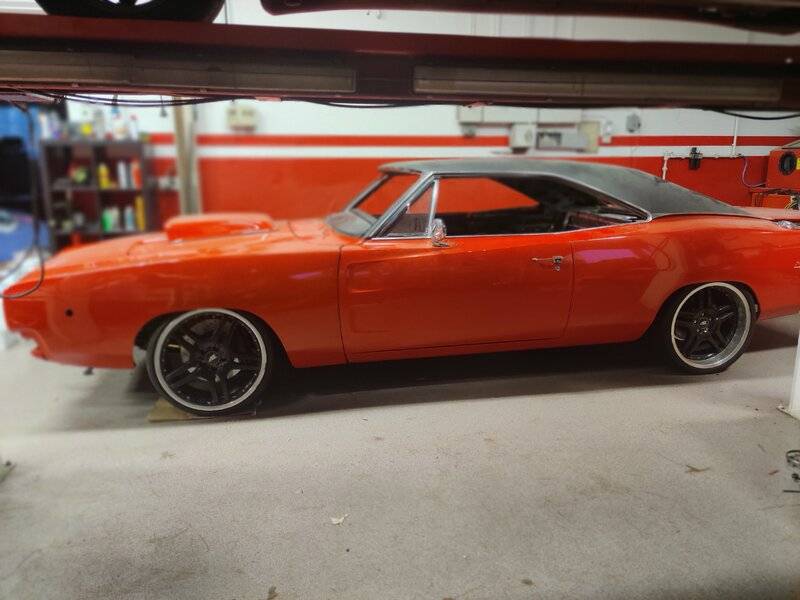

1968 Charger, Ray Barton 528 Hemi, Pro-touring.

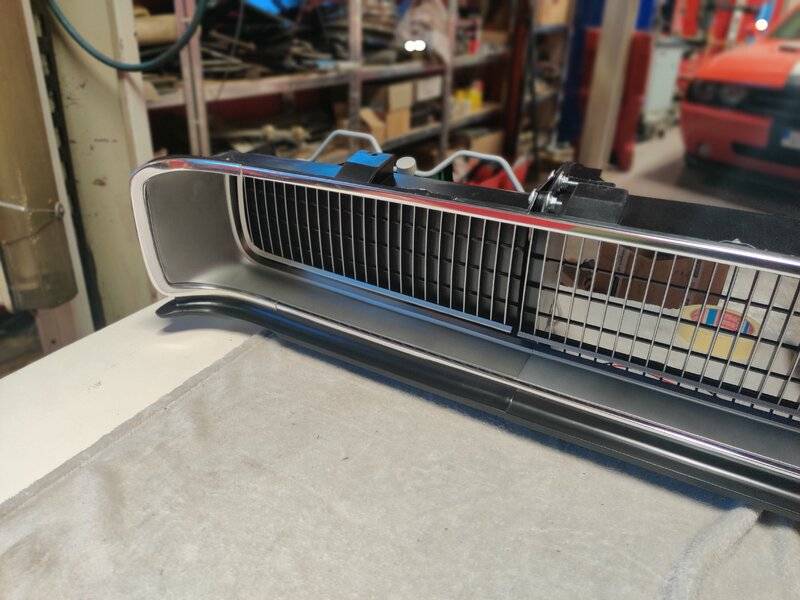

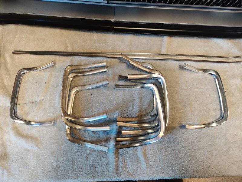

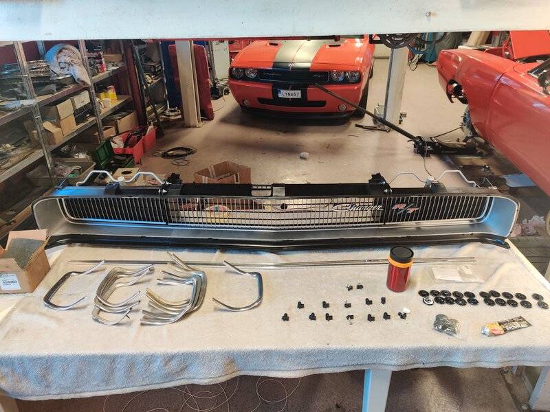

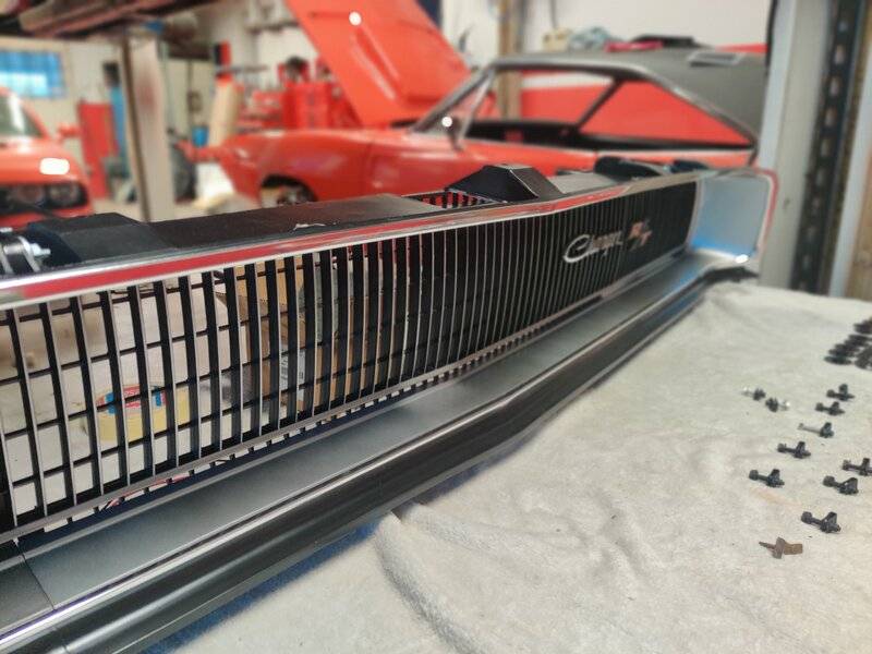

Took me a while but the trim is there..
Center pieces are new and had some old corners to pick and chose from. Polished them but they aren't in perfect shape but will do for now. Will Invest in new pieces eventually.

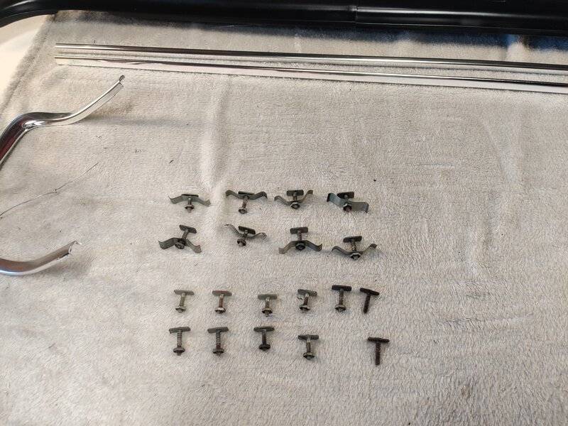

Zinc-plated all old fasteners since I didn't have a new kit.
IMG_20210413_182420.jpg IMG_20210413_182407.jpg IMG_20210413_185734.jpg IMG_20210413_200837_Bokeh.jpg IMG_20210413_200823_Bokeh.jpg

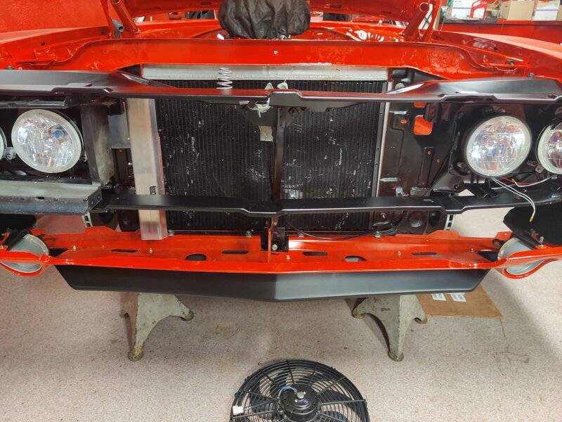

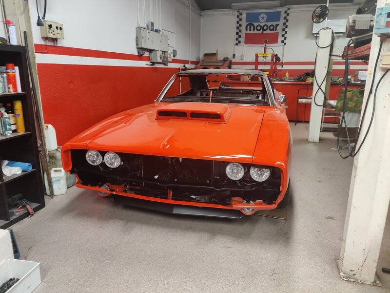

Forgot the little detail that the bumper support frame must be mounted before the front valance..:mad:
So, tore that down, in with the support and up with the valance again.
Removed torsion bars and fitted the rubber protection and clips that I was missing.
Fitted the front edelbrock shocks and the steering rods again with the bumpsteer bushings.
So I feel I'm back to square one again..

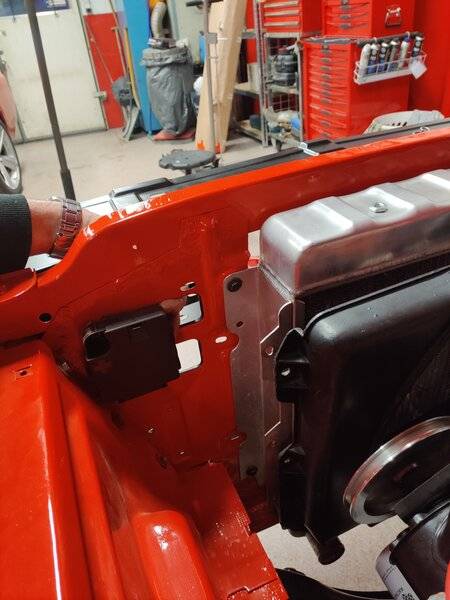

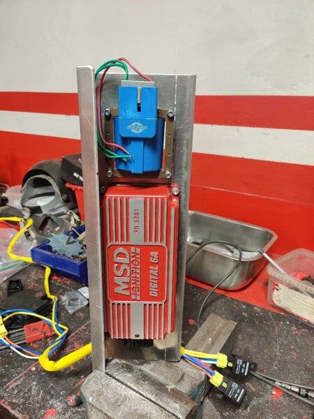

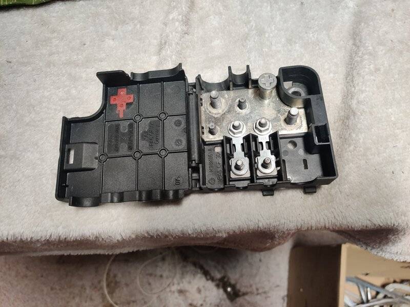

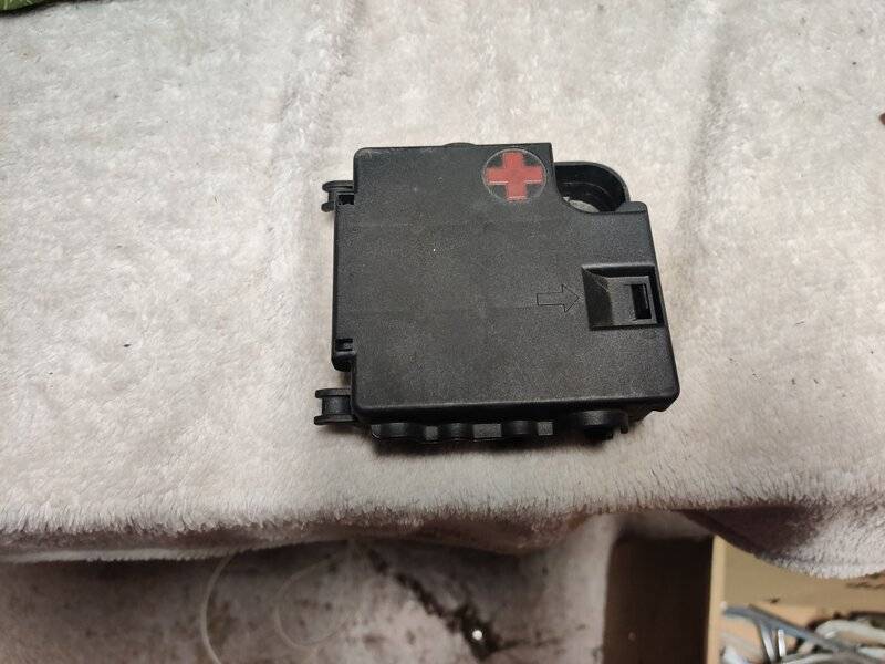

Prepared an alu bracket for mounting electrical stuff like the coil, msd ignition box, msd tach module and all relays for headlights, linear actuators etc. I'll need to paint it black though.

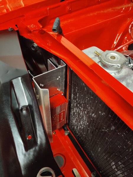

Spent a lot of time figuring out where to mount the power distribution.and I think it will end up on the rad support, driver side.

Looks like a nice clean installation of the electrical mounting!

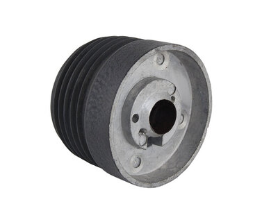

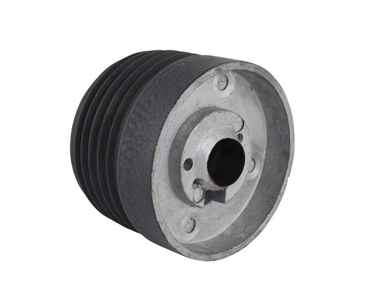

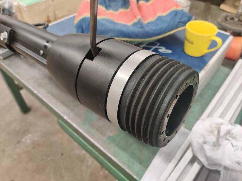

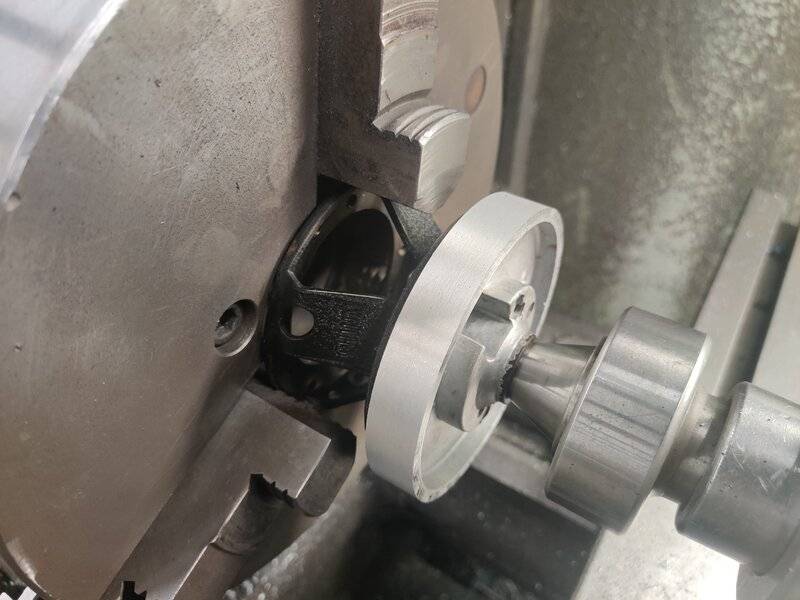

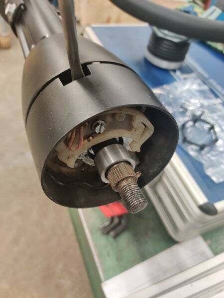

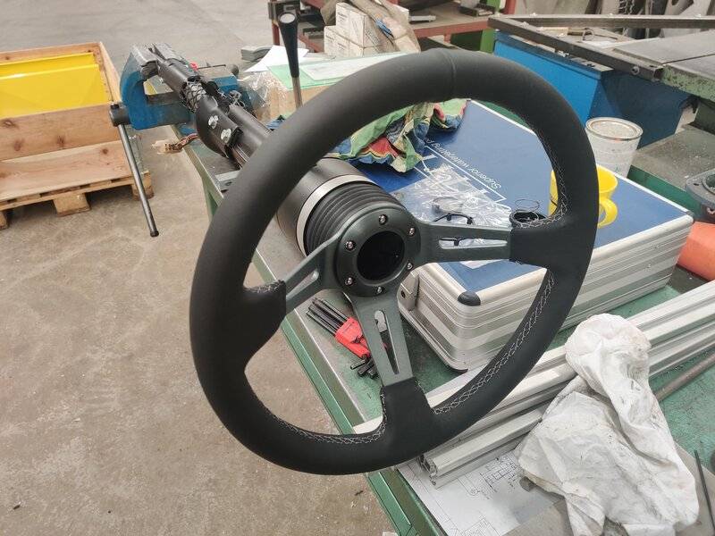

Got a new steering wheel and a universal hub that was supposed to fit.. well of course it didn't. The splines was correct but the offset wasn't. The splines in the hub didn't reach the steering columns splines. So I had to modify it, thank god for easy acces to the lathe. Cut off 9mm and made a bushing on 13mm. This gave me the correct offset. It had an ugly wrinkle paint finish so i took that off and will spray it with the same satin black as the rest of the column. I have to think about how to make a slip ring somehow. I don't like the idea of a lose cable coiled up inside to the horn button..
Finished the front end and tried spacing out the weels and adjust the torsion bars just to get an idea how it will look.
