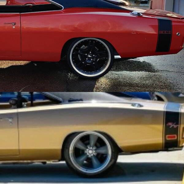

Get it on an alignment rack, as I bet your rear axle is "dog tracking" now..
Sure will! We have two more Chargers in the family that I can do messurements and compare with.
Does anyone know if the axle should be almost a 3/4 of an inch more towards the rear on the driver side normally when measuring from the wheel openings and comparing sides?
Just by looking at this picture I feel that my wheel is too far back. Just doesn't look right. Or is it just me?
Funny I used the same size as the gold charger on my wheels and they look good
you have what seems like a shorter tire ?
In that picture it's shorter. I have taller tires now. 295/35r20. If you look at the rim instead I think it's quite obvious that it's to far towards the rear. Could be my eyes fooling me but I don't think so.
This is referred to as "thrust angle" on the alignment rack. For sure, make the a high priority measurement that they check. If its a little off, Hotchkis makes shims to slip between the hanger and the unibody. In consideration to where you are and the mad skills you've been showing, you can make your own. If there is a massive difference between the right and left, look for structure issues[ frame rack time or worse] or a bent diff housing. Whoever does the alignment needs to hang the targets on ALL four wheels, not just the front. You need to make sure the front and back jive together so you don't get the "dogtracking". As I've stated in other threads, don't let them get away with the old "set the toe and let it go" alignments. Expect to pay for several hours worth of time/labor to get everything squared away on your settings.

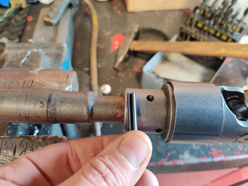

Shortened the steering shaft to fit the Borgeson power steering box and coupler. Drilled a 5mm hole and drove a spring pin into it. All bolted in and fits really good. The steering wheel was way to far out so i modified the adapter, again.. shortened it as much as I could and now the steering wheel has the exact same measurement as the original one measured from the dash. But now it's too tight fit for the horn button. I guess I need to make a ring in the lathe to move it further out to make space.

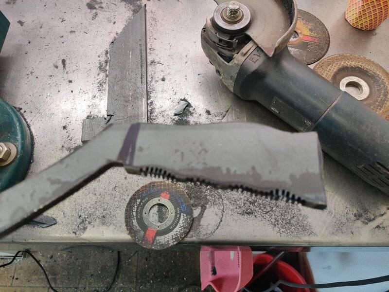

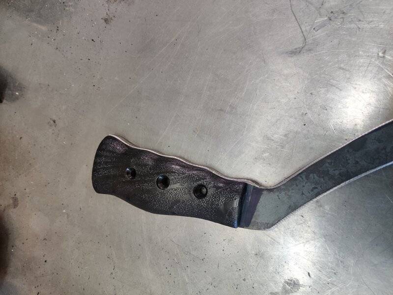

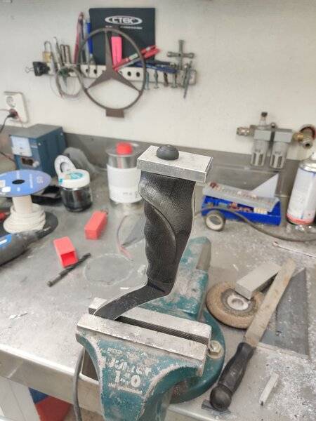

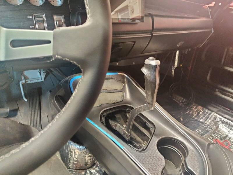

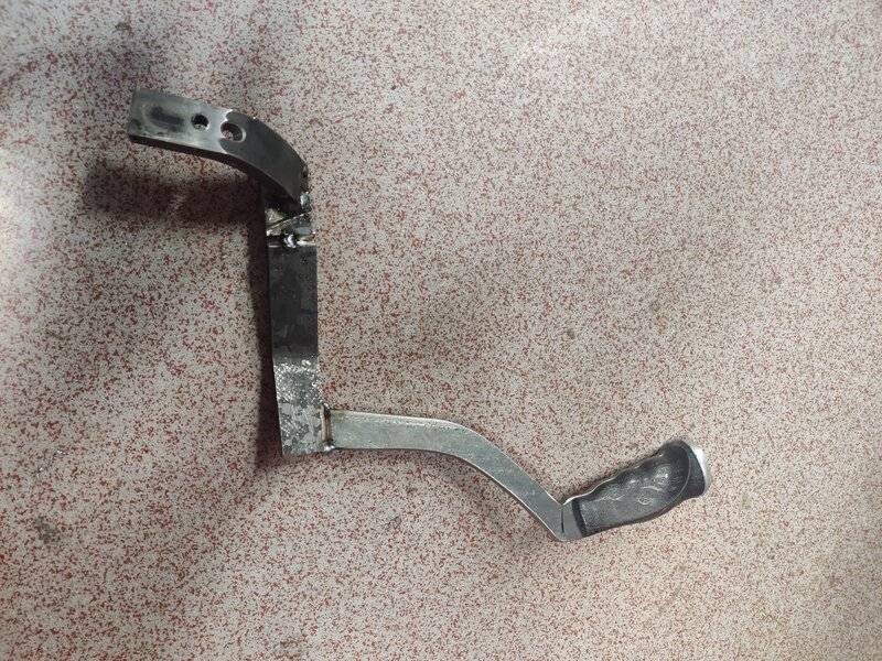

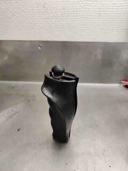

Made a first trial on a shifter to suit the opening in the modern Challenger center console. I think it'll work after some more trial and error.

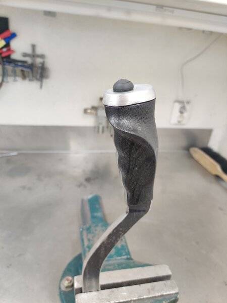

Wow. Making your own pistol grip shifter.
Impressed!
Well, I had to. If I want to use the Challenger console I need to get the shifter in the exact location. And while I'm at it, why not add a nice touch to it, the Line lock should be easy to access if I want to use it.

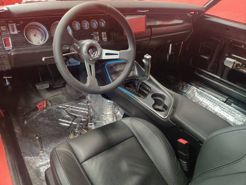

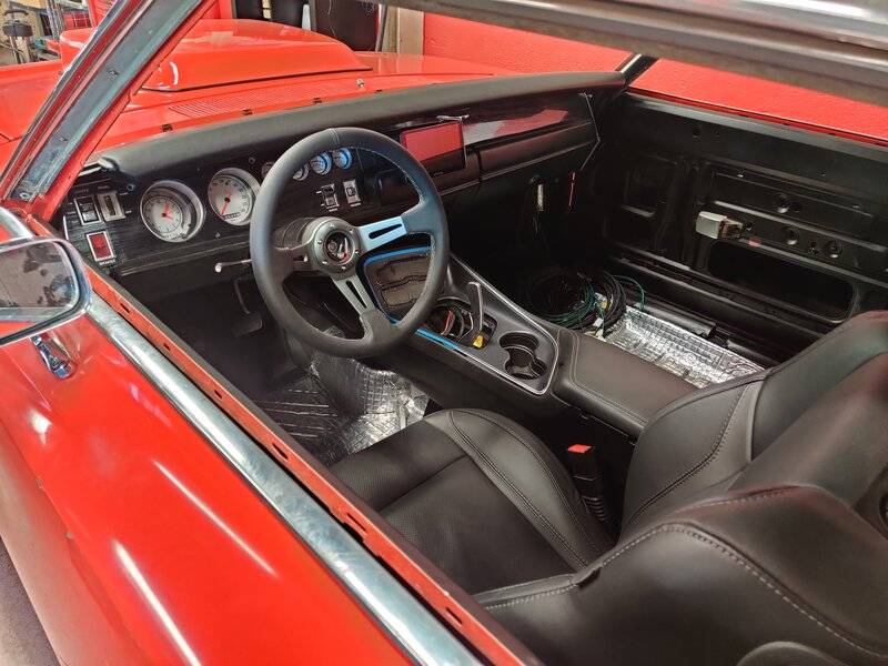

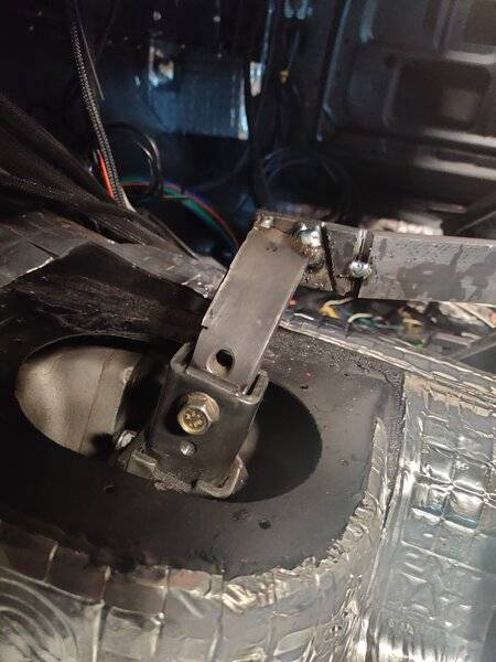

I have working clutch and stick shifter! But I need to clean this pig! Not my proudest work but I can probably smooth things out to make it look decent. It Will be covered by the console and the boot but still... Drilled and tapped the shifter through the holder mechanism. I wanted to remove all the play I could and it worked out really good when bolted down. It's like night and day compared.
The gold one looks like it has a bigger diameter tire that fills the opening.
On the shifter.. pfff, it's just metal. Fill everything with enough weld and you can grind it to look like a gem lol. Good luck
