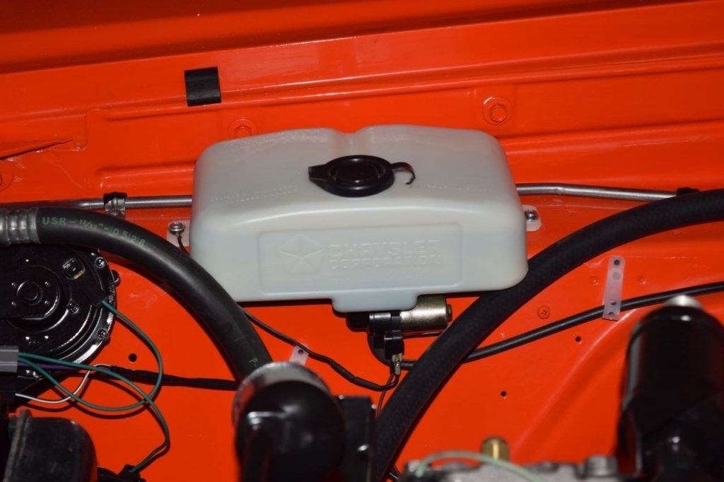

Jim-is it running yet?? Really need to lose that black breather cap, I still have my oem chrome one,lol. $84 at Classic for a repop? whoa.

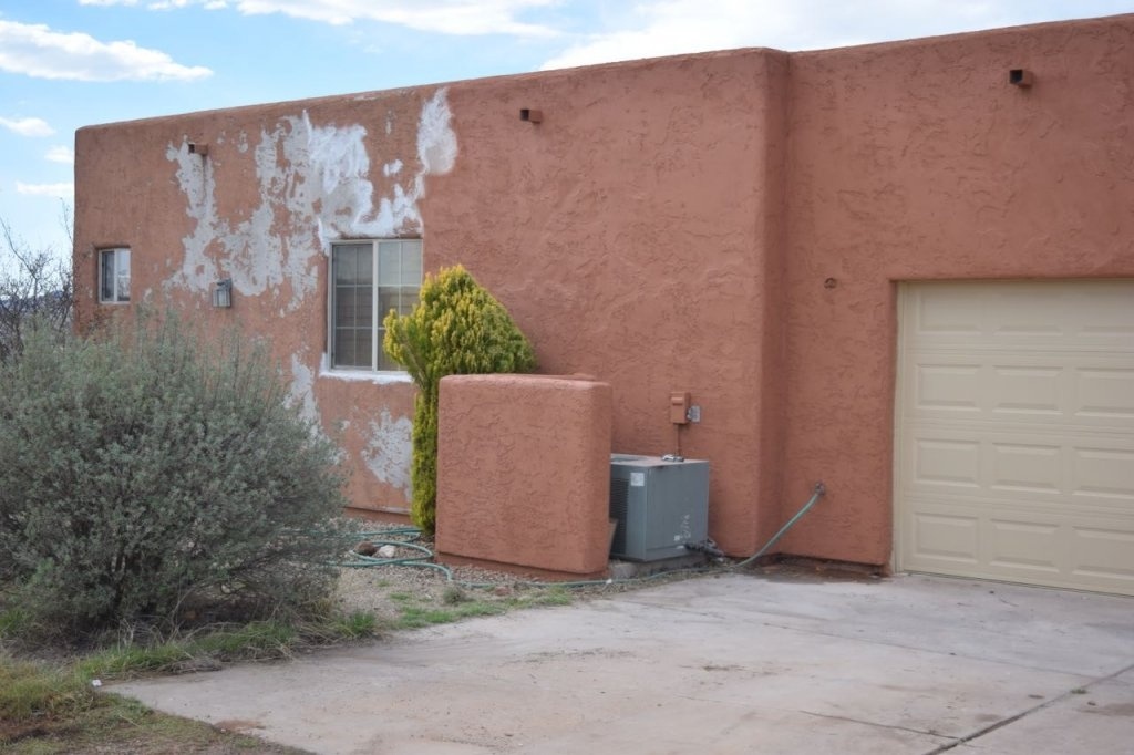

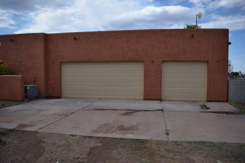

Well only 4 at noon! Spent the day with home improvements. I need to get the house painted before it get too ruddy hot. The south and west side are the worst. The south is 3/4 done and I am 4/4 done for the day.

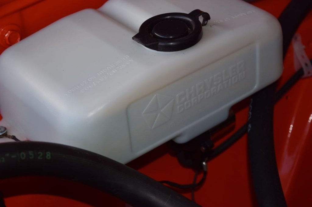

Ok I lied I did go back out in the garage and work on the Coronet..... I filled the windshield (which I don't have yet) washer tank with fluid. The poor bloke that pushes that button is in for a surprise with no windshield :)

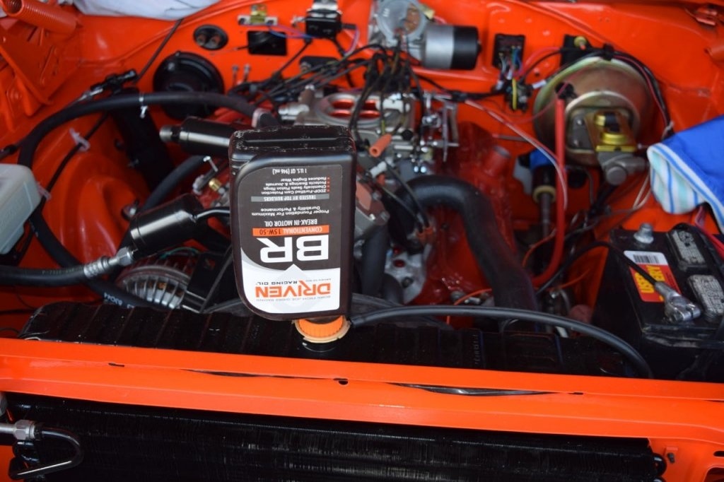

Ok got more energy after a shower and the sun is setting so the temperatures are going down. I filled the power steering pump, transmission with Dextron III, and installed the break in oil that the machine shop gave me. I don't understand why it never registered on the dip stick but whatever....

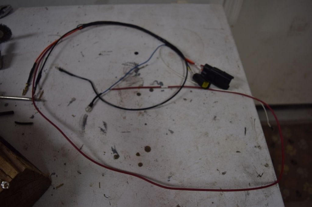

Ok more work on the house but then more work on the Coronet. I got my NOS antenna. Pretty, but it should be for the price. It got dark before I got a picture. I am thinking based on the hack of a fader switch that the radio was dealer installed. The hole in the fender was not big enough for the OEM antenna. I think the POS aftermarket antenna was the original antenna installed by the dealer. I also fabricated my underhood harness for the FiTech EFI. Everything needed for the EFI system. Sorry for the focus I did not realize the autofocus was not on and without my glasses I don't know if the screen is in focus or not :). Getting old sucks.

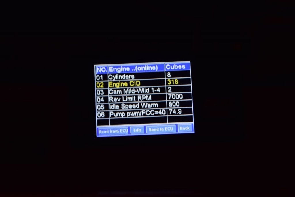

I also bought 5 gallons of gas and got it in the tank. The gas gauge did not move much... I think the calibration of the aftermarket float won't be right. I need to measure the resistance of the sensor with 5 gallon and write it down. I know empty it is about 80 ohms. I have a few data points from my previous test of where the gauge is with different resistances. I will then add another 5 gallons and see what the resistance is. I will then just add a resistor in parallel in the harness somewhere to fine tune the sensor to the gauge. Before I called it a night I plugged in the handheld, turned on the key and communicated with the ECU! I did not have the fuel pump wires hooked up yet. Need daylight and fresh head to ensure I am getting what I need from the fuel system.
