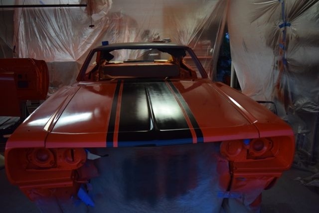

I like it. These cars almost need something to break up the hood and maybe the trunk. That is why I did the stripes and the 6 pack scoop.
Well today was suppose to be an easy day.. Layout a few stripes, spray on some black and hit it with a couple of coats of clear….
HaHa….. All went well in the the beginning other than taking longer than planned (surprise, surprise)…
Then the black went on…. like crap… It started to get pinheads of orange coming through the black (solvent pop? The orange was almost 24 hours old). So what does brainiac do? Spray on more black, then what… runs with more pin heads of orange…. I text the wife my frustration and and walked away till tonight. I did not think I could wet sand out the mess without destroying the tape but the 3M vinyl tape held tight and worked well as a gauge to how close and flat it was around the edges. I also through out everything that everyone told me and I wet sanded it out with my hand, way more control. The nasty run is in the back and I am still working on that one but the front was salvaged without too much drama…
It now looks like a Coronet with a Roadrunner identity crisis! I wanted something different than the normal bumble bee stripe and it competes with the "Coronet 500" emblems on the side so I went with a triple stripe.

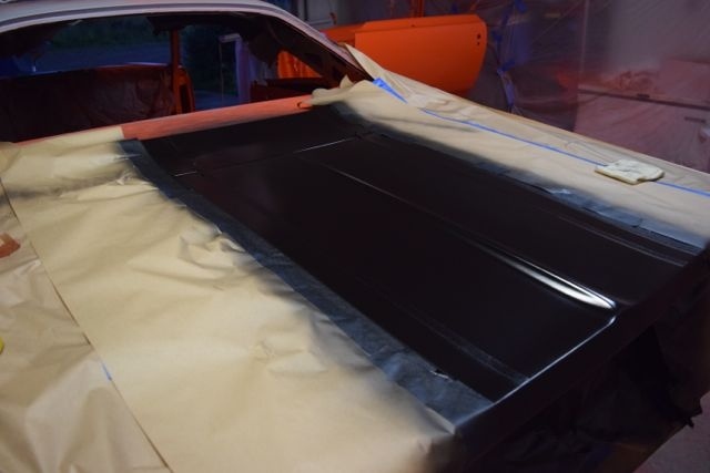

Here is the back still trying to recover from a nasty mess on the dutchman panel… I need to get it done tonight so I can get the tape. It is already leaving a lot of glue behind…

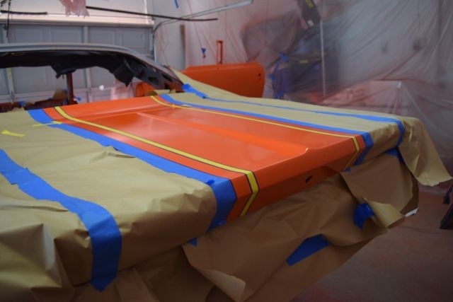

Wow. I am ready for clear tomorrow. It was going better than ever.....until the trunk stripes. The hood went perfectly. Another hint, never use the cheap thin paper from hardware stores for masking. It will bleed through if you spray enough paint on it. When it does it attacks the paint underneath then you get paper bonded to your paint job. This was the last thing I needed to do tonight. That was at 6pm. It is now midnight and one fiasco after another it is finally done. Also never throw away the small amounts of paint left over. You will always find a repair you need to do and it is nice to have a perfect color matched cup ready to go for a touch up. Time for bed.
