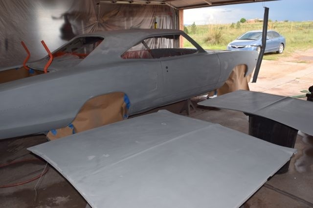

What a day. I almost pulled it out of the garage and pushed it over the bank. The week and weekend was planned out to get the color on the body this weekend. I spend the week nights blocking out the hood and filling some dents with glaze. Also the right front fender rolled in at the interface to the door and I had to build up a bit there and glaze it. I started out the morning removing all the plastic I had used for masking off the under body and engine compartment. Lessoned learned, Do not use plastic sheets to mask. As you build up layers of primer and you spray more the air pressure will blast the plastic and the primer will sheet off the plastic going everywhere. I spent the morning converting to paper.

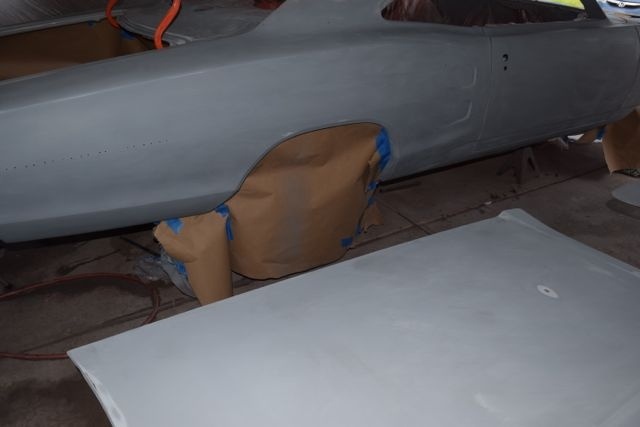

After masking I was feeling good. There were two small dents that I wanted to fix but I was too lazy to go to town to get more glaze. I decided it was good enough and started to do the final sanding with 400 in the "unimportant" places. I about died when I thought I saw rust bubbles under the primer at the corner of the quarter panel right behind left rear wheel as I was sanding on my back laying on the ground. I sanded and looked and looked. I finally decided something was wrong and I could not figure out what because I knew I had put a patch panel in that corner… I pull out the sand blaster and starting eating away at my perfectly straight panel. Once cleaned it became obvious. I had a bear of a time welding upside down and I had a ton of pits and pinholes in the weld. I remembered I was going to come back to this and clean it up. Well I forgot and the welding flux has made the bond of the epoxy primer fail. ARRRRRGGGGG…… I blasted out what was needed and applied the fiberglass filler and while it was hardening I went to town to get glaze. I spent the afternoon applying the glaze and blocking it straight. I finally decided it was ready for the last 2 coats of SPI Epoxy Primer to seal it up ready for the orange.
The gun of epoxy went on okay the next one was way to dry and I could not figure out what was going on. This sucked as this was the final base for the base coat! As it was spraying the sail panel the damn lid "popped" off the cup and a pint of primer poured on to the sail panel…. ARRRGGGGGG… I blotted it up and put on a wet coat to try to blend and reactivate it to flow out….
After the next dry spray I finally put 2 and 2 together and noticed the bleed hole in the lid was plugged! ARRRGGGGG…. About 1/2 through the last panel a neighbor stopped by to chat, so now I have a dry transition in the middle of the front fender.. ARRRRGGGGG…
It started to sprinkle and looked like it might hail. He took off to get the horses in. I sprayed the rest of the fender and all of a sudden it started to HAIL and POUR. I ran to the garage door button but every time I hit it the hail would cause it reopen and the front of the freshly painted car was getting rained on… ARRRRGGGGG…. I pulled the emergency rip cord on the door and slammed to shut and tried to _carefully_ blot the water of the fresh primer…..
I read the "Perfect Paint Job" article in the SPI tech manual and read where the last coat should have a couple shot glasses of Reducer to help make it flow so it is a better surface for the final base coat. I mixed up the last coat with the Reducer and and started to shoot it. Just as I started to shoot it I realized the wind has blown the plastic I had hanging for the "paint booth' up and got dirt and crap all over the left side… ARRRRGGGGG… I stopped spraying just in time and wiped the side down.
I then proceeded to shoot the rest of the car and that coat flowed out nicely due to the vent hole not being plugged and the Reducer….
It was almost a disaster day but the last coat went of nicely. I do need to really rebuild my "paint booth" with new fresh plastic tomorrow before I shoot the base, there is still way too much crap in the air and paint….
The panels are dead straight though so it ended well I guess…

I spent the day sanding with 500 grit. After I looked at it I convinced myself it was NOT ready for color and sucked it up. I sanded out every last bit of orange peal (which was horrible where I was struggling with the gun) and filled a few low spots and imperfections with glaze. I then spent the rest of the afternoon blowing, washing and sqeegeeing out the garage. The next coat of epoxy primer MUST go on perfect so I need prepare the garage like I was going to paint the color. That will take me the rest of the week after work.
