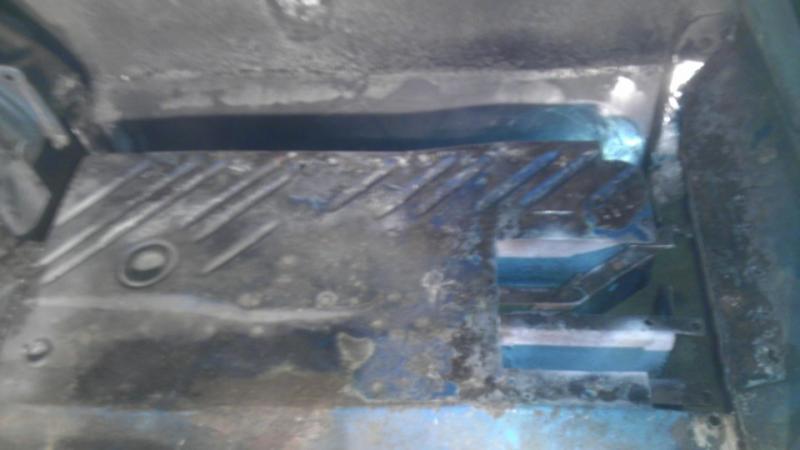

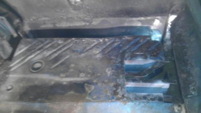

Hello everyone..i am touching up a pretty complete 68 gtx and was wondering if any of ya out there would mind sending me some pictures of a completed trunk and maybe some does and dont's for completion..some water sat in the trunk bottom and rust started..so i may as well redo it correctly..your help is appreciated..

I just finished my trunk in my 68 Coronet. Both extension panels, rear support (behind bumper), patches, and mini tub. If yours is as bad as mind was you will need to buy repo panels. I got mine from AMD, great quality and not bad on fit. Get a spot weld cutter w/ replacement cutters. Center punch and drill spot welds (slowly w/ cutting fluid). Clean all old metal and weld thru primer it. Get a set of clecos (eastwood.com) Fit Fit Fit. Drill holes (about 5/16-3/8) in the new panel about were the spot welds were and rosette weld the new panel in. This will mimic the factory welds. Fab patch panels were needed, leave about .040" gap between old and new metal. Weld all the way keeping heat low by moving around stich welding, no beads. Flap wheel or use a high speed sander. Use body seam sealer over factory seams and anything not fully welded. Hope this helps
