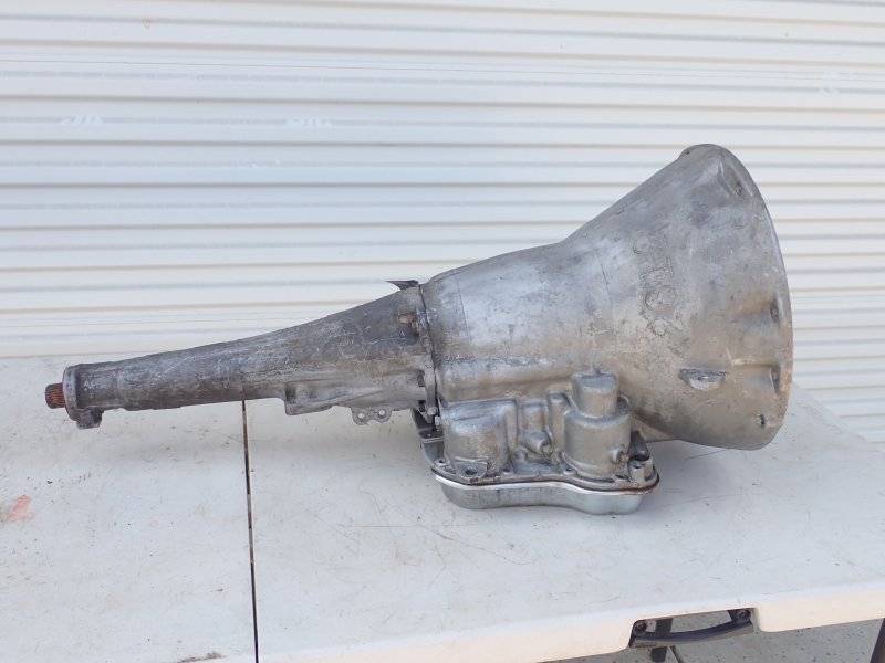

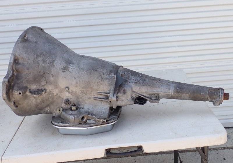

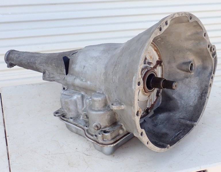

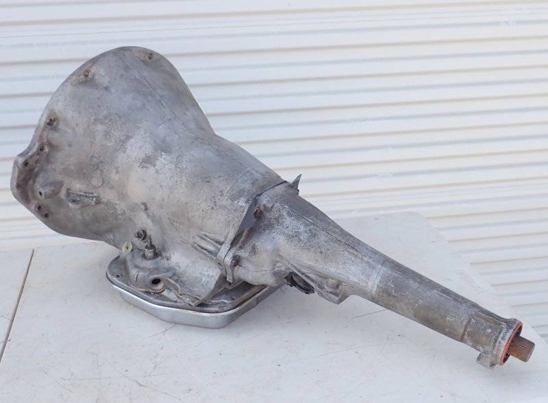

I'm hoping you guys may be able to help me out. A friend of mine recently brought me this 727 trans that was found in a estate garage clean out. The rumor was the past owner had a Hemi car but I didn't think much of it. When I looked the trans over, I saw a few numbers on the pan rail and googled them. It looks like the J2801544 shows this came out of a 67-68 426 Hemi car? I also found the stamping on top of the bellhousing that reads, "8A179110". I believe this is the partial VIN of the car it came out of. The friend who brought it to me wants me to sell the transmission for him. I'm hoping to find the car the trans came out of so I can reunite it with the car. I'm mostly a GM guy so the Mopar lingo is more of a second or third language for me. Any insight is greatly appreciated.

You are correct on the partial VIN. It was in a 68 car. I don't have my book right now to verify the 67-68 Hemi trans, but do know that 67-68 did use the same automatic.

There are a lot of things on eBay that are as you say ambitious. For one 68 owner the sky would be the limit, if that car exists. For others doing a correct 68 restoration buying a complete pig in the poke so to speak transmission with correct numbers, my guess 800-1000. Without those numbers it's a 200 dollar core that can be built into anything you want. This is just my opinion and everyone knows how opinions go. Your pictures indicate two things to me. It's sat for a long time, and two it has been into before.

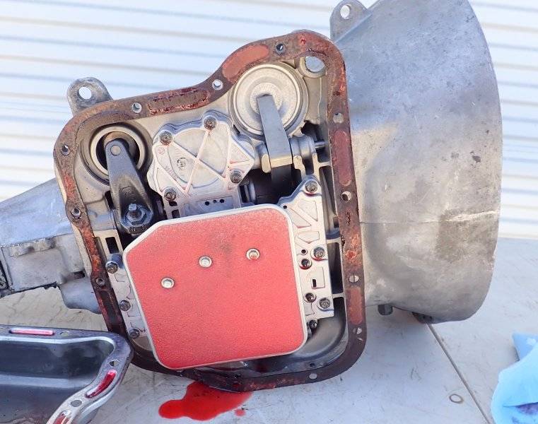

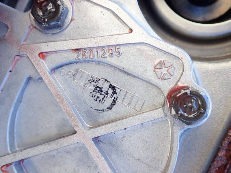

I pulled the pan off the the trans. I don't know much about automatic transmissions but this looks clean inside and the fluid is not burned. There is some debris on the bottom of the pan but it looks more like debris from decades in storage with open orifices rather than clutch material, etc.

Actually I would say it looks pretty fresh and clean inside.
It has a newer valve body in it or at least the rooster comb has been changed. Also should not have a blue pressure regulator spring. Kim
