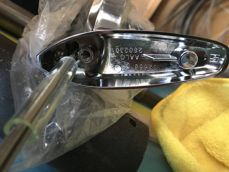

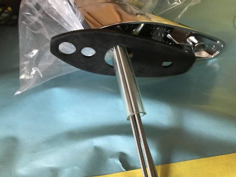

Okay, I tried lowering the plastic tube protecting the cables and then wrapping the cables around the stud and down through the large hole.
That did allow it to fit on the car door and when I tested the remote adjuster, everything worked.
Certainly an odd design.

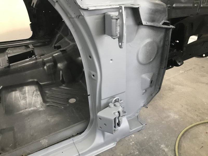

Came back and started correcting gaps, adjusting trunk lid and doors for fit. I marked the location of the door hinges and then removed one at a time and media blast them. Applied primer and then reinstalled them.
In the process of block sanding everything with 320 grit and then wet sanding with 600.
Hoping to get the body painted by the end of the month.

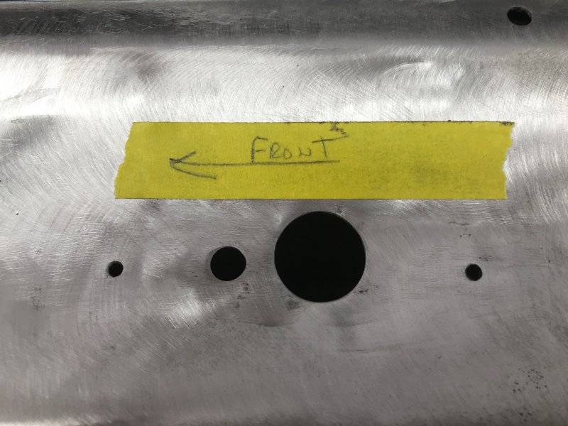

Need some help with this one.
These are the holes in my driver's door for mounting a remote control mirror.
The large hole is for the cables, the next largest hole is for the stud.
The problem is the OER replacement mirror has them reversed.
Then to top things off, the gasket they sent doesn't fit the mirror or the door.View attachment 1453756
I am going to contact them but thought I would post this just in case I am missing something?
My car has 4 driver holes and my mirror does not cover the top one (towards the front). Did you discover what the 4th hole was for?

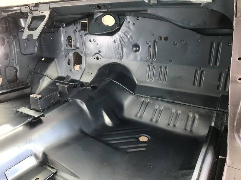

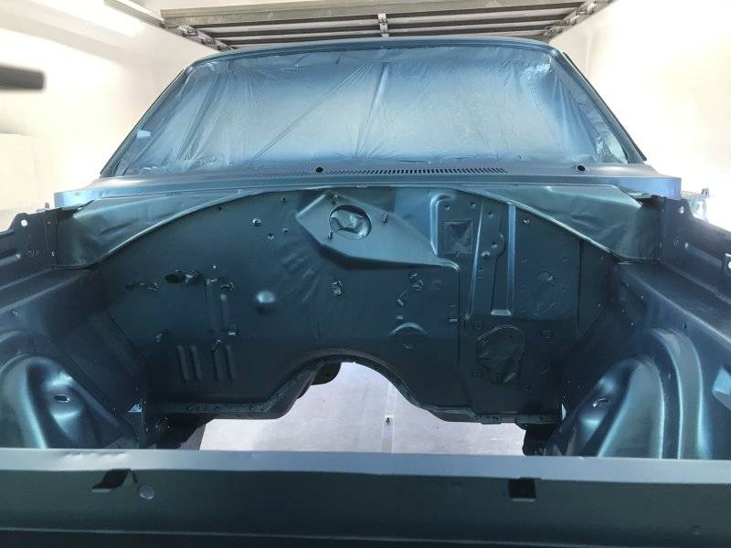

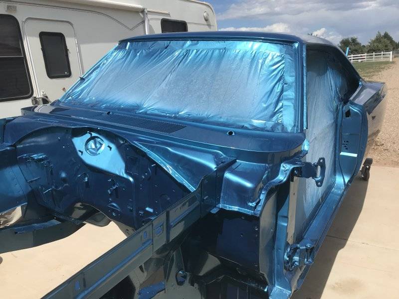

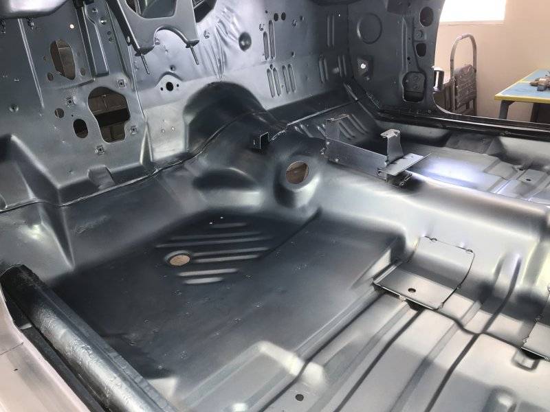

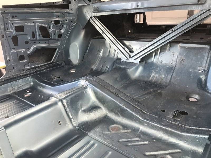

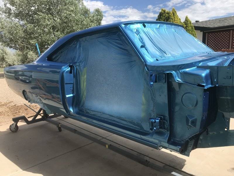

Sprayed the interior metal today. This is one coat of color and one coat of clear since most of it will be covered anyway.
By the way, the color is Frost Blue and looks much brighter in the sunlight than it does in the photos.

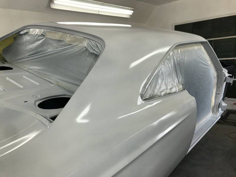

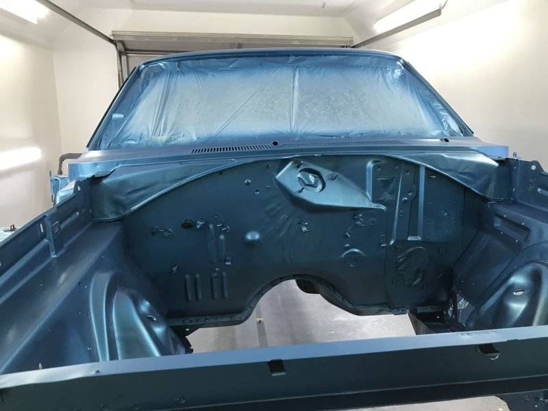

Shot a coat of SPI white epoxy primer reduced 50% for a sealer:
Followed that with 1 coat of base.
Plan is to shoot another coat tomorrow and then let it set, while I wait for my ordered supplies to get here.
Car will get 3 coats of color on the exterior, followed by at least as many coats of clear.

What's the recoat window? Most are max 24 hours or less... Exceeding the window often leads to paint delaminating.. AKA peeling....
There isn't a stated amount of time on the Tech Sheet, however the plan is to spray another coat today and then when my clear coat arrives, I will denib and spray the final coat of color before moving on to the clear.
I have friends that do graphic work and they have let base coats set uncleared for many days, with no issues. Probably depends somewhat on the quality of the base coat being used as well.

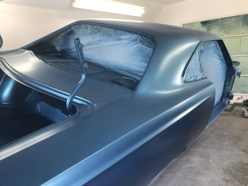

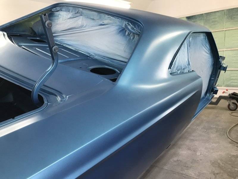

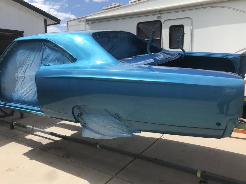

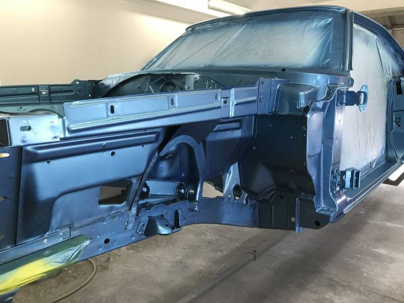

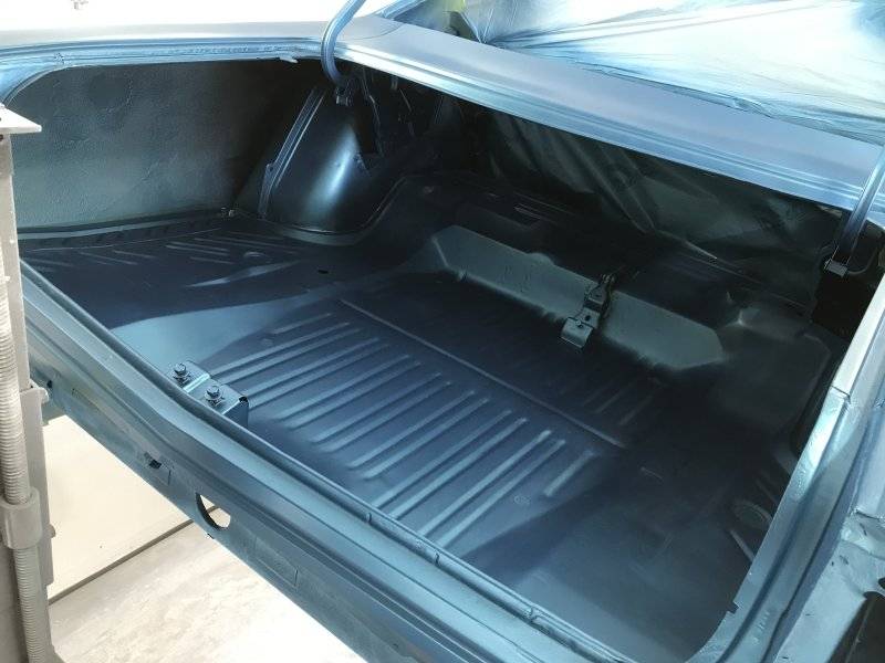

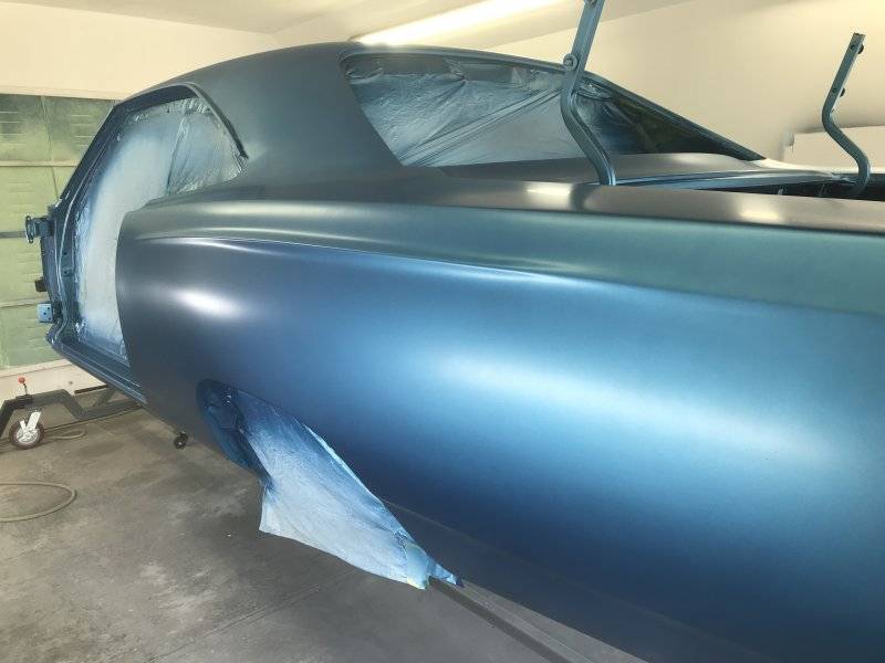

Second coat of color:
This stuff looks weird when you are spraying it. You have to trust your technique and stay consistent with your overlap.

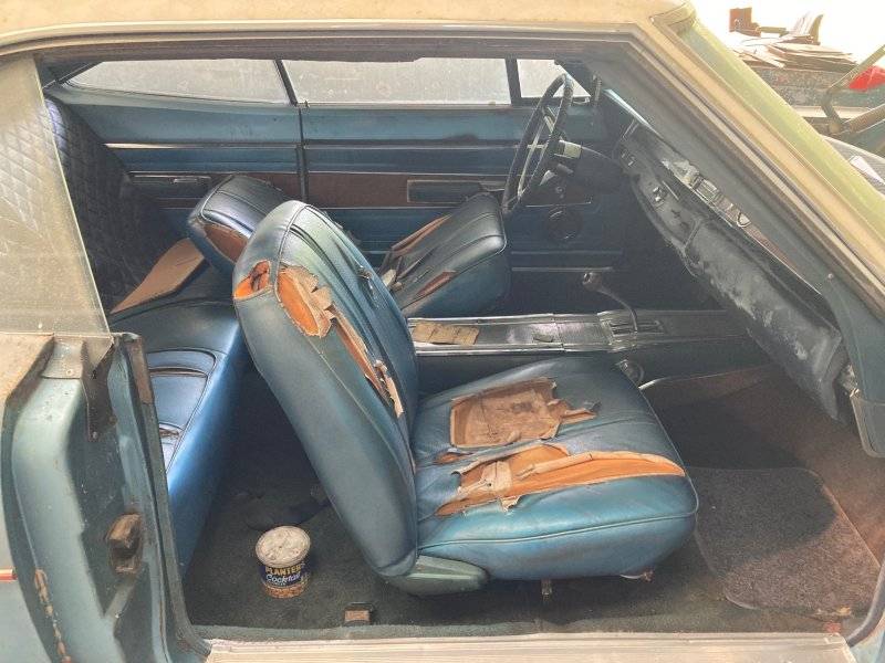

According to the VIN Tag this car came with:
Paint Code QQ1
- First Q is roof color
- Second Q is body color
1 = monotone
INTERIOR: Sport Trim Grade, Vinyl Bucket Seats. Light Blue Interior.
PAINT: Bright Blue Metallic (Dodge), Electric Blue Metallic (Plymouth).
OTHER: Light Blue Metallic (Dodge), Frost Blue Metallic (Plymouth) Upper Door Frame Color. Blue Horizontal Sport Stripe.

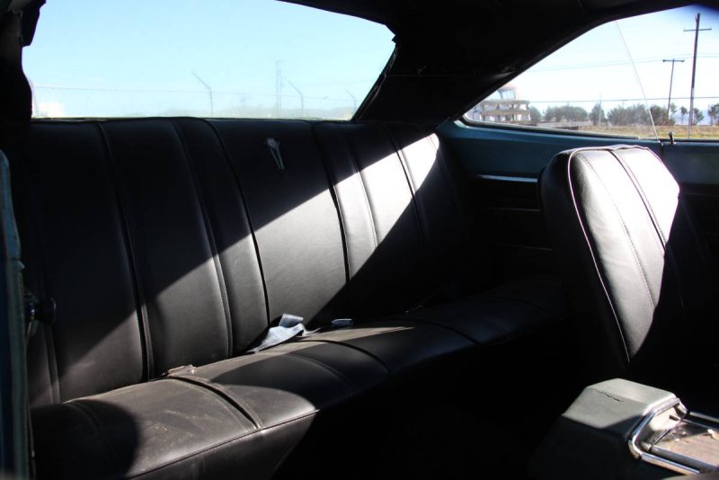

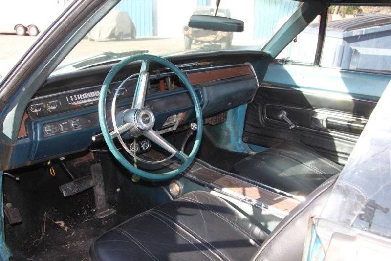

Someone had redone this car with black seats and a '69 console top. They also repainted the car in some areas.

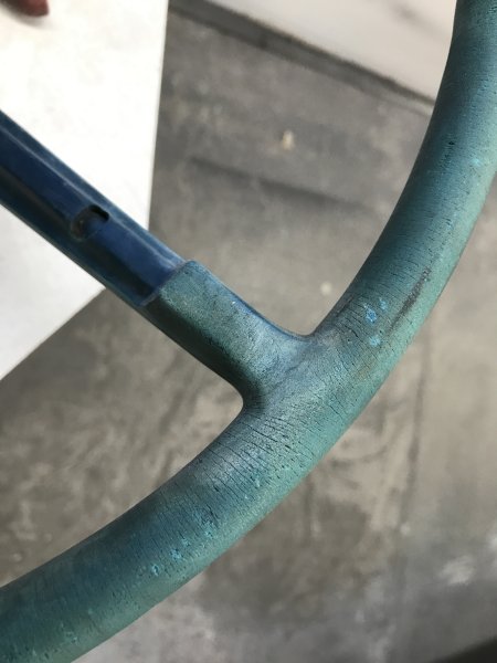

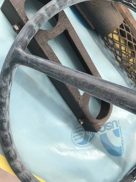

Decided to work on my steering wheel.
It started out very dry and cracked.
I tried spraying two coats of epoxy primer on it and sanding it down but it wasn't enough build:

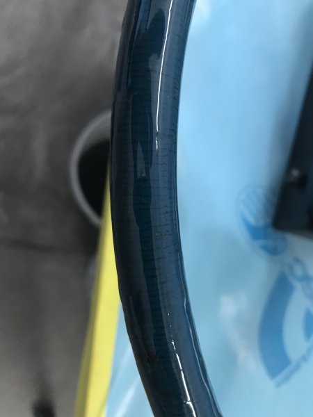

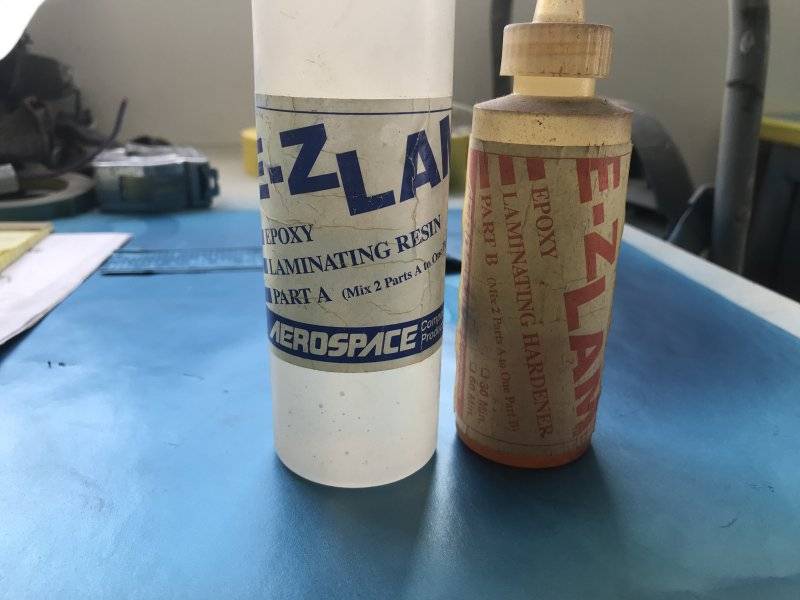

I then remembered I had some E-Z Lam clear epoxy that was much thicker.
So I mixed up a small amount (a little goes a long way) and applied one coat to the wheel:
A close up:
It has a 30 minute work time and takes a least 24 hours to cure. Once cured I will sand it and see where I am at.

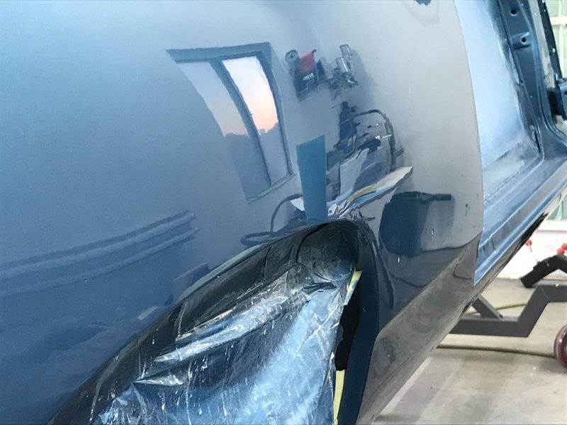

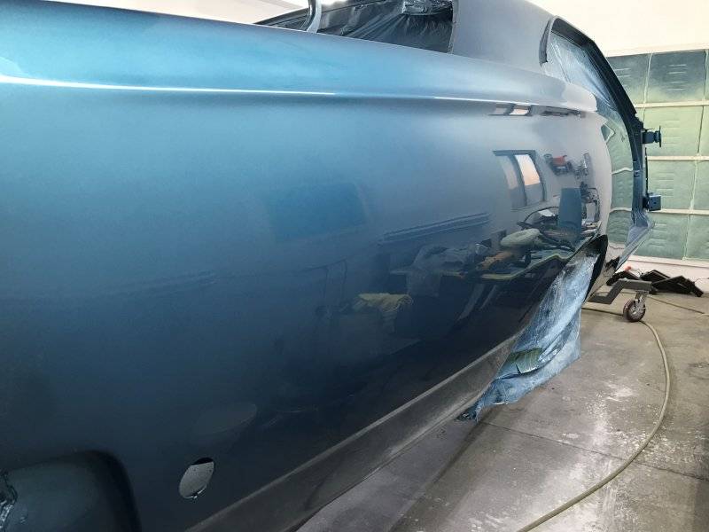

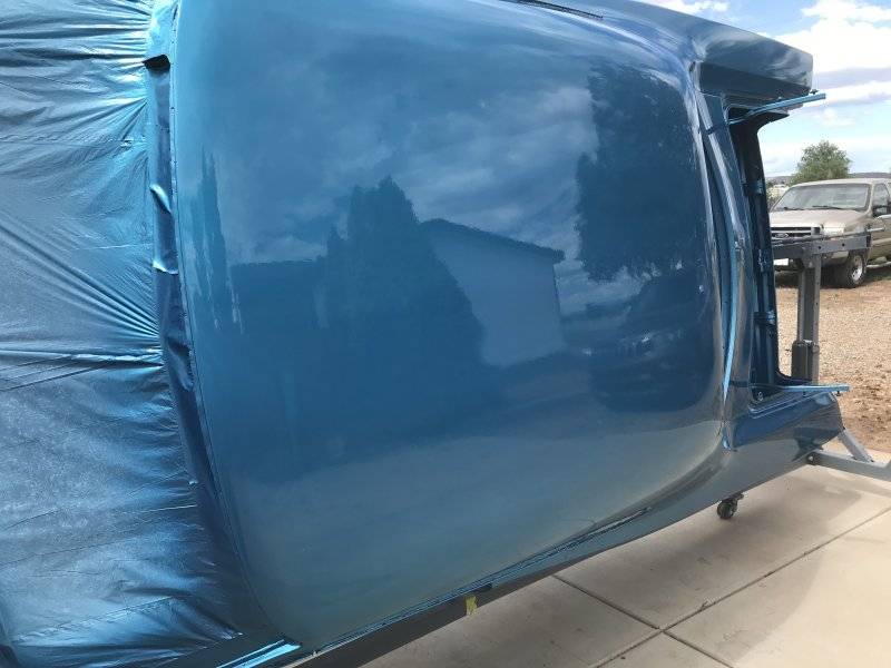

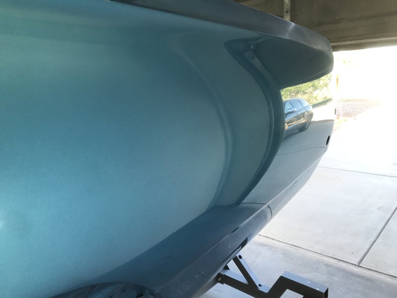

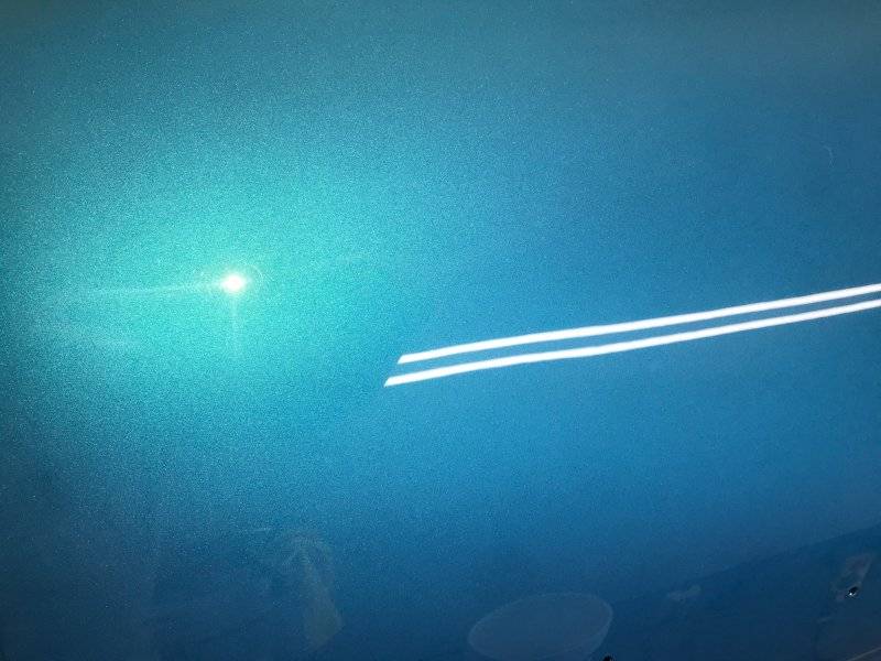

Decided to cut and buff the side of a quarter panel today, just to see how things will look.
Wet sanded with 1000 with a hard block, then 1500 and 2000.
This is the first round of buffing with Meguiars M-100 and a twisted wool pad. I plan to buff again with Chemical Guys and then polish with Menzerna 3800 Super Finish.
Again the two spots on the lower left of the picture are from my camera.
First round of buffing is done. Waiting on my Chemical Guys V36 to get here and I'll go over it all again. Then one more time with Menzerna 3800 Super Finish polishing compound.

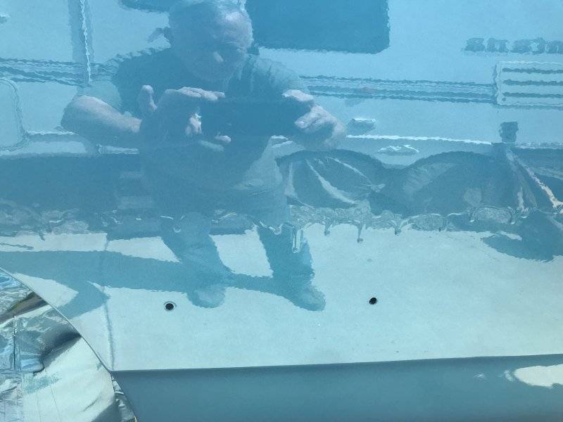

I had a major waterfall run on the front of this quarter panel:
Was able to get it sanded flat and it came out pretty decent:
