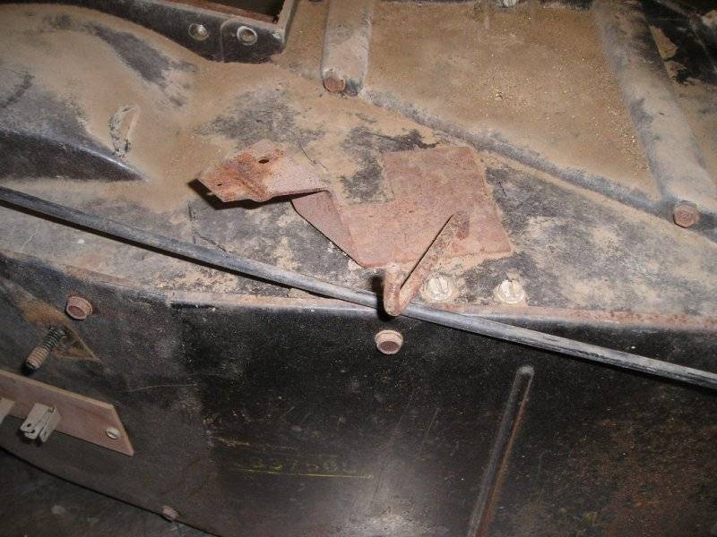

Now I need the temperature control door. :( Turns out the bent portion that the cable hooks to is broken off on mine.
If anyone has a picture of the part, that will help as I may need to repair this one.

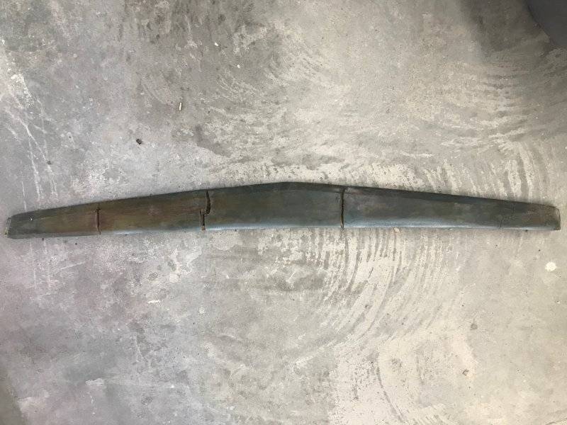

Some progress on the dash pad restoration.
Started with this:
Removed the loose vinyl and foam (a dirty and time consuming job) and then filled the cracks and voids with expandable foam. Removed the excess with a saw blade and sanded the foam level to the surface.
From there I applied filler and sanded everything flat and smooth. It took repeated coats of filler due to deformed areas through out the pad.

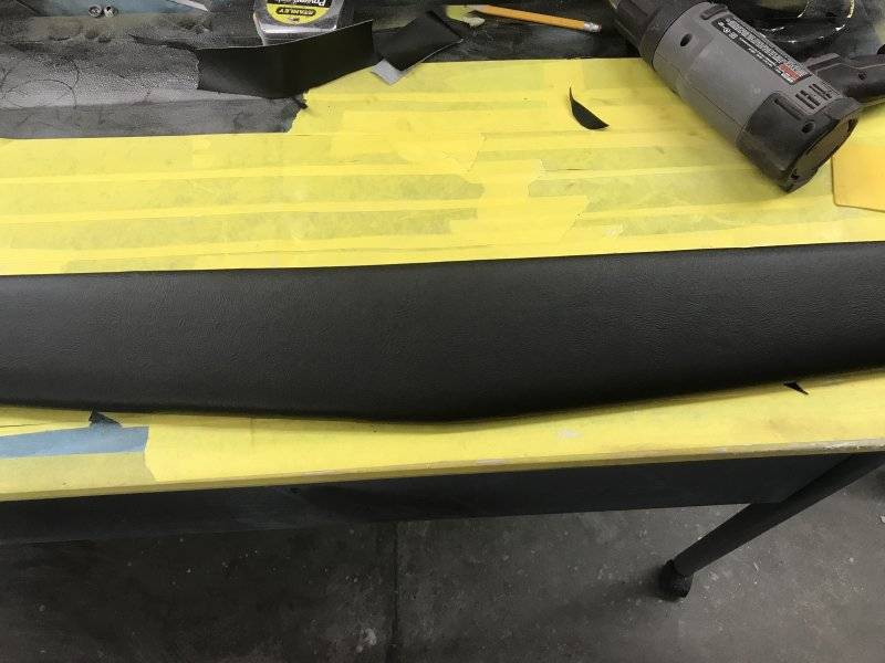

I have enough vinyl for three tries at getting it right. If everything goes as I hope it will, then I plan to restore this other old pad I saved from my signature car and then selling it.

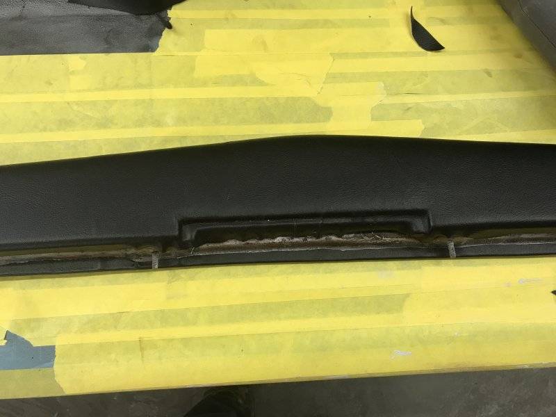

As you can see it is in much worse condition and may require installing new foam as well:
I'm assuming losing the step detail on the upper front edge of the pad was deleted because it would be hard to get the vinyl to stay bonded?
Whatever the case your pad looks damn good...
I tried to keep it but the old pad was such a mess, especially after hacking all that hard, brittle vinyl off, that I couldn't get it to look uniform.
I think the way to accomplish carving the contour into the foam would be to create a jig that guides a cutter & the best way to cut foam is with a hot knife...
But honestly it looks great without the contour so as usual I'm over thinking it... :lol:
I tried to find a close up of the repo dash pads showing the step, but most only give you distance shots of their products.
If you'd like I can get you close up detail shots off mine... It's an uncracked original..
