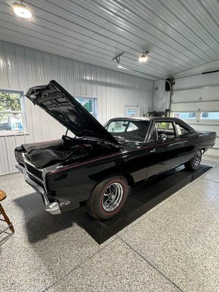

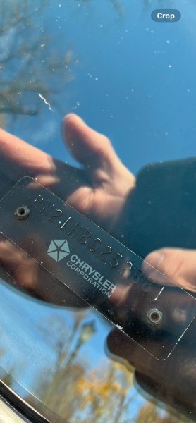

We Have a 1968 Roadrunner Vin says 1968 RR built at St Louis What do the numbers mean on Radiator support and Driver's drip rail also Vin on Trans and Block? Have window Vin Tag
core support and trunk gutter numbers match the number on the fender tag, not the VIN
69 and up used partial VIN in those places
Do you have the broadcast sheet that matches your vin?
We Have a 1968 Roadrunner Vin says 1968 RR built at St Louis What do the numbers mean on Radiator support and Driver's drip rail also Vin on Trans and Block? Have window Vin Tag View attachment 1590652View attachment 1590651
The number on the engine and transmission match the VIN number on the dash.
The numbers on the core support and trunk rail are the Shipping Order numbers and match the fender tag.
Both numbers can be tied together by documents such as the broadcast sheet or window sticker or other not as common dealer/factory documents like invoices.
Numbers everywhere else is Sales/Shipping Order numbers.
--"SO"--
motor and trans stamped near bell housing will match partial vin last couple digits
