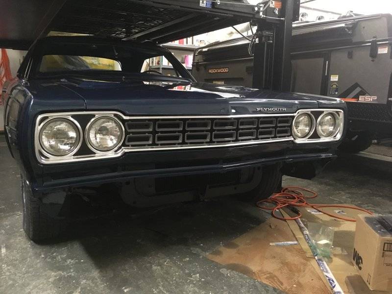

Thanks man! Just some good ol' garage time making due without my old mans lift at his shop. Took a little bit of finagling with the cherry picker in my way to roll the engine under but we were able to slide some stuff around and make it work.
Looks amazing, and glad to see its finally coming near and end . Thats got to be a good feeling in itself

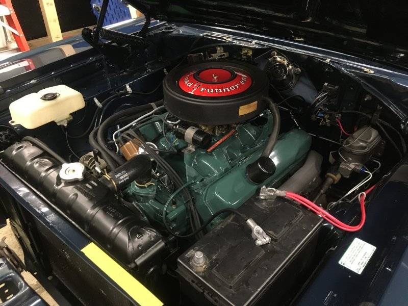

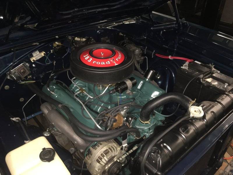

Got the thing fired up this past week and got the seats and such in. Got a leak out the thermostat housing which I can reseal and a nasty exhaust leak that I swear I have a cracked manifold over. I’ve chased the flange again and again and also tightened the studs on the manifold and it has a gasket on it. It’s got a nasty exhaust tick coming from the manifold and I know they are known to crack so maybe it’s cracked….this week I will yank it off and check it out good. Always something with this car it just keeps fighting me. Spent some time cleaning grounds as it was overcharging and that fixed that issue with a bad regulator ground. Also had a timing issue where the timing at idle was fine and when rev’d it just lost timing marks all together. I believe the plates were sticking but I had just grabbed a like new 383 distributor last week from here so I said screw it and threw it on. That fixed that issue so now it charges fine at 14.6v and timing is at 10 idle and 35 total. I will curve the distributor once I get it all done and drive it a few times and the kinks stop driving me insane ha! I will win I always do haha! Took it down the driveway and did a big burnout in the driveway so that was a win!

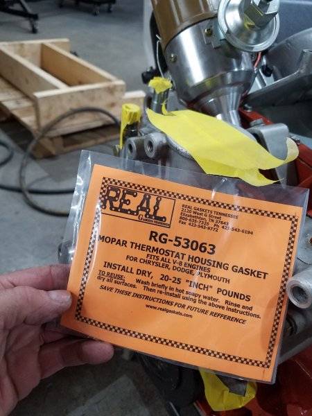

Asshole move of the week here! :BangHead::lol::rofl: So I go look tonight as I dump the coolant and tear off the thermostat housing to see that the gasket that Mancini sends with their water pump install kit is soaked in coolant. It seems like it wicks coolant as it was soaked in it and peeled right off all soggy. I decided to use a felpro blue gasket which I have never had as issue with using that and RTV on it. I used RTV with the mancini deal too but it was leaking all around. Not the asshole move though......so I tear the manifold off looking into why I have a huge *** leak between the block and manifold. Lone behold I missed a piece of gasket that was glued to the manifold and that caused a huge leak! So in my defense this was welded to the manifold and extremely hard to see as it even had the same texture and rust color as the face of the manifold did so I had to look real hard. So there's the asshole move of the week from me and hopefully tomorrow when I fire it up with the new flange gasket that comes from summit it'll be quiet, leak free from exhaust and coolant, and all is well again. Even those who do this alot can "F" stuff up here and there ha! Gotta laugh and keep it light before I lose my mind. Hope someone gets a good laugh and learns something from this too!
As far as thermostat gaskets, have you guys seen these gaskets before? I have used them on 2 motors now with no leaks at all. No RTV required.
Lighten up, it happens to the best of us, China junk gaskets don't help.

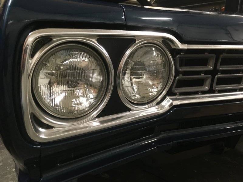

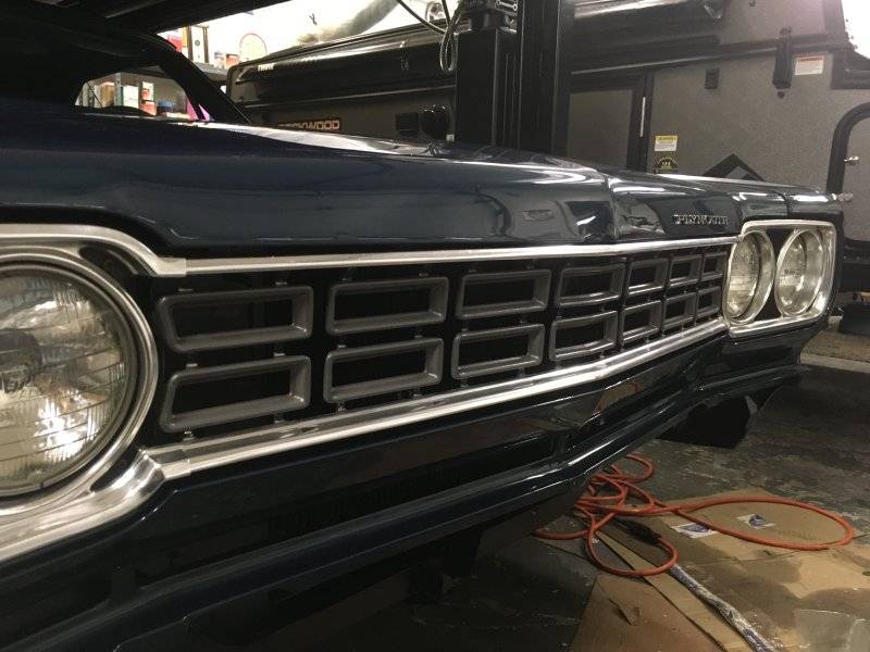

Got the exhaust leaks fixed up and everything runs good now it’s time I guess to put a couple more finishing touches on it and then start putting **** away for winter. Tonight I spent two or three hours and masked off the headlight bezels and the center of the grill bezel and painted the dark argent on the middle and then black accents on the bezels. What a pain in the arse to mask those bezels off but I’d say they turned out pretty damn nice.
Got the exhaust leaks fixed up and everything runs good now it’s time I guess to put a couple more finishing touches on it and then start putting **** away for winter. Tonight I spent two or three hours and masked off the headlight bezels and the center of the grill bezel and painted the dark argent on the middle and then black accents on the bezels. I’d say they turned out pretty damn nice.
