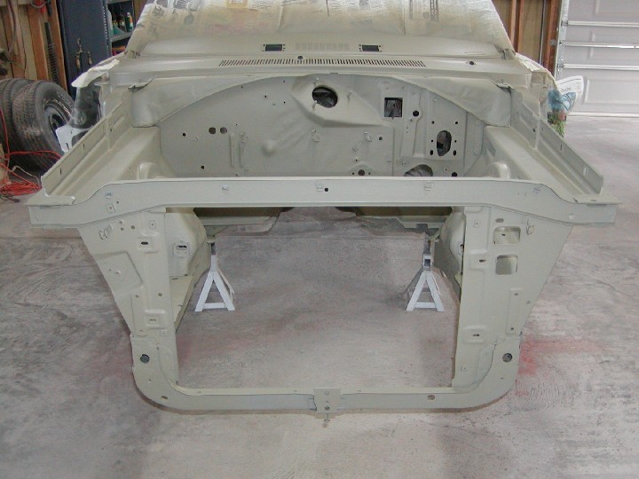

According to the tag, this looks like a rare EE1 car with a 3:55 Performance Axle Package. Also coded for a white tail stripe and black gut, F70 steel belted redlines, AM radio, & April 19 SPD. With a set of road wheels, this should be sweet when done! It does appear however from the picture on Ebay, that the core support is 22". All Axle Pkg cars should have 26". Have you matched up the tag with the core support & trunk lip? Was the core support changed at some point?
The previous owner mentioned it was. He said the gentleman that owned it before him swapped it out and cut out the core support number and it's around his place somewhere. The gutter numbers match. How can you tell it's 22"? I'm young and naive, please teach me!
The width of the opening in the rad support is smaller with a factory 22" rad.
No problem! If the tag matched the trunk lip, that's cool. As you said, the core support was likely changed at some point due to a fender bender? Anyhow, AMD is reproducing the 26" core support. I have not seen it personally, and have not heard any feedback on it, but most of their stuff rates a B or B+....Some better, some a little less. Almost all of it will require a bit of massaging here & there, but all in all, AMD is good stuff.
As far as how to tell: As mentioned, the 26" opening is (obviously) larger from left to right... With a 26", you can tell this by looking at the passenger side edge as it begins right under the curve at the top of the support. The drivers side edge is the same in either 22" or 26". I will try to post a couple pics tonight for illustration.
Here's a pic of a 26" core support....notice the passenger side edge is moved outward. The driver's side is the same as a 22".
