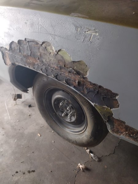

My biggest concern at this point is the bodywork and sheetmetal repair. I'm willing to learn and invest in what I need to, but am curious just how far I'm going to need to dig myself out on this, and if it's feasible for a sheetmetal newbie to pick and learn? not going for a show car here, just a good looking weekend driver. Picks below. I realize some parts are available as reproduction, and some will not be. I suppose I'm asking for the experienced community to guage the level of difficulty with the body work here? More to come, thanks.

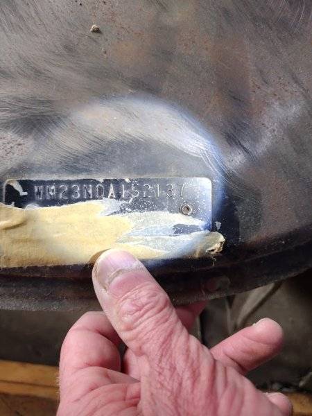

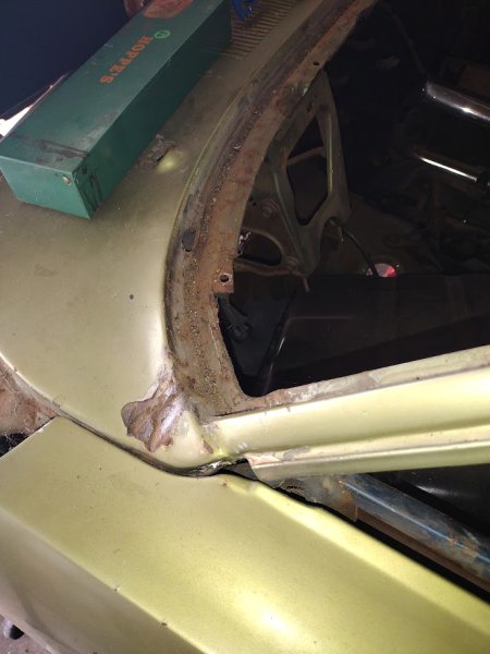

Gotcha; Fender tag I cannot get to at the moment, but originally came with 383, PS, no AC, and PB I believe. Here's a pic of the vin. The pics show the best and worst: lower cab corner is worst of all, floors are good I'd say, truck floor has some holes, and most body panels are whole with some rust through on the flanges.

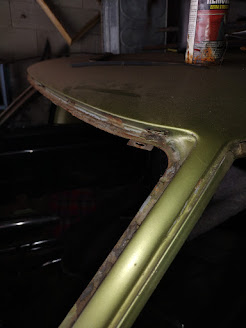

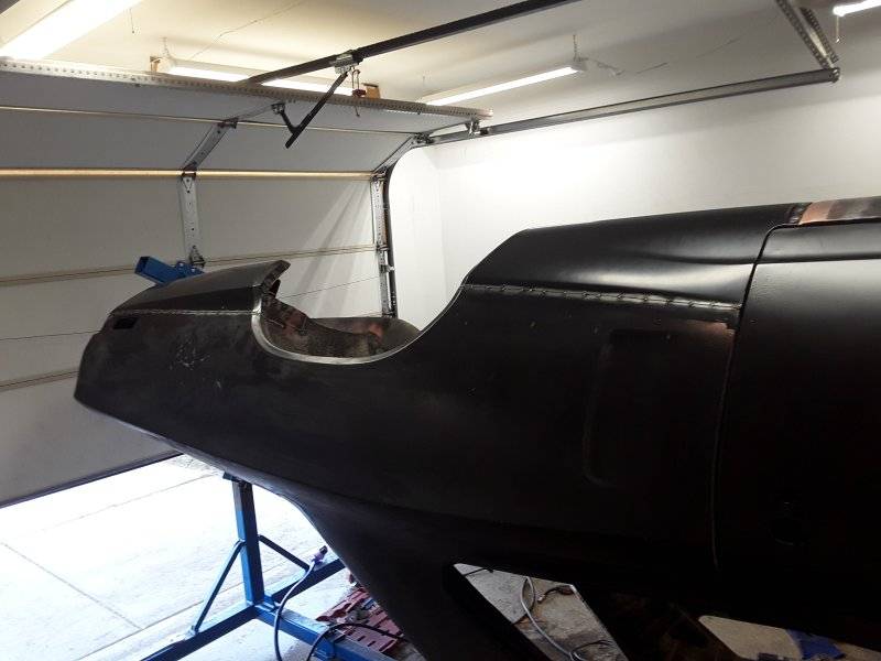

The 69 quarter panels do work very well to repair 70 quarters. I used AMD 69 quarters and cut off the lower quarters and the rear window corners and butt welded them onto my 70 quarters and they fit very good. I am not sure how I feel about putting the whole 69 quarter onto the 70 though. The shoulder of the quarter panel has a sharper radius on the 69 than the 70. I would do everything possible to save the upper 2/3rds of the original quarter panels if you can. It would be helpful to buy a 69 AMD full quarter and a 70 skin and once you know what you are looking at decide the best plan of attack for that passenger side quarter that looks real rough on your car. Watching Junkerup on youtube, getting some Craig Hopkins CHP videos, and going through the project car galleries on MCR (Muscle Car Restorations) website helped me a lot.

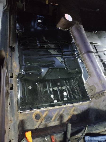

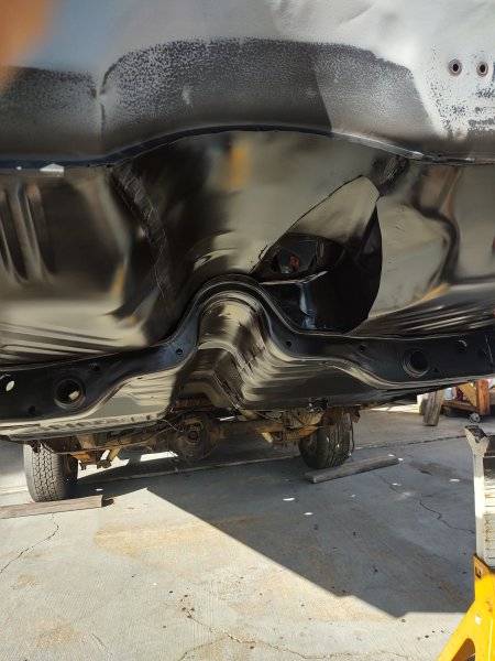

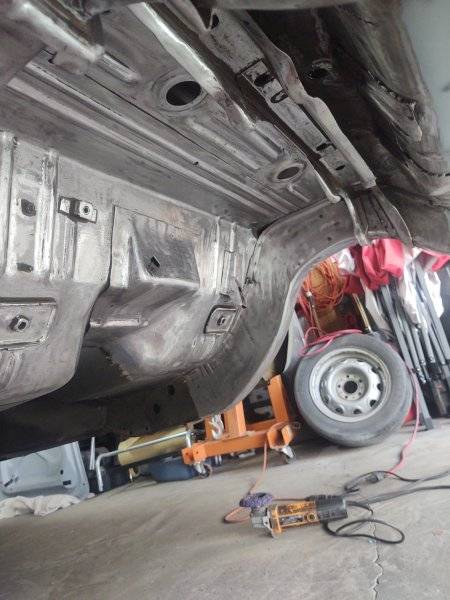

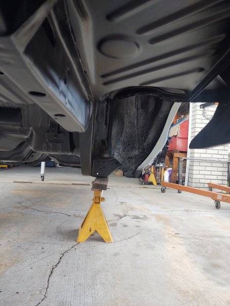

I think I can put my $.02 in here too. I started exactly what you are, about 2 years ago. I pulled the interior, exterior body panels, and glass out. MY car needed floor pan + extensions. It needed all front pans up to the rear seat ledge. It needed the rear window filler panel AND lower quarters. We are all in the same boat for AMD quarter skins. They don't make them and won't be anytime soon (if ever). There IS a company that does make 70 skins and I can't remember who I got mine from, but I bought them. I suppose the first thing to consider is how much patience are you gonna have? We all know somebody that started and couldn't finish a car for one reason or another and it ends up getting sold. Let's start with an entry level welder like a Lincoln, Miller, Hobart or even a relabeled welder thru Eastwood, Northern Tools or such. You won't need some huge welder with big power needs. I've done all my welding with my Lincoln 135. Autobody is just fine for that. You're gonna grinders, cutoff wheels, sanders, compressor and air tools. You'll see some people have a place or a huge garage to accommodate a rotisserie. I have done mine without and was still able to strip the bottom of my chassis and epoxy it in chassis black from a creeper and engine hoist to lift the front of the car thru the shock towers with eyebolts. You CAN learn to weld on your own with some practice. Take some scrap sheetmetal and practice on that.
The sheetmetal which I got from AMD, with the exception of the quarter skins, fit good but not perfect. You will have to trim, tap and maybe even bend a little to get it to fit perfectly...but that's to be expected. The ONLY issue I had with the quarter skins was 1)- they are looong. Once I had them screwed on prior to welding, I noticed the rear wrap around flange was an inch too long. I had to cut and section that. 2)- I DID NOT have the doors on and was worried about body panel alignment with the quarters and doors, soooo I saved the factory quarter section from the door jamb to right past the body scallop. I knew my factory original doors would line up with the original quarter panel body lines so that's where I seamed it. I also dressed the blind sides of the wheel well housings and had to amke some patch panels there. From what I can see, it looks like you could do patches in most of the areas in your pics. (The quarters--nope) I never knew how INITIALLY how much in over my head I was going to be and I'm speaking of strictly welding skills. I still have to assemble the engine and the rest of the car but it's about ready for paint. I already rebuilt the 8.75 rear and 833 4sp. Yes...I did those myself too. Am I an ASC certified mechanic? Nope. I HAVE worked on cars, especially MOPARs since I was a kid. Now that I'm retired, I do have more time to practice what I've learned!
Don't feel intimidated!! Like someone else said...tackle this one piece at a time. Before you know it, all the pieces will be fixed! You will find...it will be time consuming. I will cost money that you may find yourself having to budget for. Will it cost twice what you think it will? Yeh, probably more than that. I agree with the point being made that will you be upside down on costs vs. sale value? That depends....if you can do 90% of the work yourself from start to end, you'll probably be fine. The more you have to pay for the closer you get to that break even point. If you car was V- code car with the 440 or maybe a hemi car, then it's likely to be a money maker but I would guess a pro would want to do it too. All in all, I wouldn't run away from it. Just do a step at a time and you'll be fine. Money and time permitting. I'll follow up with some pics....
Broaden your skill levels for sure. If you are squeamish about a task, check in with car friends/neighbors/business contacts. Maybe you have a tradable skill to barter with. Minus male pandering of course.:lol:
I don't think I have a pic of the trunk pan but that got done too.

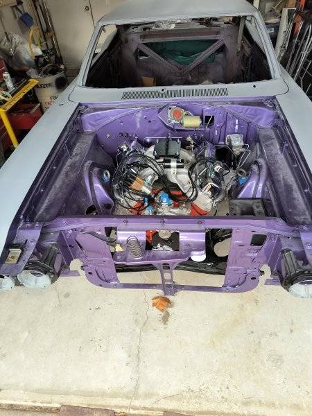

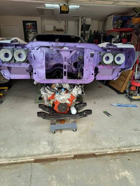

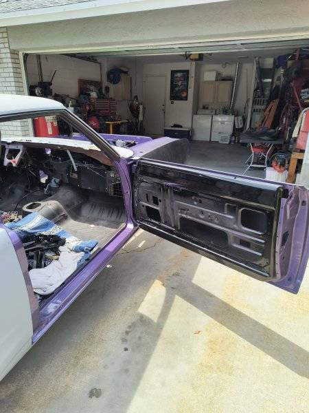

Driver's side fender painted inside; going on the car tomorrow
There you go...this much ahs taken about a year but I don't work on it everyday. The point being...take your time and have patience. It WILL come together IF you still want to do it!!
