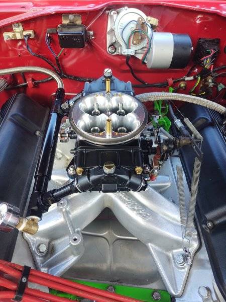

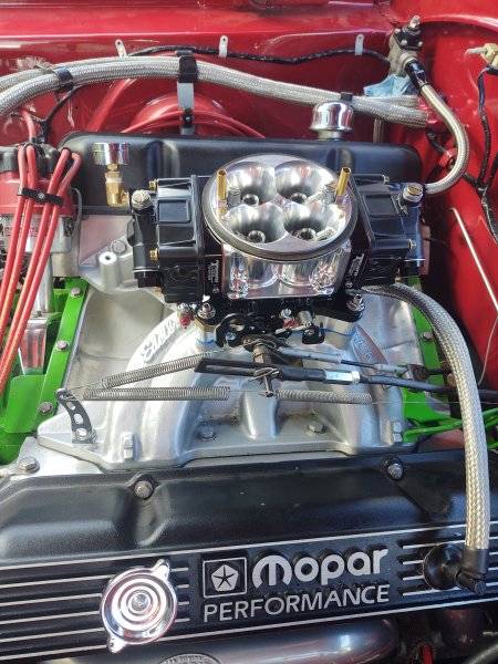

I am using the below manifold, as you can see on the picture the divider is cut down.
If your dual plane manifold does not have this it would be an option to cut yours before going for another manifold.

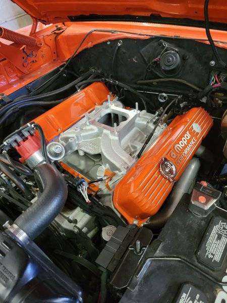

Mopar Performance Dual Plane Intake Manifold
