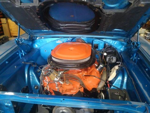

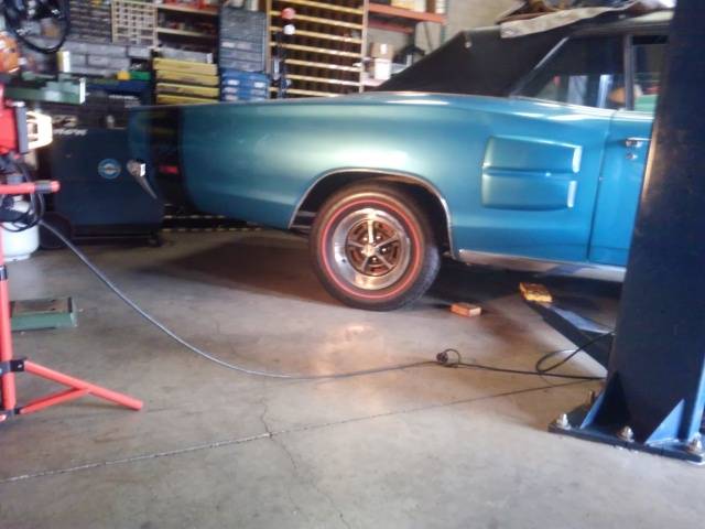

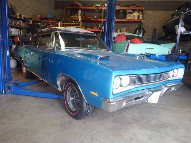

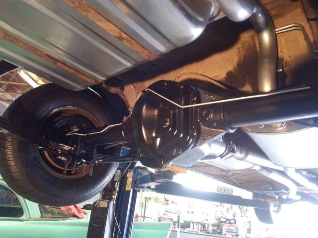

New shocks and leaf springs have been installed. Just waiting on the chrome exhaust tips to come in and we should be pretty much buttoned up underneath the car. :)

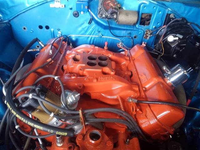

We also decided to take off the Edelbrock 2191 performer intake for the stock intake as it appeared we were going to have some clearance issues on the original N96 ramcharger.

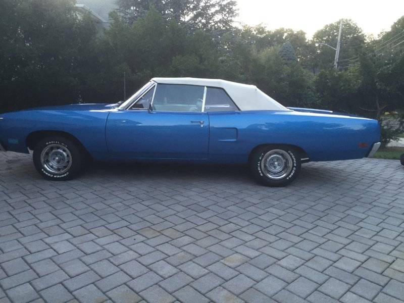

PS- Here's my baby. Top pic is with new 15" tires on Rally rims, bottom pic is with the original 14's on steelies.

Today we experienced a little bit of a setback with the new re-popped master cylinder...she leaked! So back to CI she goes and I opted for a re-manufactured one.
Parts we are still waiting on:
1. Waiting for my instrument cluster to come back from Instrument Specialties.
2. Correct exhaust tips should be showing up tomorrow to replace the incorrect charger ones that were on my car.
3. I ordered a period correct battery that is currently still on back order.
4. Still waiting on the windshield washer reservoir that was ordered to replace my cracked one.
