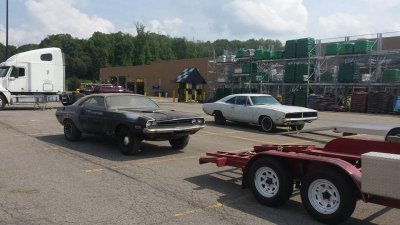

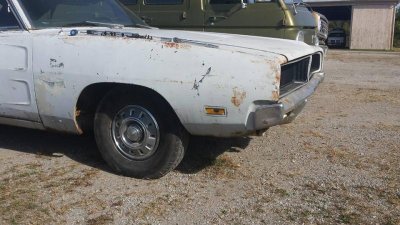

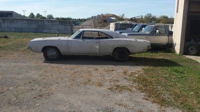

I need to a place to dump all my project pictures so far. probably wont be in a very good order but i havent gotten very far yet on the car. the plan right now is to get it road ready and work on everything else in greater detail as i go. i refuse to have another project car that will sit in a million peices for me to lose interest in like the 71 challenger you see that traded for this car. Enjoy!

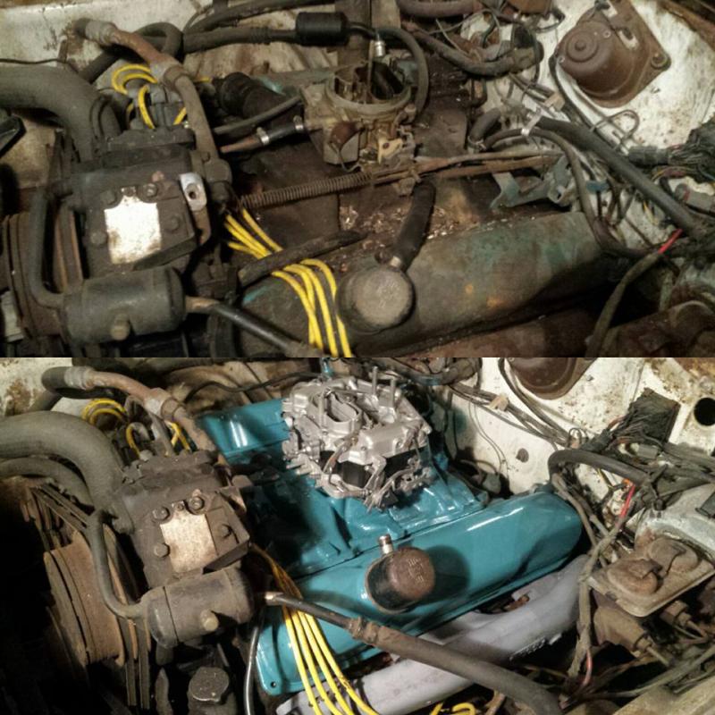

im going to keep it mostly stock. its factory white with a blue interior, 383 2bbl A/C with HD suspension w/ front sway bar but standard brakes and a 2.76 rear gear.
i put a 4bbl intake on it for a little bit more fun along with the HP manifolds.
