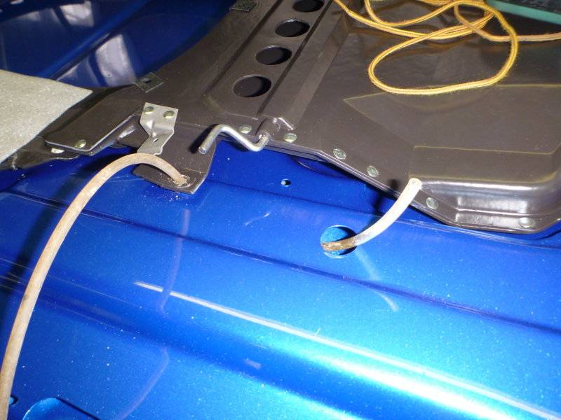

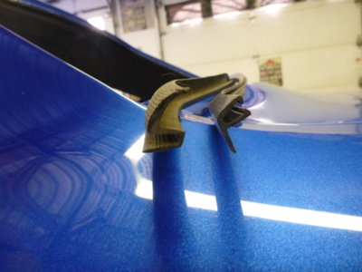

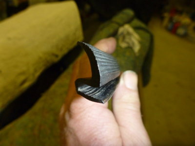

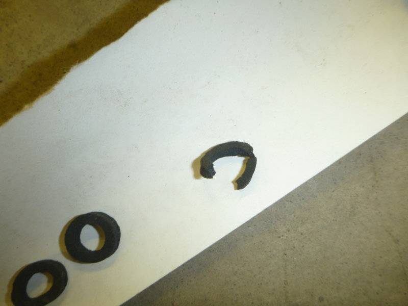

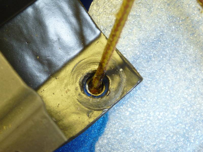

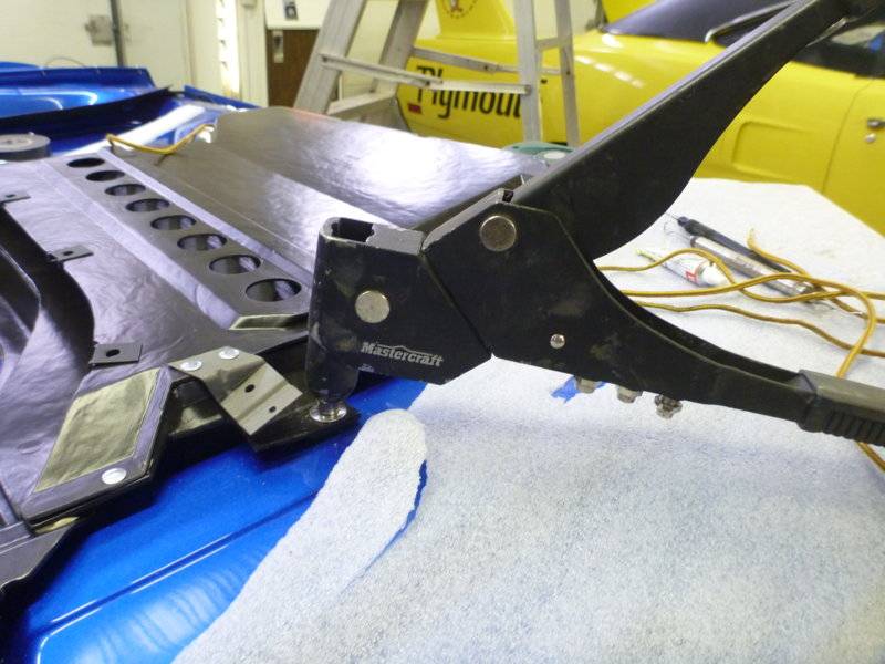

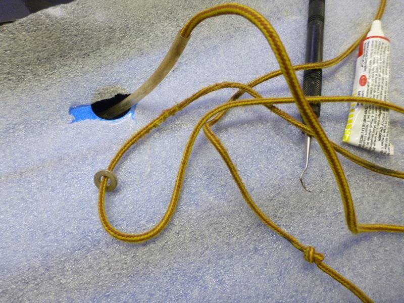

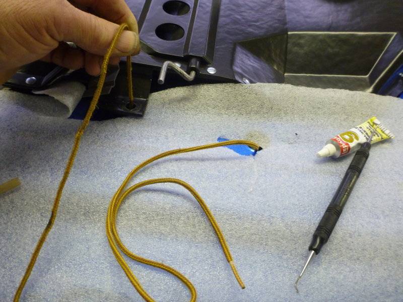

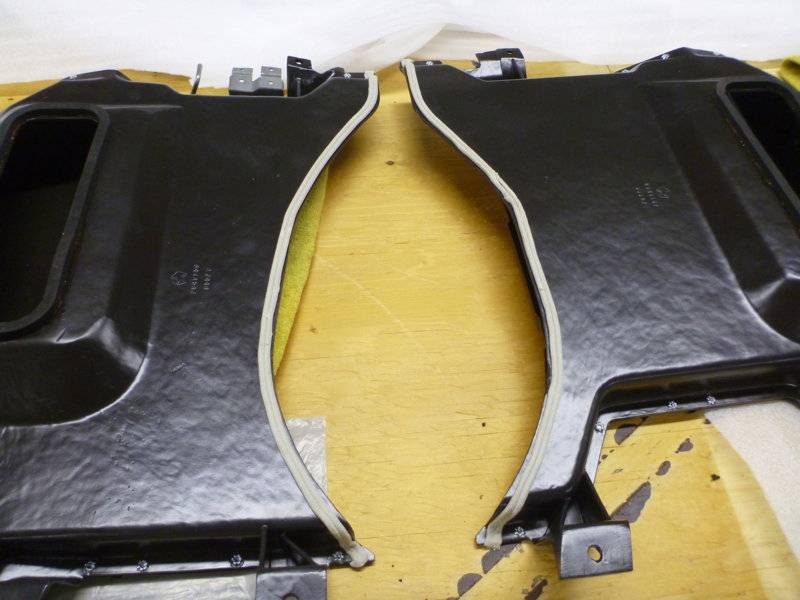

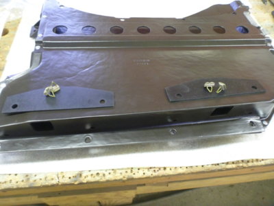

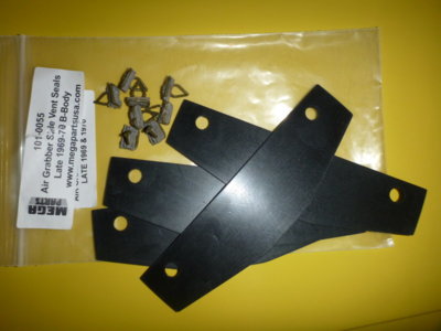

I was just going to cut some rubber from a roll I have and reuse the old clips that I'd already cleaned up. But I already needed something from Jamie anyhow. What's another 30 bucks at this point.

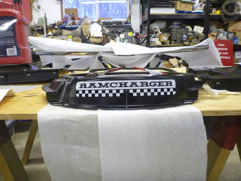

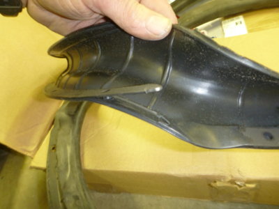

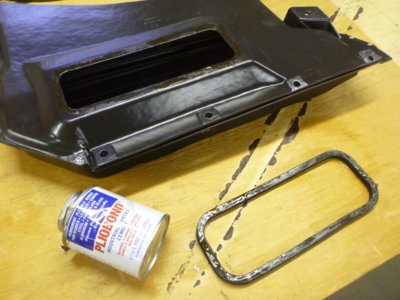

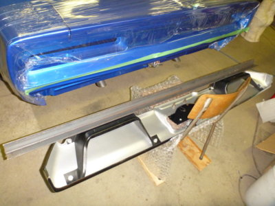

Drain flappers ready to install.

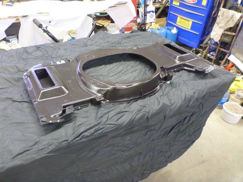

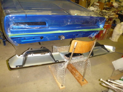

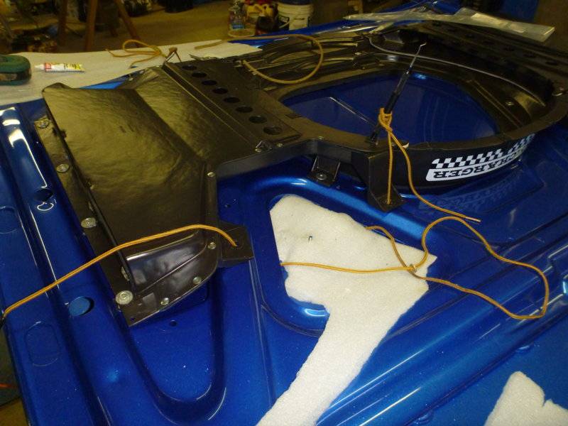

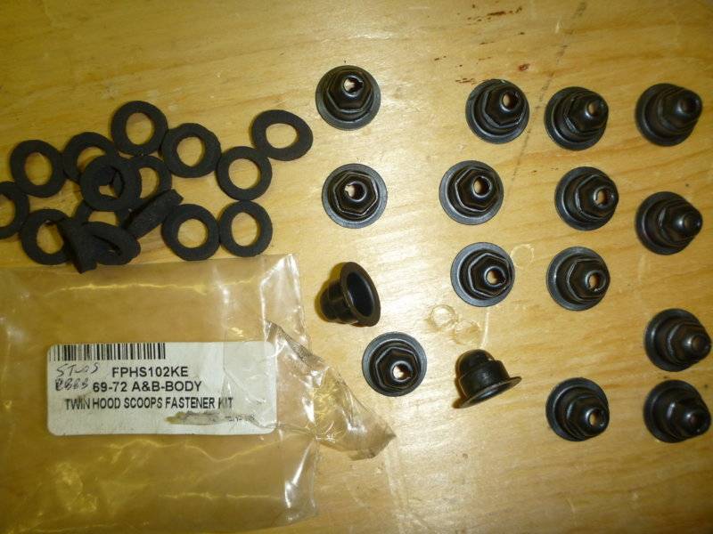

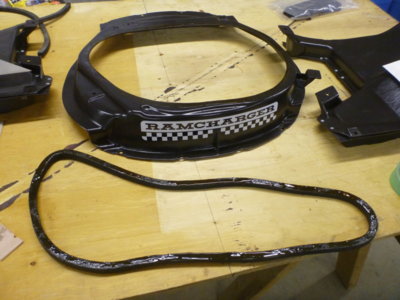

All parts laid out for a photo shoot, ready for foam seals and the Ramcharger decal.

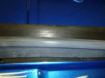

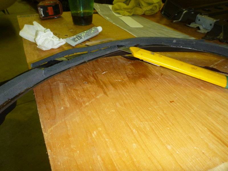

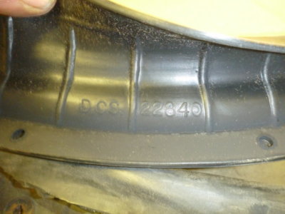

Neat thing about Pliobond, it's the same brown colour as the factory glue residue I cleaned off the box during restoration. It's also a GREAT glue.

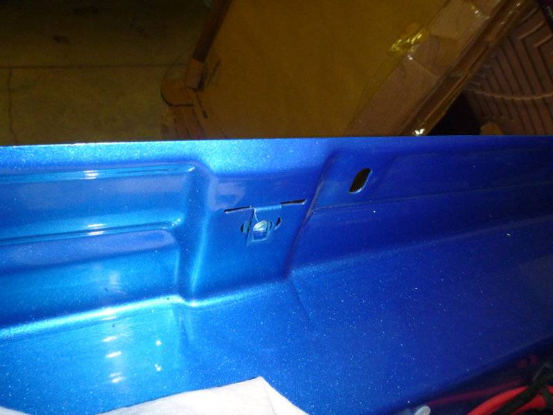

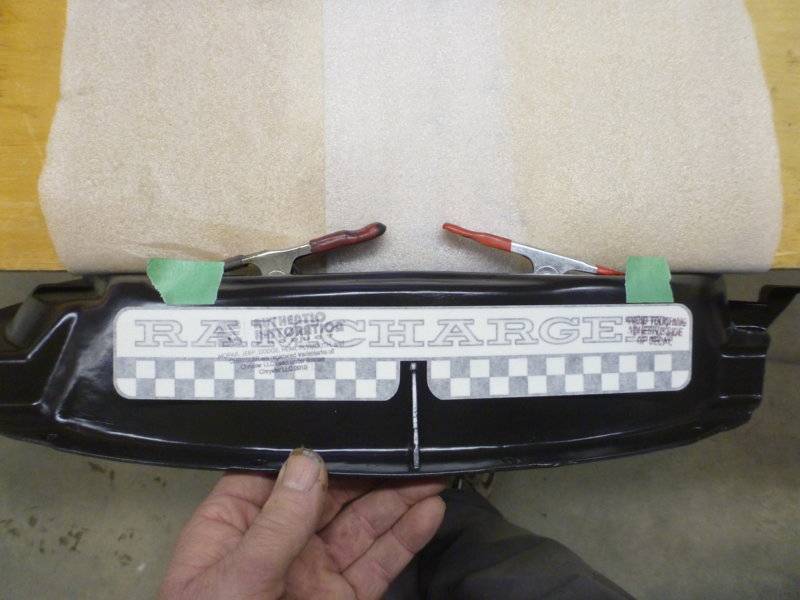

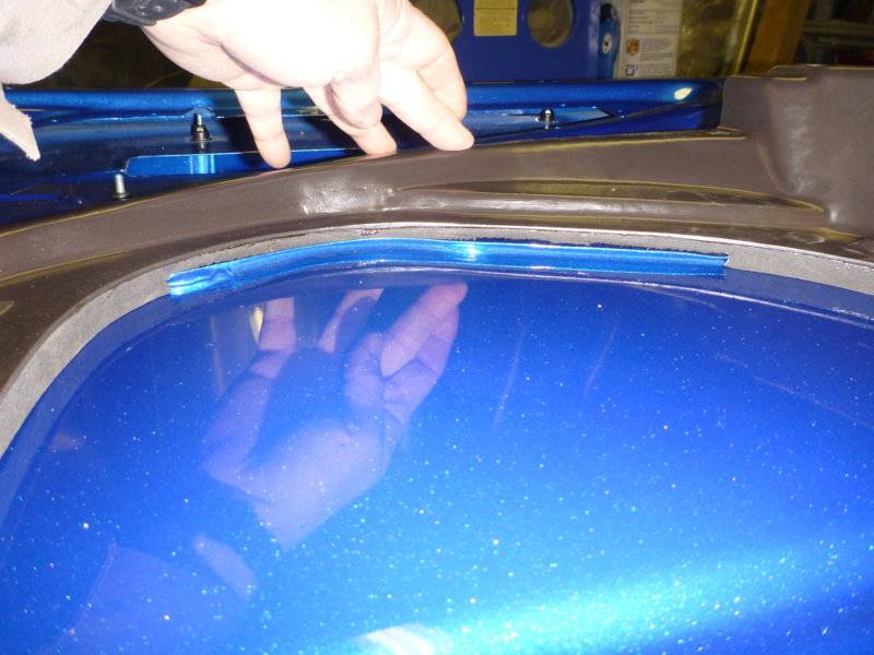

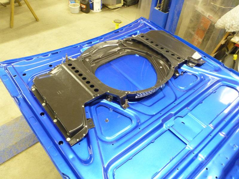

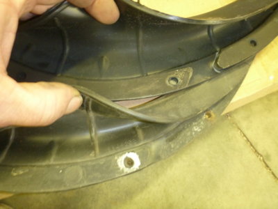

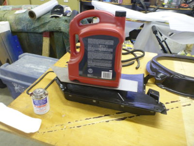

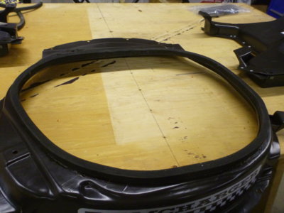

Foam in place and "clamped".

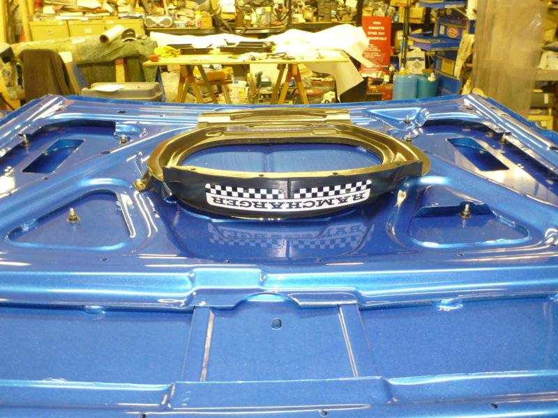

Gonna get one shot at this, better make it straight.

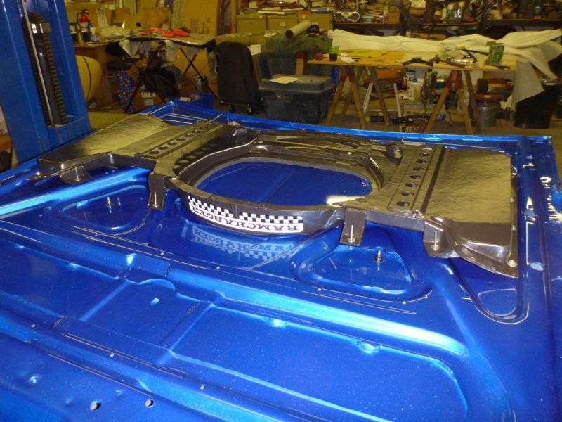

Success. PITA with RAMCHARGER a clear decal to show the box colour through it. Spent 30 minutes coaxing the hazy spots out (air) to get it to look consistant.

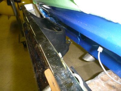

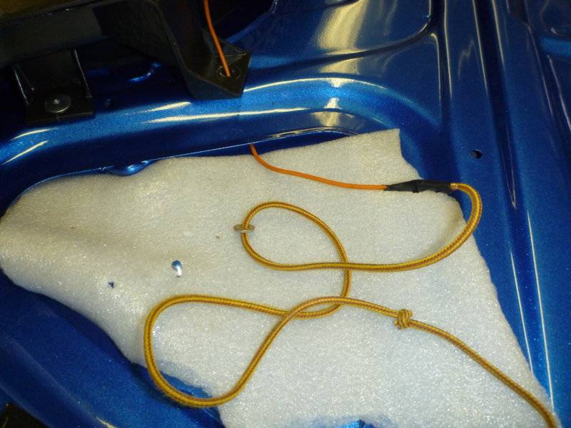

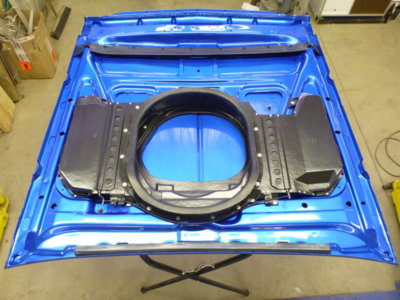

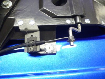

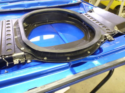

Center box and foam glued up. Same Pliobond.
In place and will trim the passenger side detent in the foam once it's cured in place.

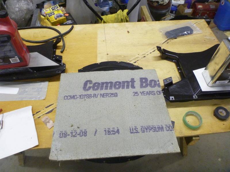

So this is why they call in Cement board!
