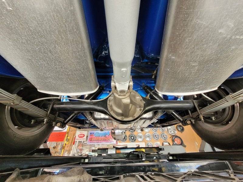

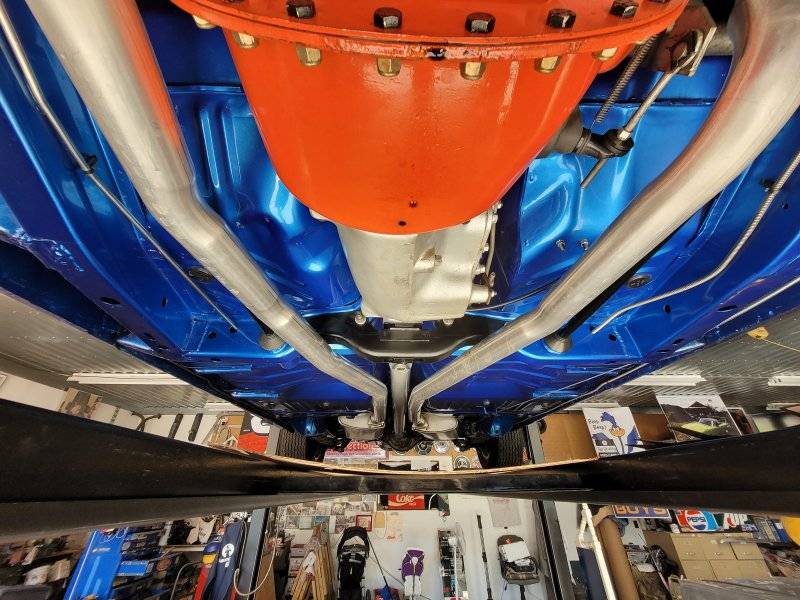

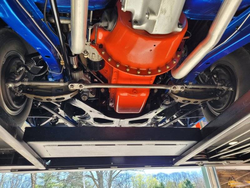

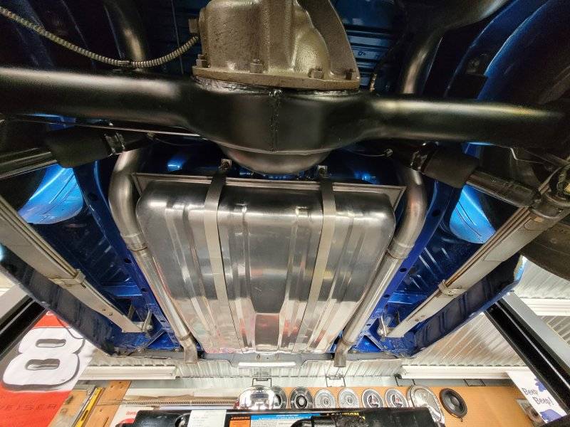

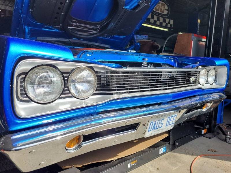

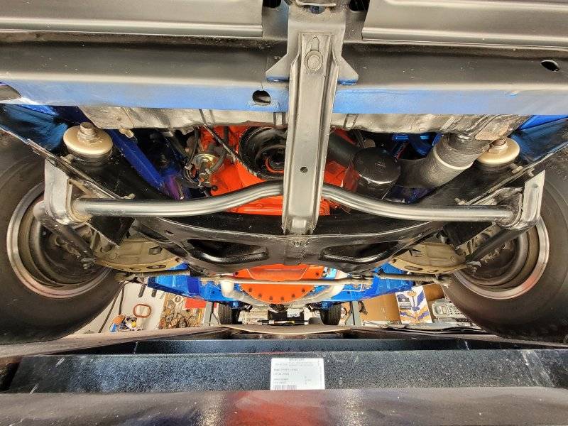

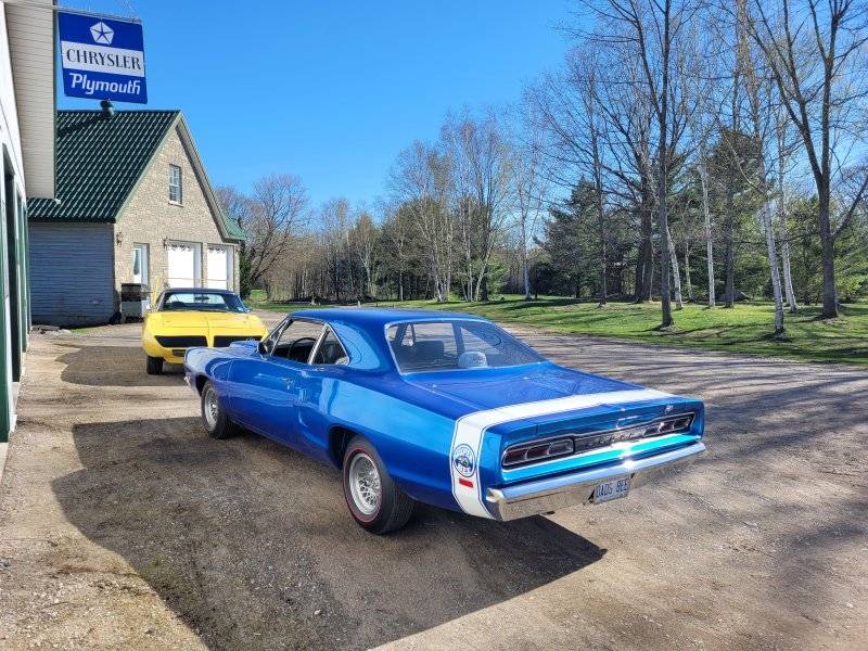

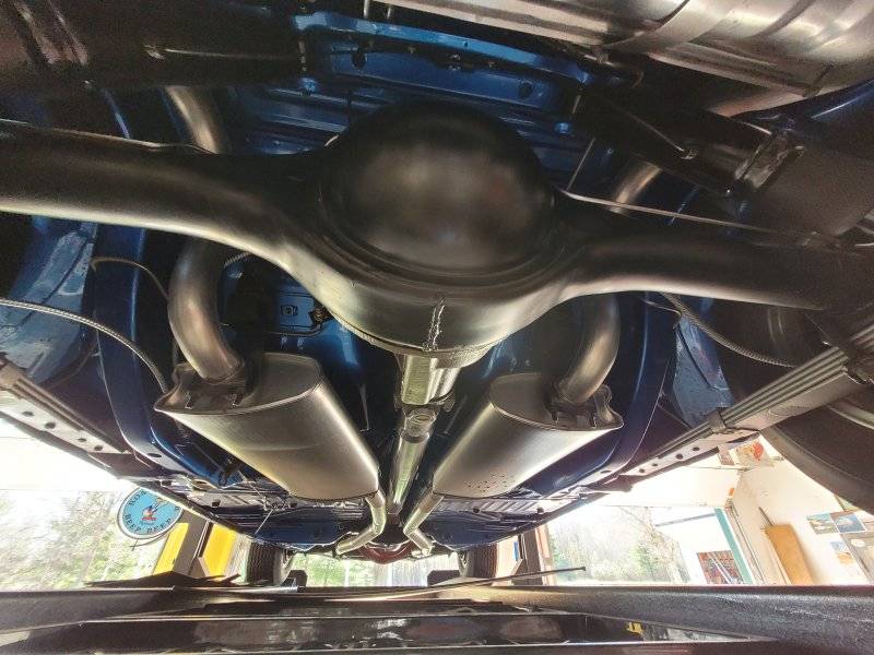

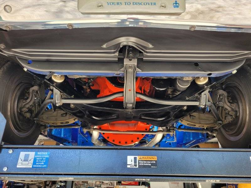

How slow do you drive down that gravel road??5 years since restoration was completed and 8+ since it was started. Guess I got the preservation of parts correct. About 3500 miles and living on a gravel road, Therapy still looks like new. Stored since November and she started on second crank, I didn't even charge the 8 year old Odyessy battery!
View attachment 1656893View attachment 1656894View attachment 1656895View attachment 1656896View attachment 1656897View attachment 1656899
She's doing good for an engine that was rebuilt in 1976/77 for 300 bucks! Always a valve cover gasket. BTW, that's it for drips and they didn't even make it to the cardboard below the car.

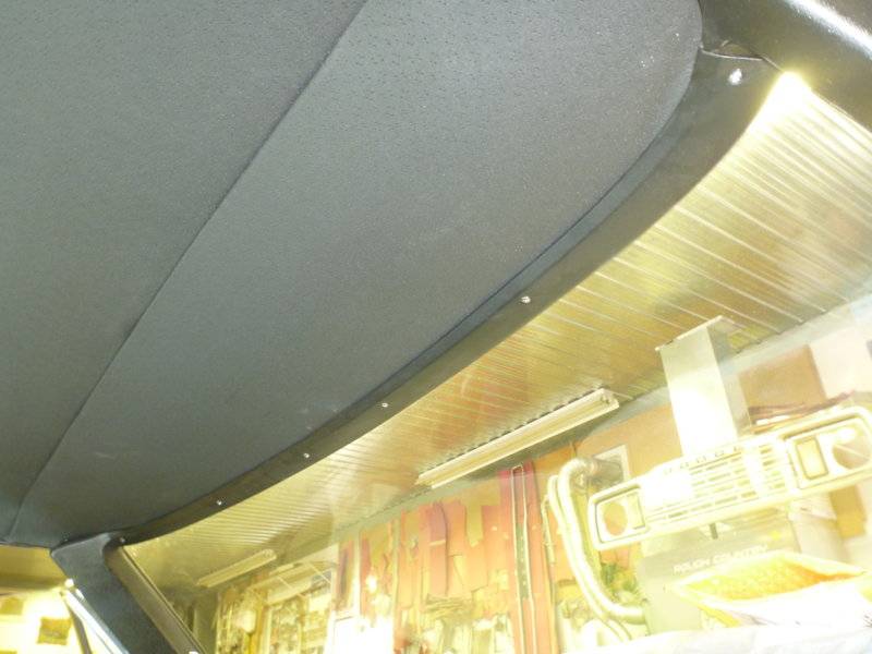

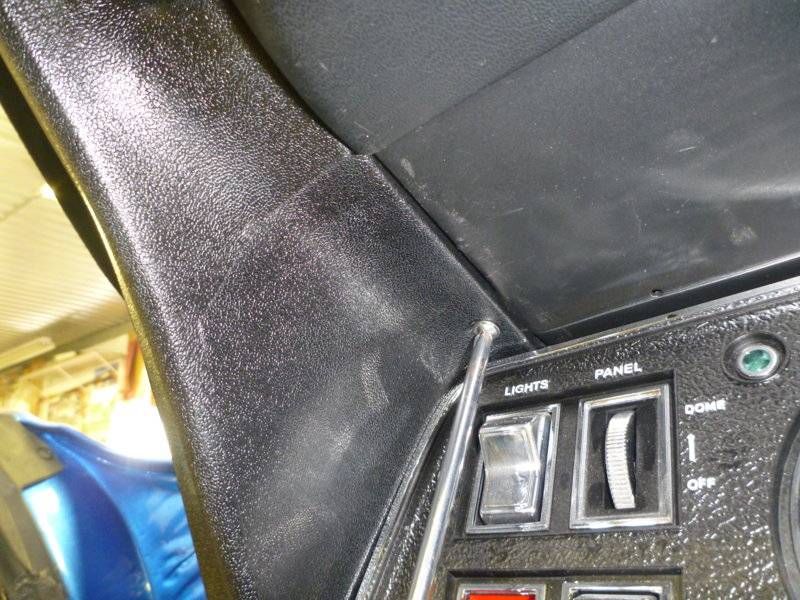

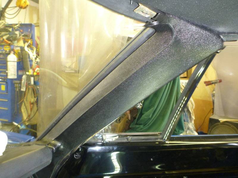

First of all thank you DadsBee for the great postA pillar trim in place.
Drivers side showing the correct #10 washer head screws. The ones in the repro kit had the wrong heads, but you can buy correct ones at NAPA.
Don't miss the screw up under the dash.
Hope you put these windshield trim retainers in before you installed the windshield! (you could get them in now, but wouldn't be fun)

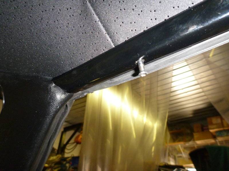

The windshield to headliner trim was previously painted the same flattish black as the dash. It does not get painted gloss TX9 like the other interior trim pieces. #8 x 5/8" oval head screws x 6.
Windshield to headliner trim in place, over top of the A pillar trim pieces.

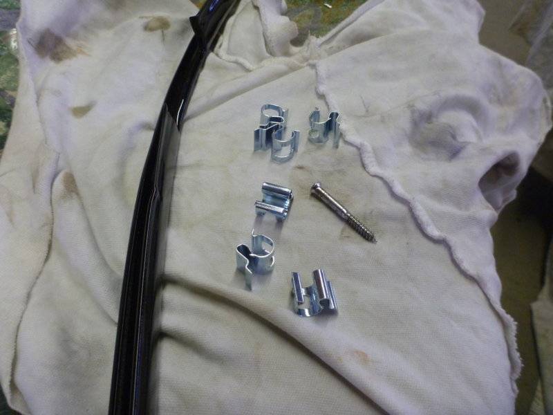

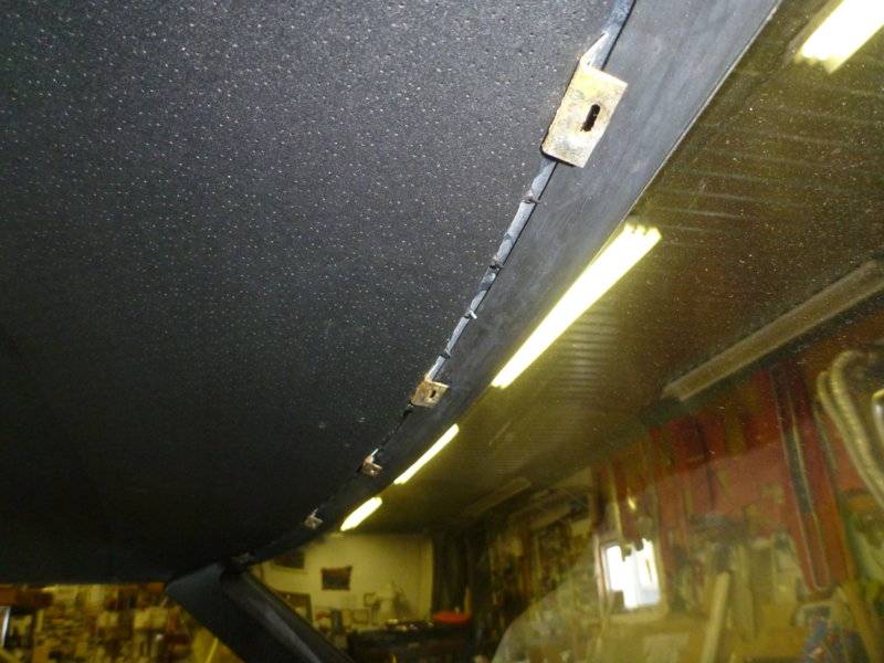

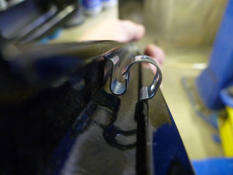

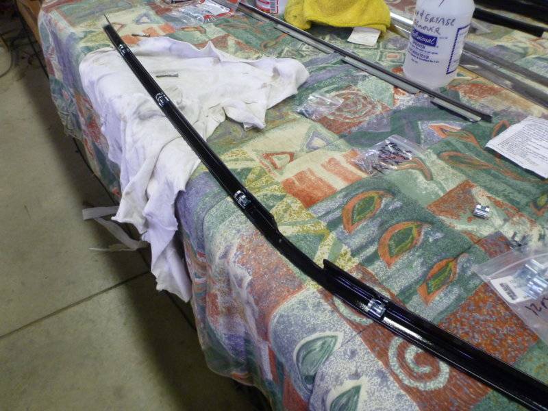

Headliner to roof rail trim uses 6 of these clips and one screw.
Clips slide it place like so. This is the the drivers side, picture taken from the front looking rearward.
3 on the front door section and three on the rear seat area. I used a bit of butyl to hold them in place so they didn't slide off while installing.
Screw goes about 4" from the front end, into the roof rails screw slot. Rubber hammer used to knock the trim clips tight onto the headliner mounting edge.

What are the roof rail clips called?
I searched several parts sources for "barrel clips" but didnt have any luck
